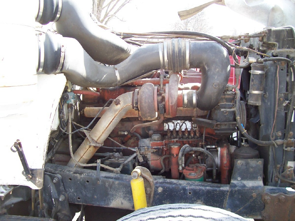

I see most R models with battery start have dual battery boxes behind the steer axle. So my question is where are the fuel filters in the pics below located?
Any pics of where your ones are would be a great help, as I want to put a battery box there.
https://www.bigmacktrucks.com/topic/37829-fuel-filter-location/
Pretty posiitive my R's filters were passenger side, just in front of the dipstick tube about a foot, inside frame rail. You could see the top of them but we changed them from underneath. Now if you had a V8 in there I don't think they'd fit.

I have electric start on e6 in model 1986 model
Standard mack battery box on left side ( Australian. Truck ) with 2 batteries and never ever had an issue with starting
Then fuel filters both primary and secondary are mounted in position on driver side just below cabin and in front of fuel tank as per your pic
Just my thoughts any way
https://www.bigmacktrucks.com/topic/37829-fuel-filter-location/#findComment-268139
Here is mine when I first bought it, I have since moved it about two inches over and down to make room for a new hand primer as my truck did not have one from factory and the old tac drive fuel pump leaked.
