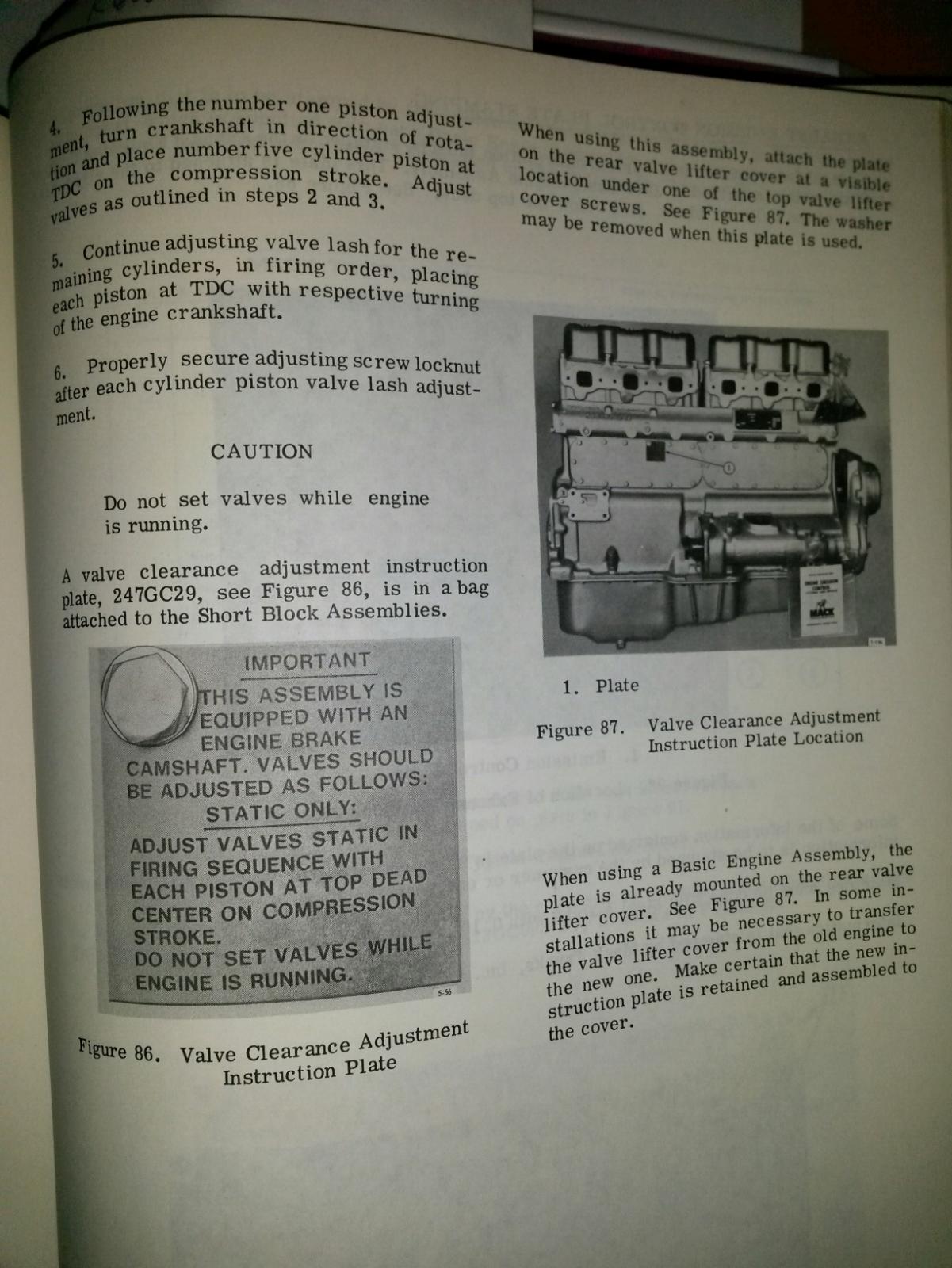

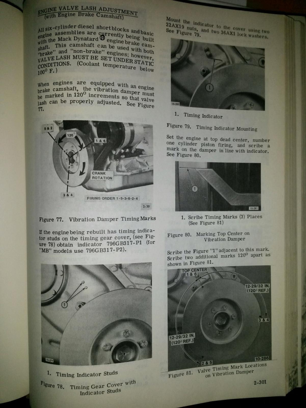

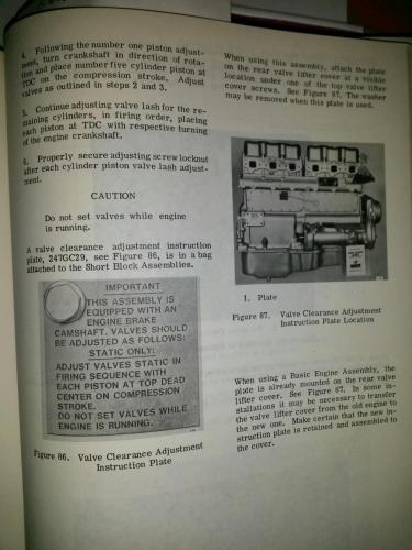

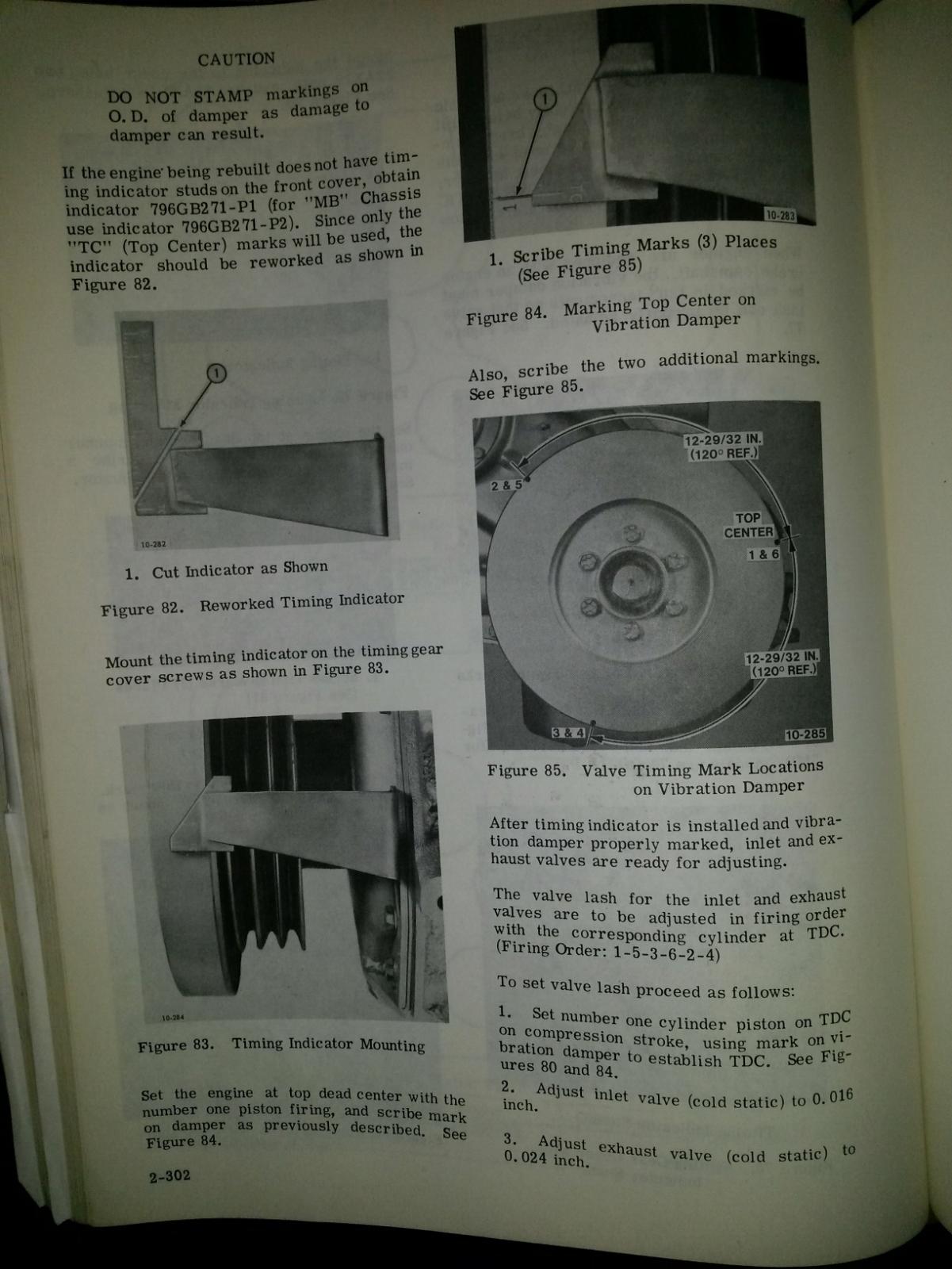

Not sure what book you are using but this is from the Mack Service Manual
If you read it will show you where the pointer should be and where to put one and how to mark the balancer.
post-10018-0-19329200-1417836839_thumb.j
post-10018-0-52572900-1417836855_thumb.j
post-10018-0-64784600-1417836864_thumb.j
