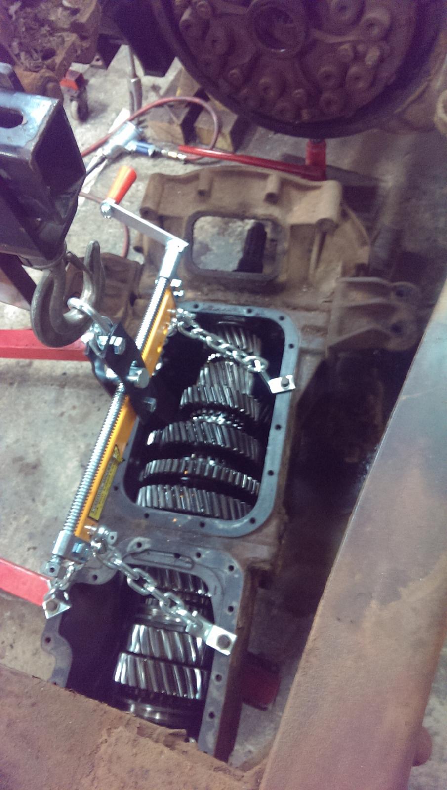

The tranny box brake down seems repairable. Welding, soldering, brass soldering or just epoxy but well pre-cleaned and degreased.
The generator mounting area doesn't look nice. Maybe to drill through and put studs instead of bolts?
that's what a friend of mine suggested about the generator mount holes , try to salvage what I can of the threads and soder studs in. If I come across a better engine for a good price will will get rid of this old 711.

yup, agree looks like a water push out. good welding shop can weld that right up with cast iron rod. I have seen a few Mack trans broke in this same spot actually. mine has about 15 pounds of brass on it. I ended up changing out the front case with a spare. glad to see you moving along on this gem and decided not to sell it.
I agree!!!
Best way to repair cast iron is to weld it with cast iron. (Best way)
Stich and pin using lock and stich. (2nd best)
A good v out and braze job. (3rd best)
Nickel welding rods work but there's a 50/50 chance it will crack again then there really no way of fixing it after that it ruins the metal.
And using a mig welder is a JOKE....
My dad and I are going to drill and stich it for Rudy.

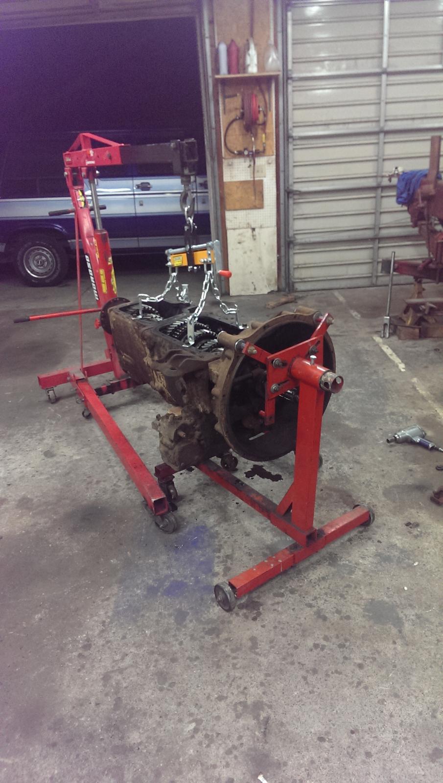

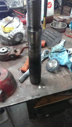

Well I haven't made too much progress on my truck but I'm back on the project. I got the drive shaft out and the trans out last night. I was working on the front axle back in the winter and discovered I need king pins and a deal fell through for a set of 22 in hubs.

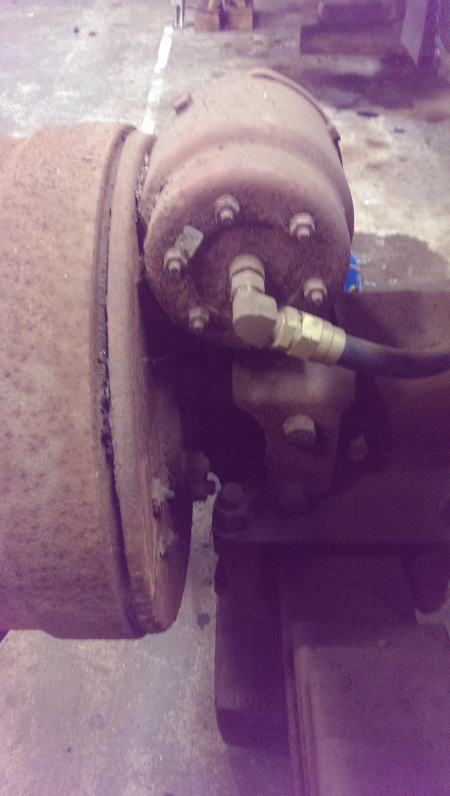

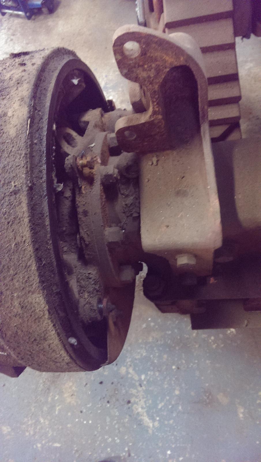

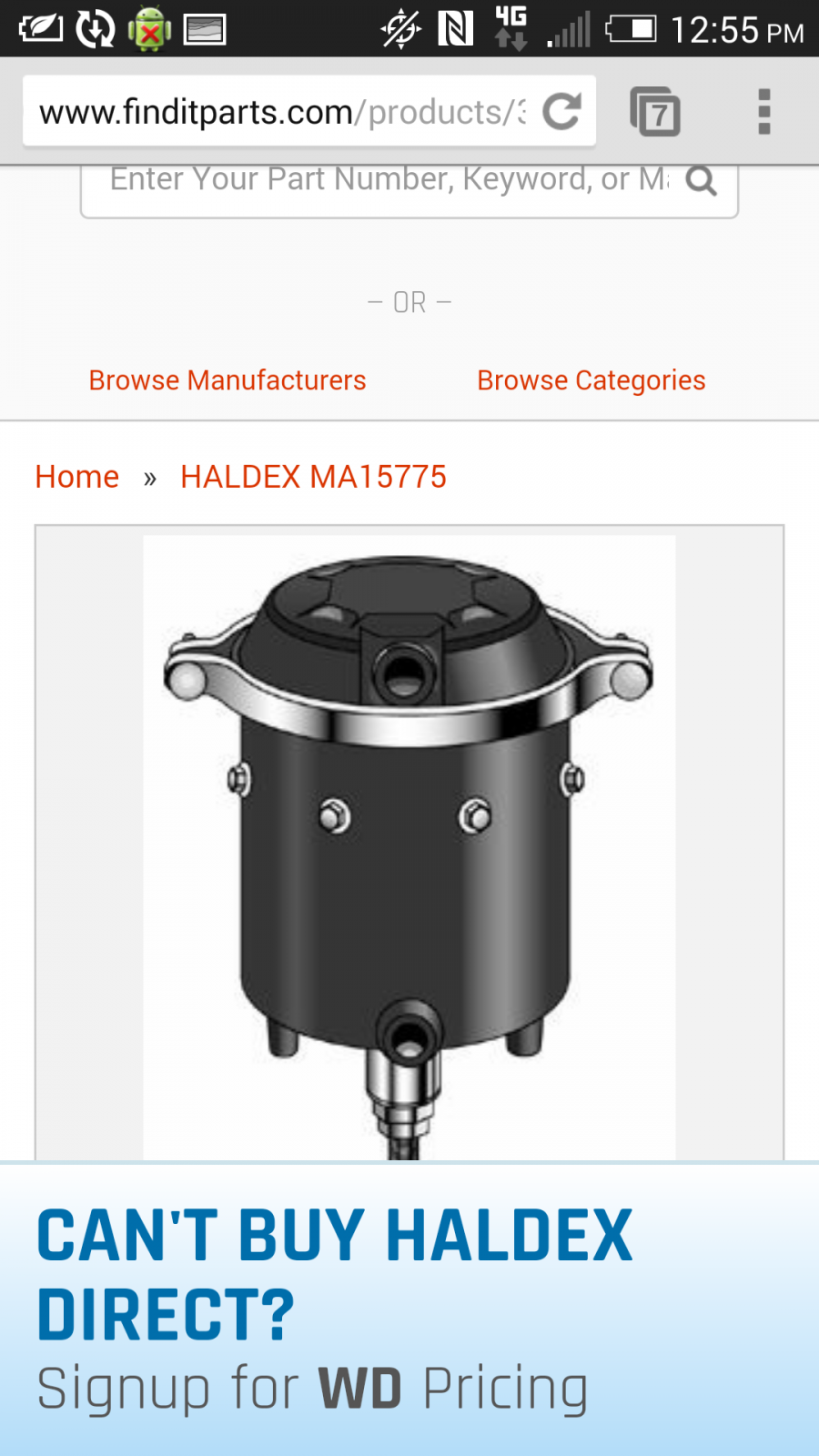

I am also trying to figure out what to do with the rear breaks, I would like to put modern cans on the truck and the smallest one's I can find are 24/24 chambers but there a little to big in diameter.

I have the same question on rear brakes but I assume if I go to the Mack dealer they can help me out. The ones on mine now are cobbled up DOT magnets...Welded yokes to the can rod...They need an offset slack adjuster or some such thing. If you figure it out let me know and I'll be sure to do the same...good luck
I also own a b81 that I'm trying to install newer brake chambers on. Looking for a better solution to replace the old service cans

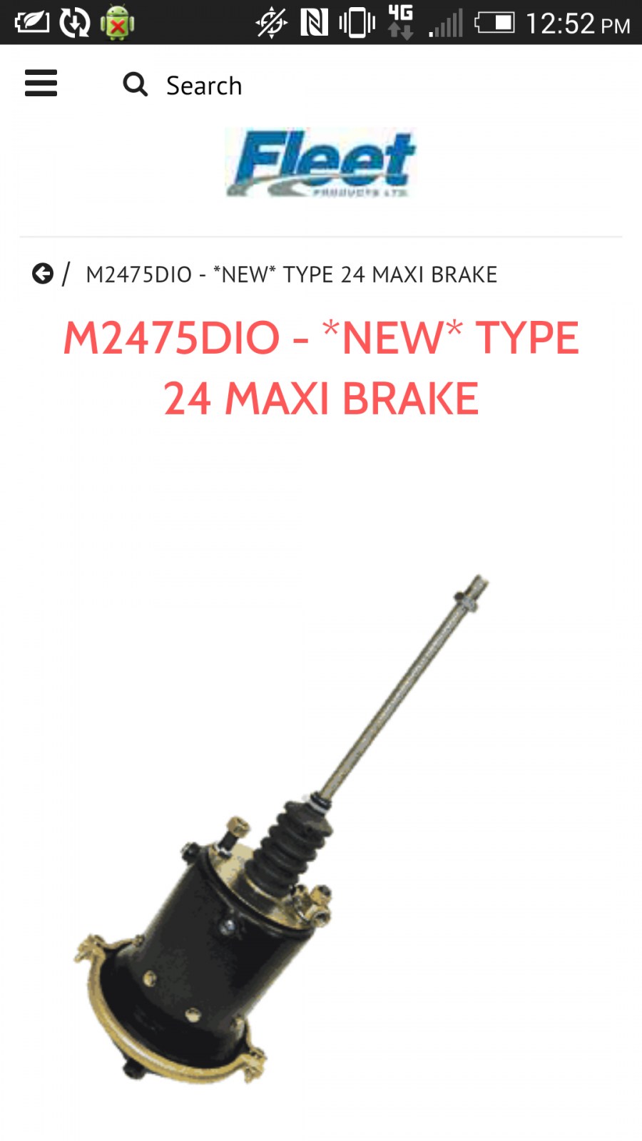

here is what I found today. Maxi chambers I have to find out the diameter yet though. I'm guessing these will give enough brake power and then a parking brake as well.
