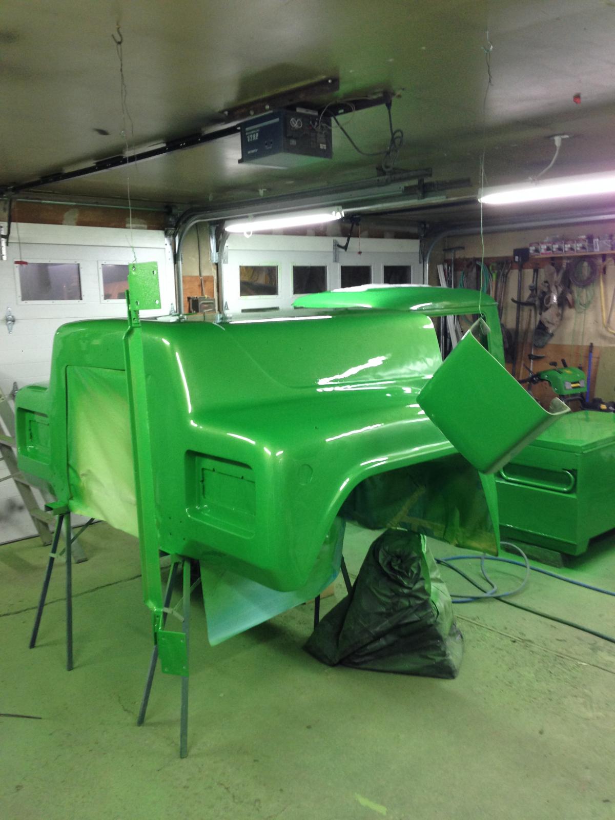

Looking good. I'm kinda a round headlight kinda person myself, but nothing against the work you're doing.

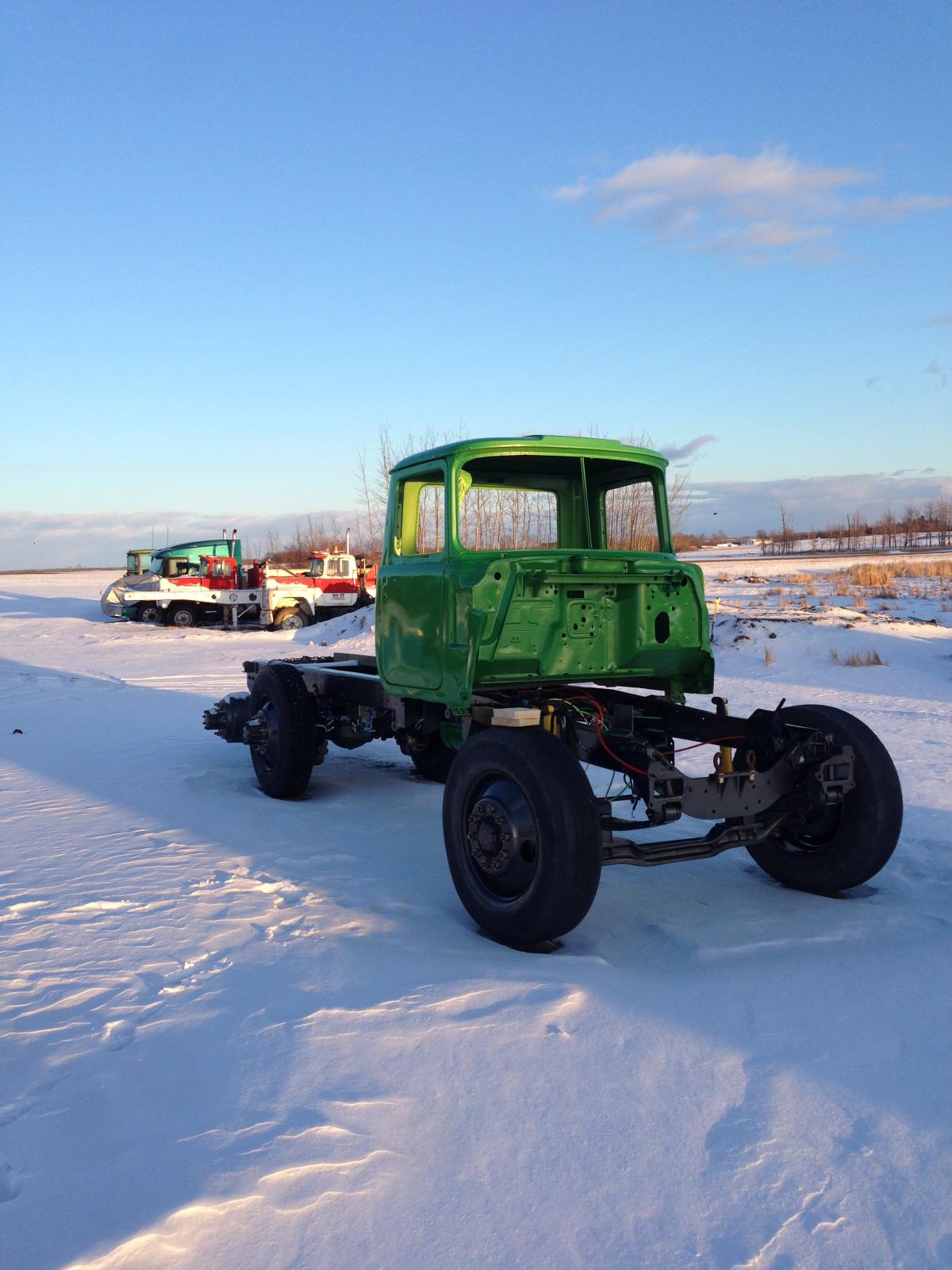

Now that I see the 2 trucks together I also like the round lights but... that the ones I’m putting in are a bit different we will see
