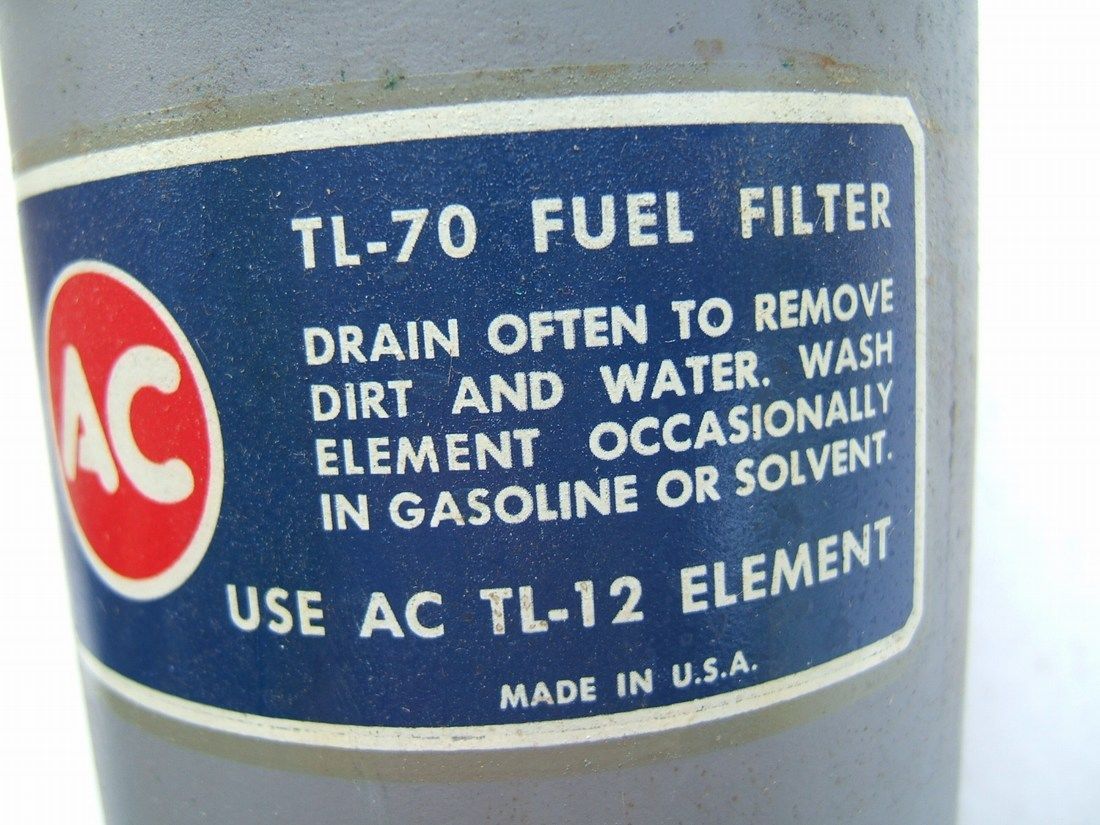

Your best bet will be to check the base for a PN. My guess is you will have to replace the entire filter with something you can find replacements for. The good news is it is not a stock filter, so you aren't losing anything significant.
You could use something like this inline Wix filter as an example. Fairly inexpensive and easy to change.
http://www.finditparts.com/products/2523858/wix-filters-33270?srcid=CHL01SCL010-Npla-Dmdt-Gusa-Svbr-Mmuu-K2523858&gclid=CPPO86jXkcMCFZCIaQodgb4AVg
Jim
Some older 707 Filter (Mack part numbered) do cross over to Wix and Baldwin numbers. If you can determine a Mack number by measuring all the dimensions you may find a replacement. However as was suggested perhaps a new in-line may be easier,
It looks like my Diesel Gen set filter AC-TL70 assembly with an AC TL12 cartridge with a glass bowl instead of the metal bowl mine has. If it is a bronze filter unit it is washable.
