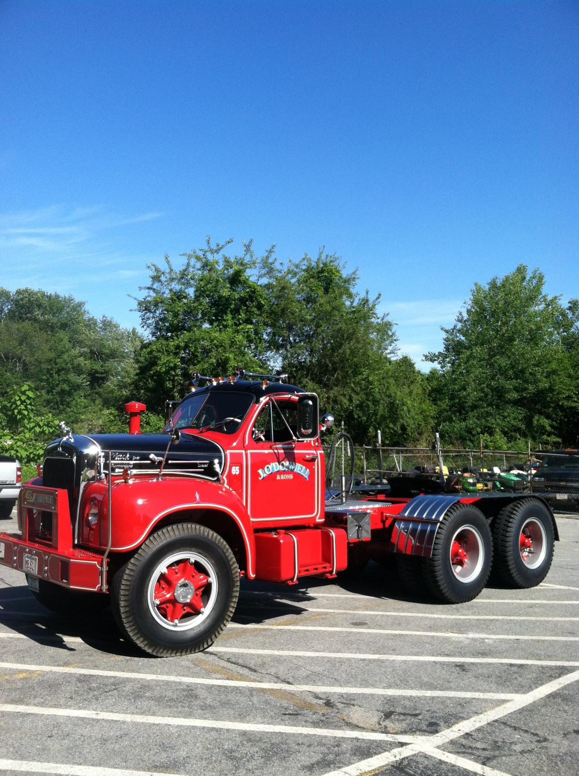

I don't feel Bigdogtrucker that I was INSANE to pay that, the prices I got at body shops that do trucks and that included Coastal in NH that was in line with others and I was really insane then to spend $20,000 on the B-model, You get what you pay for. R686st that price you got I would grab for all that work and they have a good reputation I would do it, also both our trucks where painted in single stage PPG Mack Red
