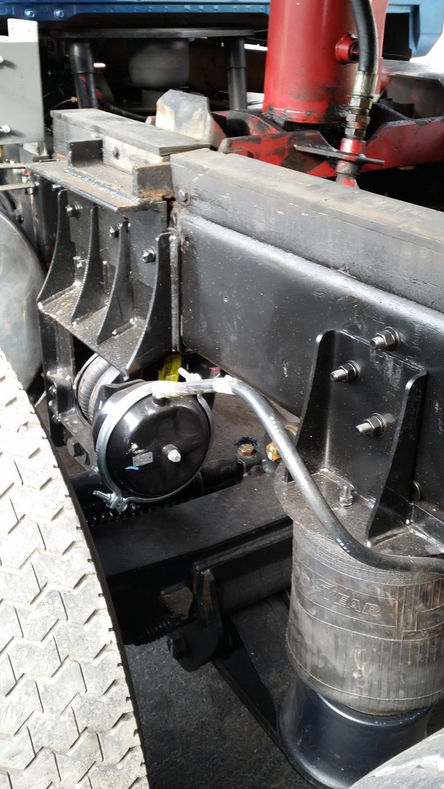

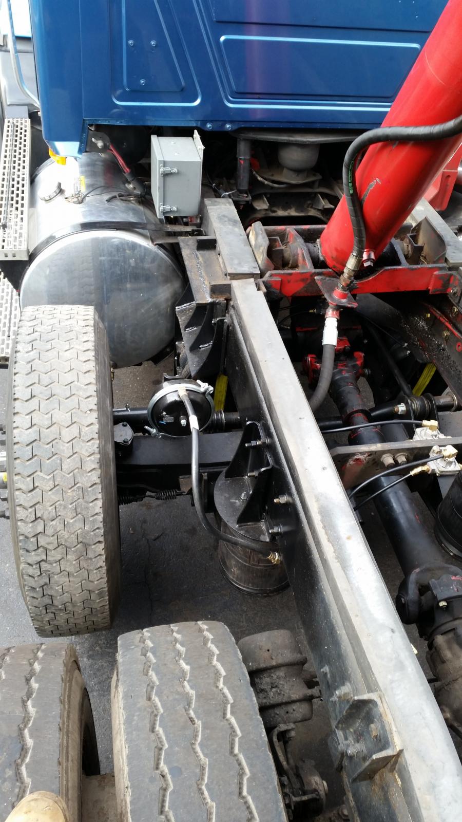

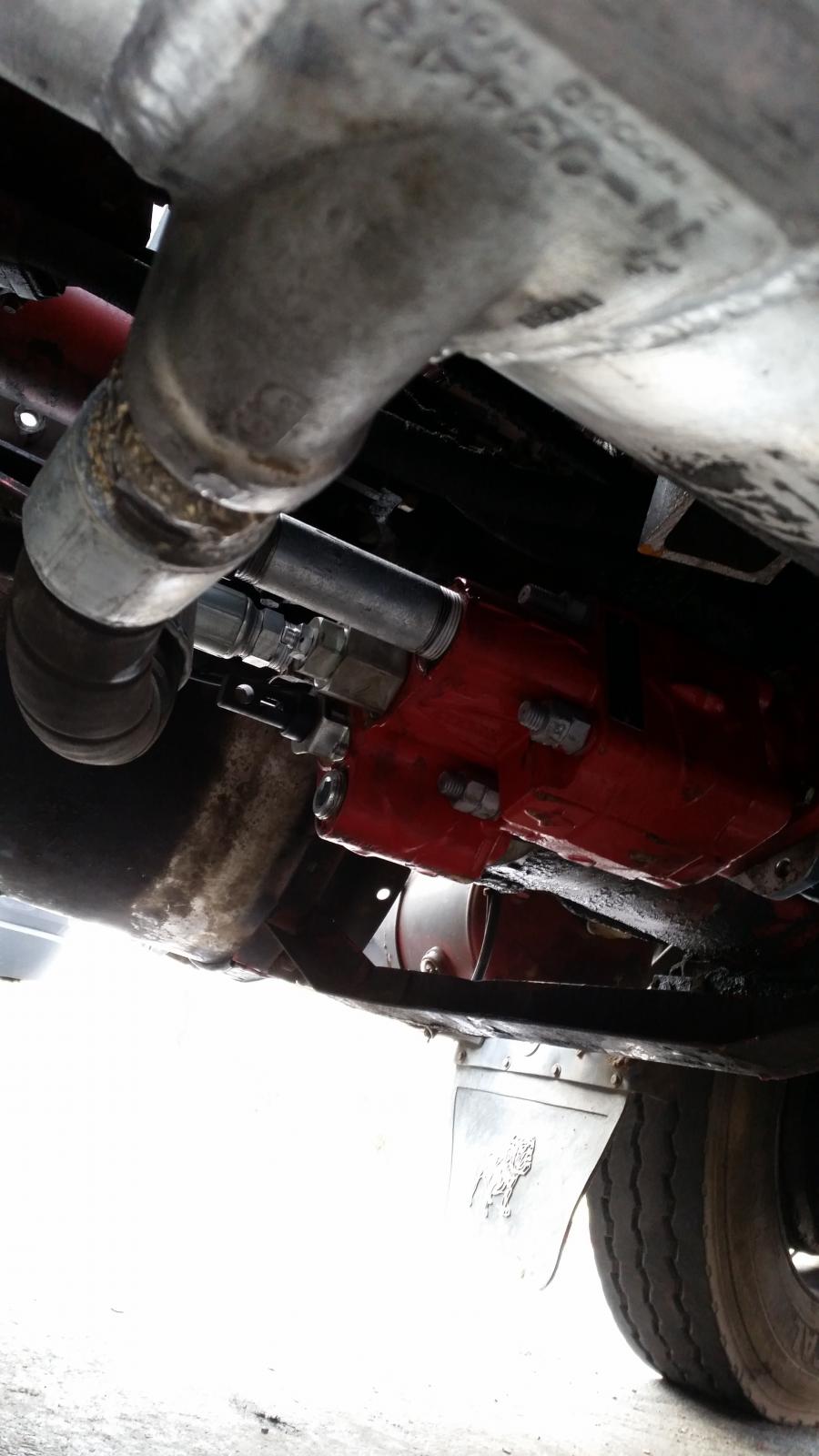

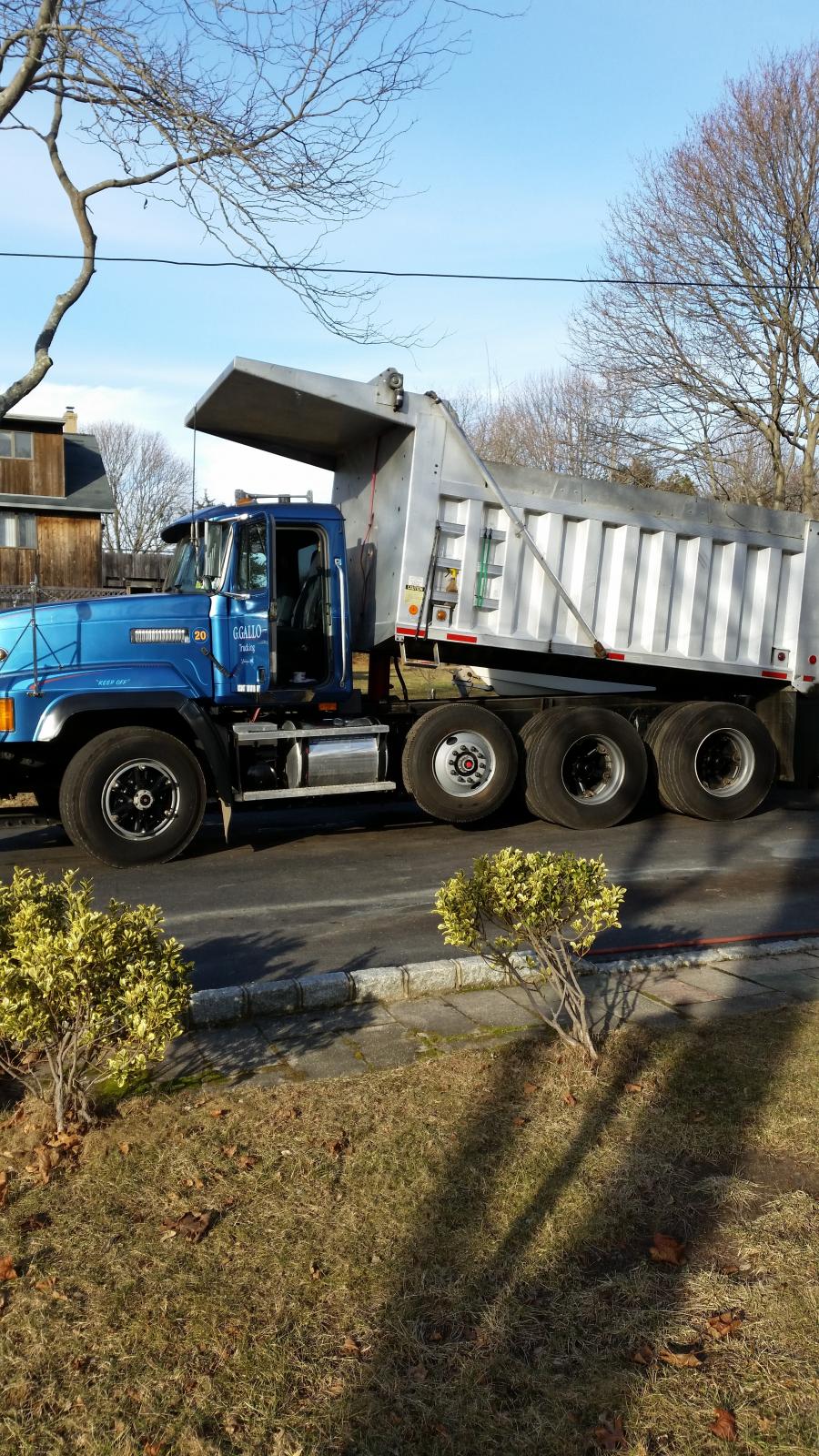

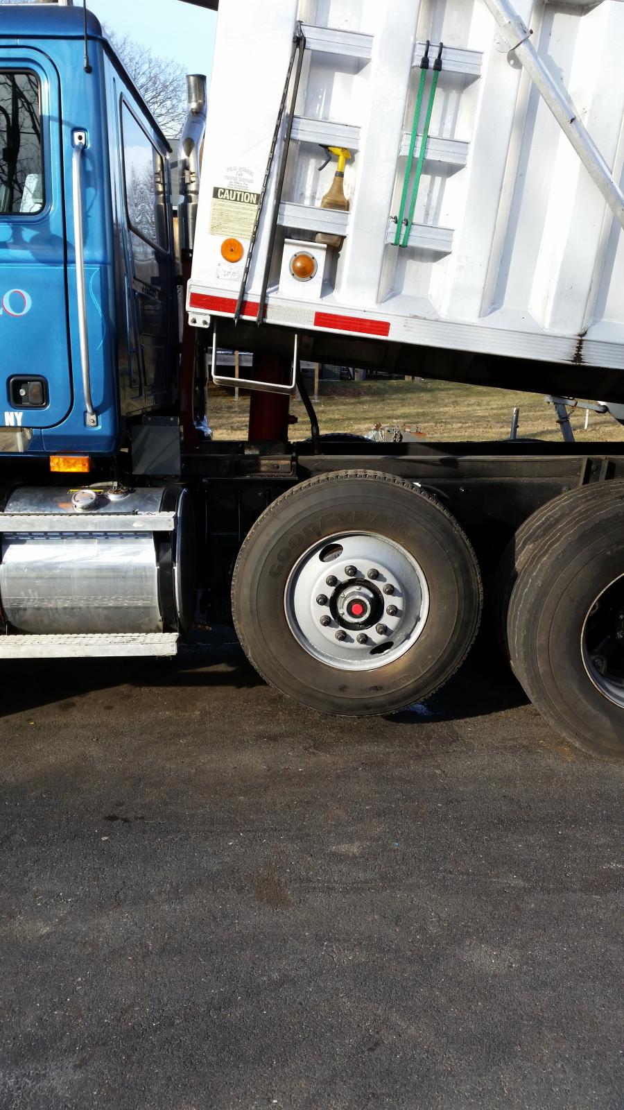

Now thanks to the nys dot I had to add a 20,000 lb steerable drop axle to compelment the 58,000 rears and the 20,000 front axle, the good news is now I can gross 79,000 lbs,the bad news is it cost me a whole bunch of money that sure could have used on something else.I had to give up the passenger fuel tank for a hyd tank and switch my rear mounted pto which i loved to a pain in the ass side mount pto pump combo that was quite picey,still have to get the right rims and tires,more money!post-598-0-69435600-1422632503_thumb.jpgpost-598-0-69435600-1422632503_thumb.jpg

Didn't NYDOT tell us it would be a minimal cash out lay to meet their new regs. . .
Cha ching. Looks good though.
Loosing that pass. tank, likely cut your fill up distance in half! One 40 gal tank won't get you far.
Its a 70 gallon tank,still have to fuel up every day but thats the way I been doing it,to much troube moveing the truck to the other side of the pump.
In okla we have to have ten feet between the steer axle and the first drop axle to be legal.How much can you gross with that now?
Once I renew my permit in a couple months I can gross 79000 but I wont be loading it that heavy.
Of course they did,lol but there not getting there hands on my grandfathered overweight permit and I know they want them!

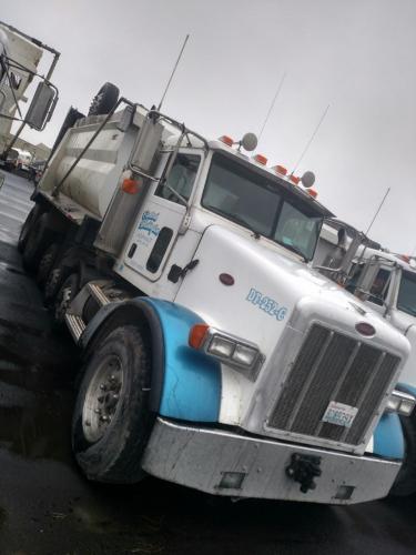

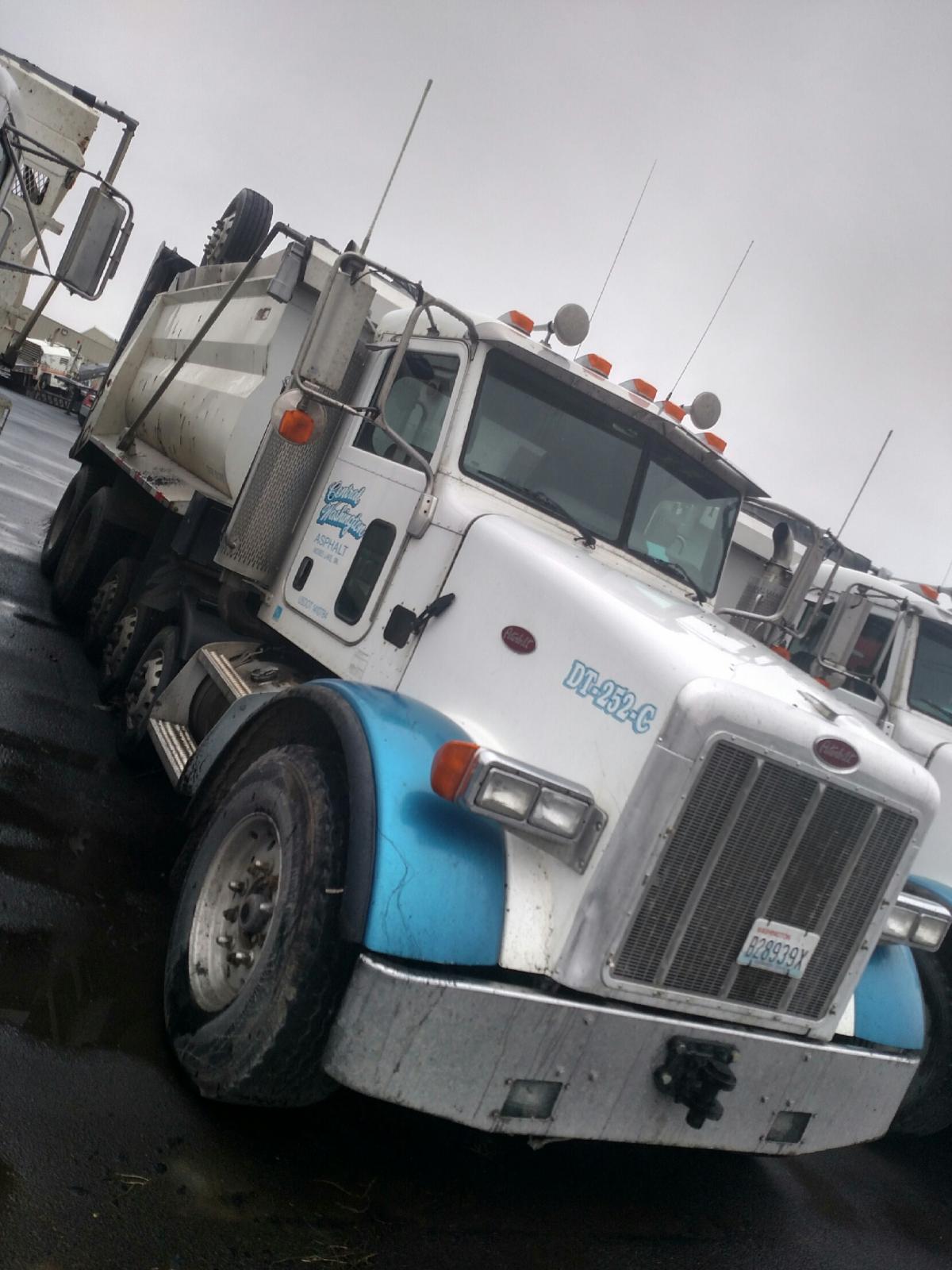

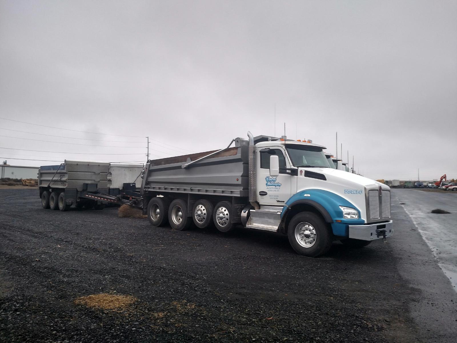

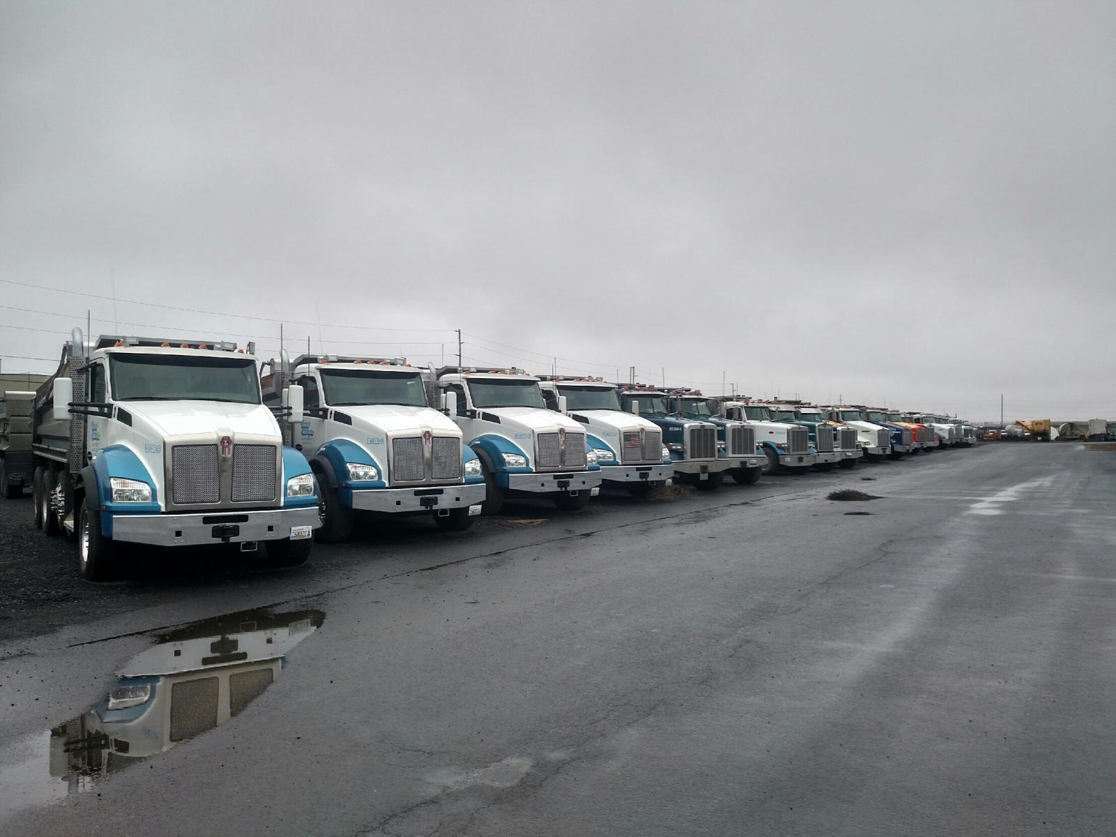

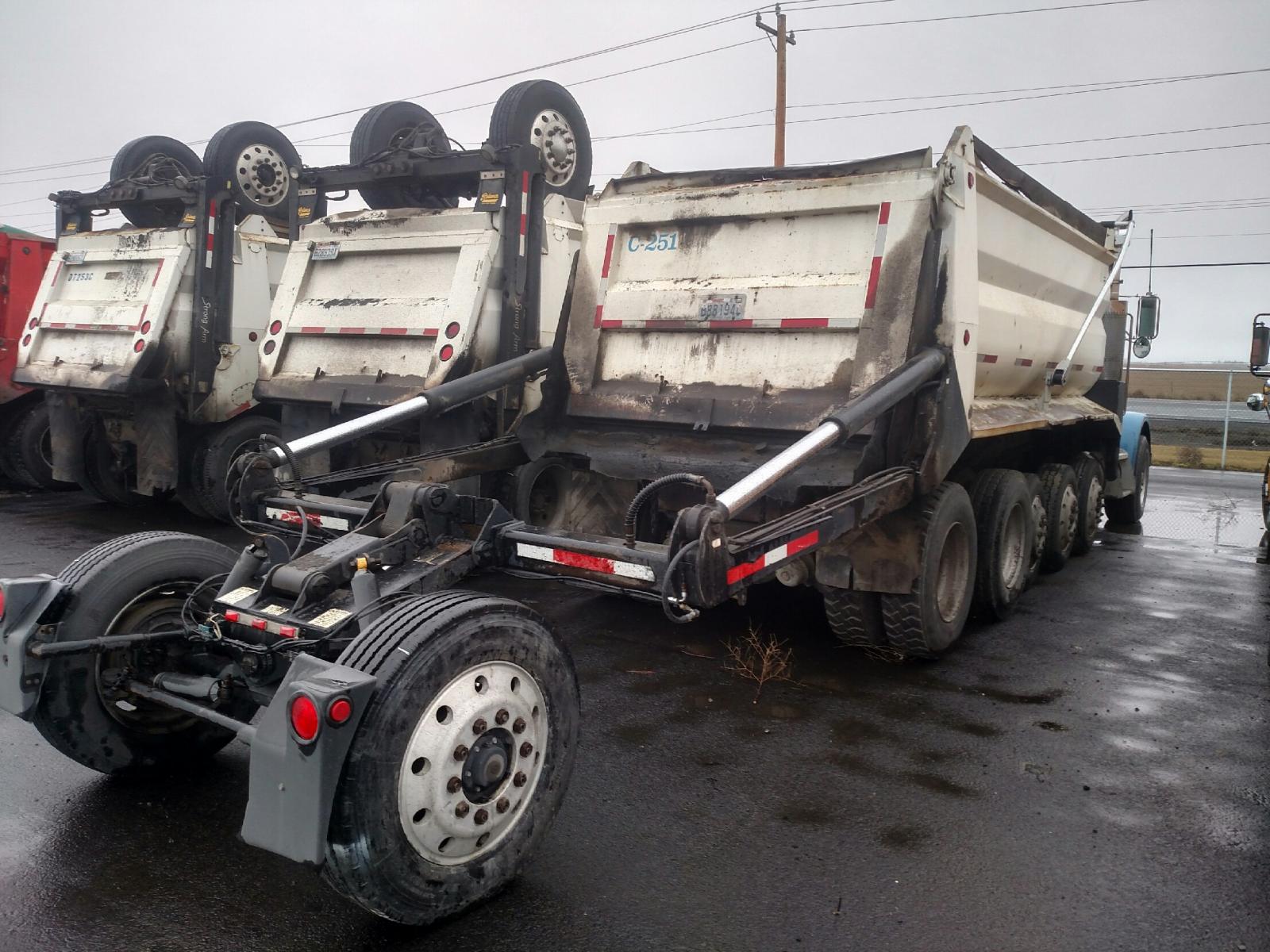

I stopped by were I used to work and took a few pics of some of the fleet the solo trucks we call super 18's able to haul 18 yards of 5/8 crushed the truck and pup can gross 105,500 I forgot to check tonnage for solo 5 axle work but should be able to haul 15 yards legal......cant tell its paccar country can ya!

Wow those bodys must be 30 yd water level and they can only carry 18,thats nuts but its almost the same around here with certian permits like with a state wide permit that most trucks have,they can only carry 18 tons on a triaxle with an 18 ft body,crazy

Hey MACKS, where did you find a steer tag that has the tie rod and stabilizers on the front, thought they were always on the back of the axle.
Ok, I've been looking at Hendrickson composilite lift axles, I like the way their tie rod and mounts are set up. I've never seen one with the steering stabilizers on the front, always on the back just looked odd. Good luck with the truck, I always wondered why you northeast guys had such short trucks anyway, seems you would fill the bed before you made gross and hauling by the ton would suck.
