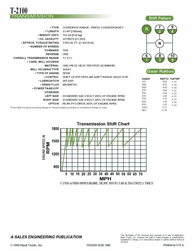

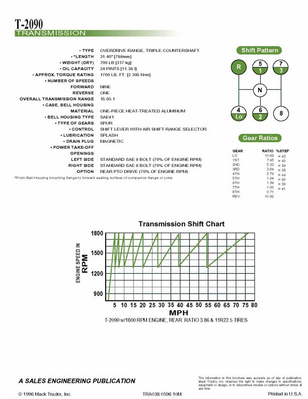

Don't count my answer as a perfect one since I have never put my hands on both of them.
But from what I have figured out from the description T2090 and T2100 seem to me as mostly the same units with one exception.
T2090 is really a 10 speed but 2 gears have about the same ratio. So Mack called it "9 speed".
T2100 has almost the same structure but with slightly different ratios, 5th and 6th speeds are different. So there are "real" 10 speeds with a bit shorter steps than T2090.
This means those boxes have the same synchro, bearings, housing and so on.
Anybody correct me if I'm wrong.

Vlad, thank you for this - the attachments have been really helpful.
I think you are right in that they are probably the same beast with different ratios.
