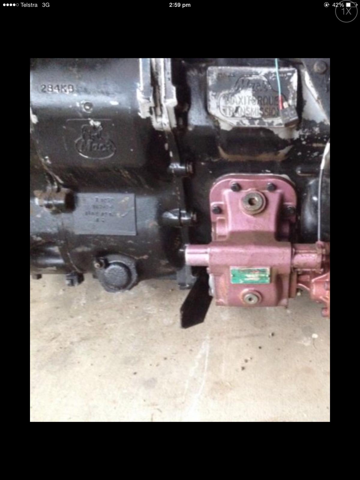

I found a 12 speed for sale on gumtree. In one of the pics I can see "284KB" on the side.attachicon.gifimage.jpg
My 84 model has the Trdl-1070 in it so I think you might be in luck with that one.
Thanks mate, seems there is hope that it is not a T2000 series. Not to say there is anything wrong with them - I have spoken to many people that really like them. It's just that my T2090 has given me grief so I have been put off by it and want to try another Maxitorque before giving up and going back to Eatons. Cheers

Go with the 12 spd, awesome transmission its got nearly perfect gearing for anything you can find. The one stick or trtxl 1070B is just an air shift deep reduction where the two stick trtxl 1070 has a shifter for deep reduction which will only shift with the main stick in low so its easy to drive. The trtxl 107 is the direct top gear version and Mike is right the 1070's are .78 OD, the air shifter on the main stick has reverse/neutral/low and high use low then split to high in each gear like an Eaton super ten. The big bonus is being able to shift thru all 5 gears in reverse, when you have a long way to go like on paving jobs you can clip along at 20mph and 1400rpm in reverse.
