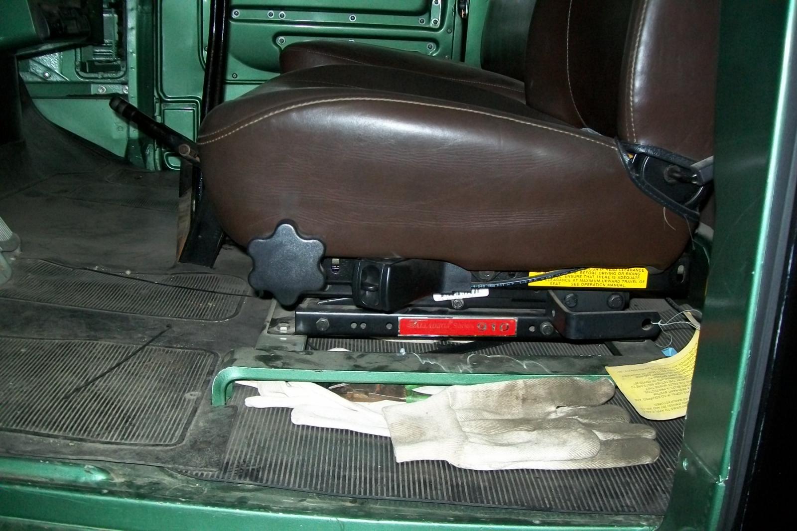

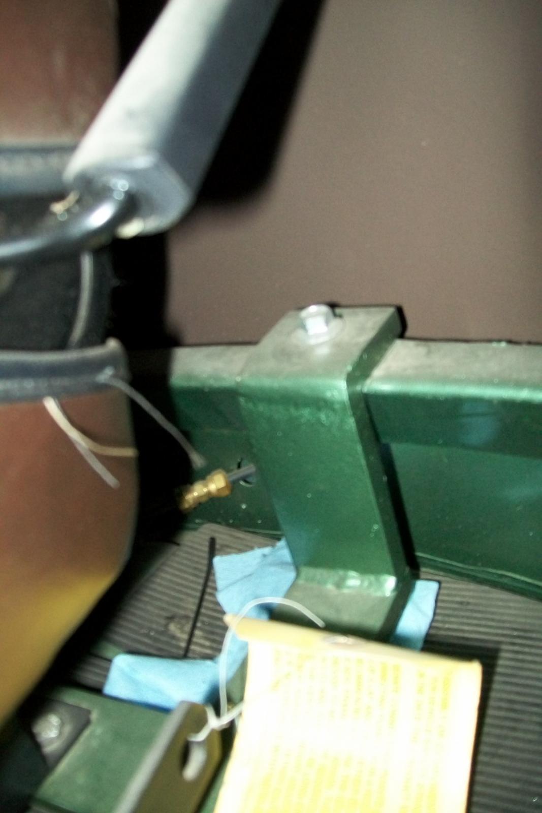

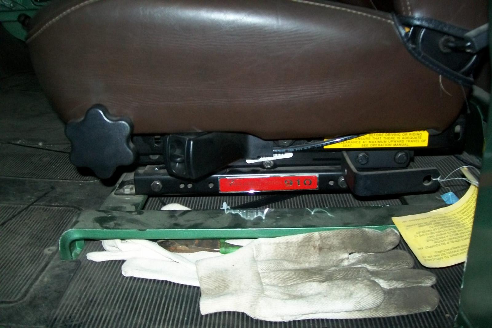

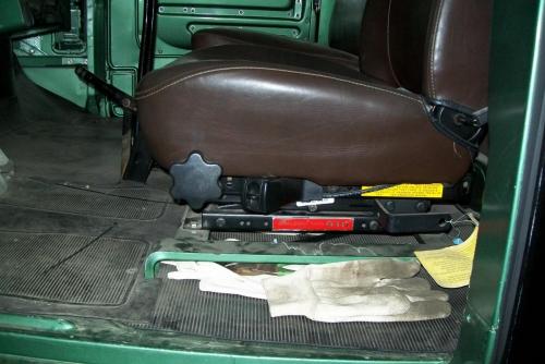

I know of 2 B's in my area with newer Bostroms in 'em,Matt. They both had to modify their original seat frames to get the right travel/height out of them. Big improvement. Neither used the bulldog upholstery, though.I will look at one of them either today or tomorrow and get some pics for you. Al

we put the seat Barry sells in my cousins green B model. I cut down the original seat frame lower to the floor and mounted it, I think its a mid back tho? and still doesn't give you much height. I saw a B at that show with a Bostrom with the bulldog embossed and I thought the seat fit a little better but cant remember the model.
