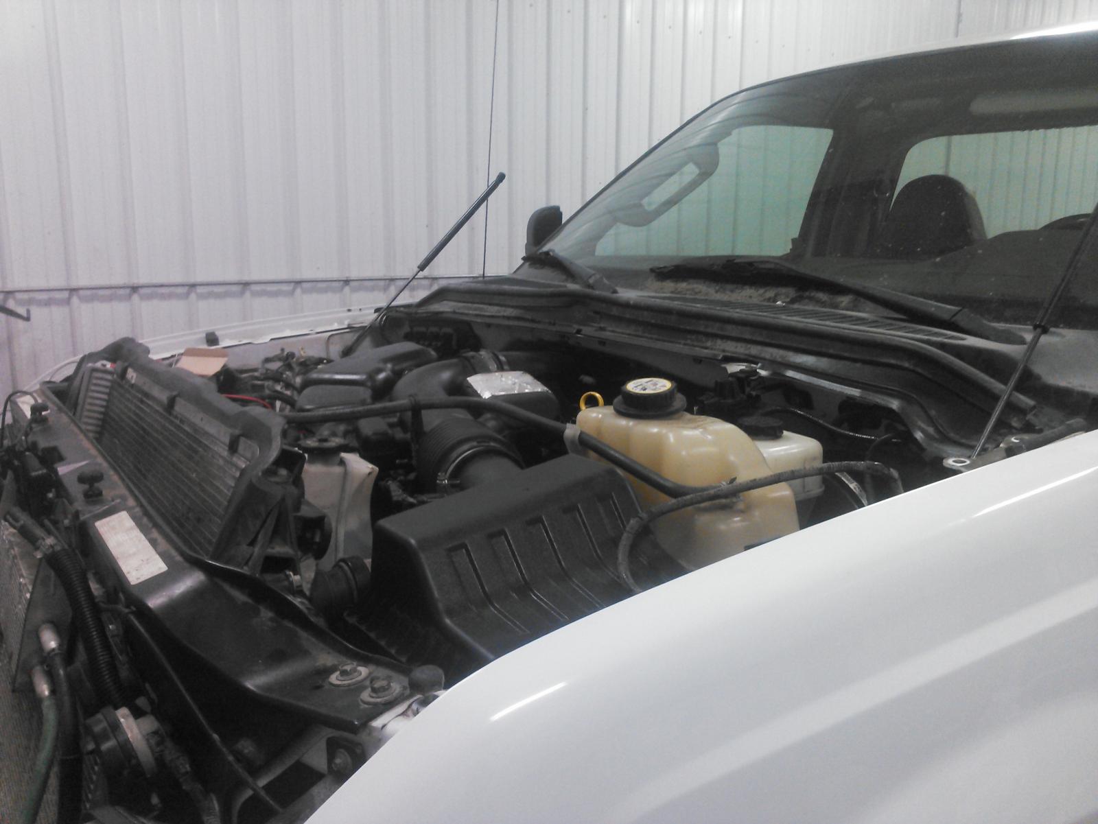

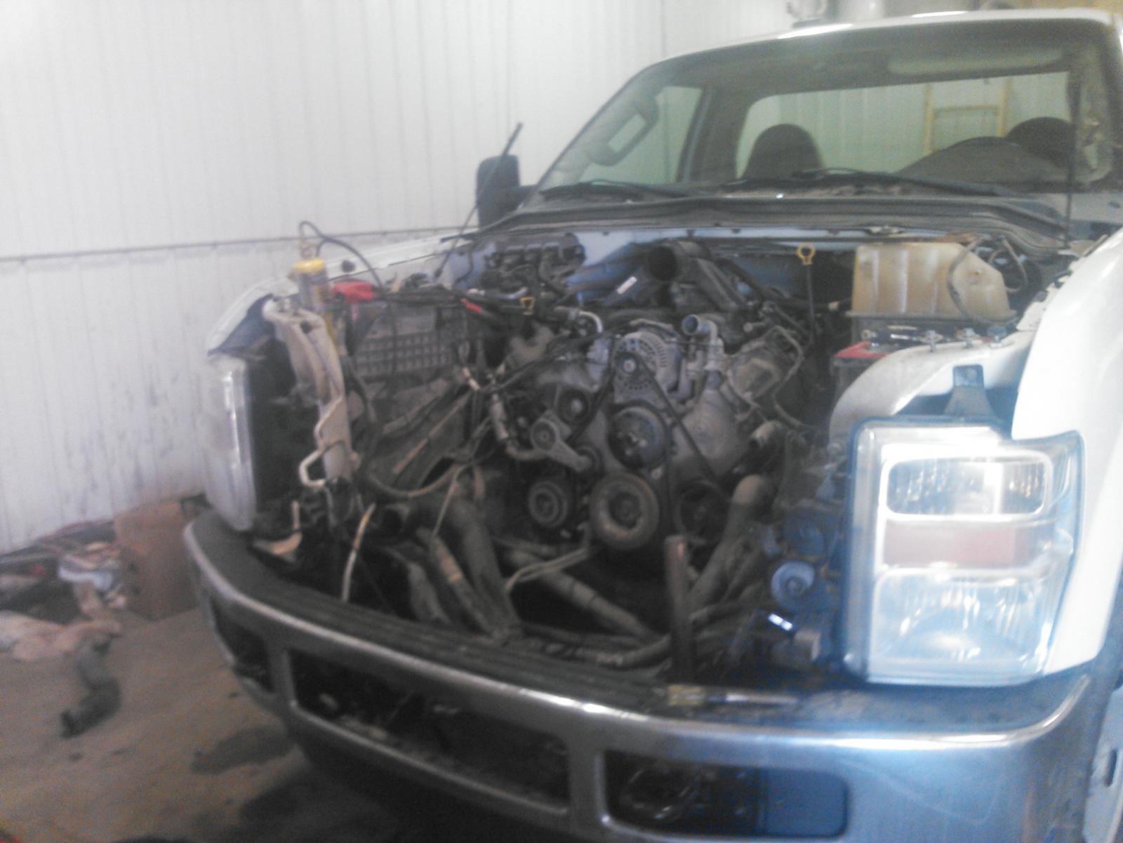

I don't know if anyone knows what the book time would be or have a general idea but I am putting a engine in a 2007 ford f-250 superduty 5.4L gasser. I have not quoted a price they just asked if i had time to get it done or not and at the moment i do so they had it taken over to my shop i started on it today. newest ford i have done before was a early 2000's this one seems like there is a lot more that has to come off to get out of the way than normal. most pickups I have done in the past i would have had the engine out and laying on the shop floor by now. so far all i have gotten done on this one is just getting everything out of the way. still have to separate the trans from the motor, motor mounts and drop the ac compressor and exhaust off the motor before its ready to lift out.
being that i havent done one quite this new before im not sure how much i should charge for it. something like a late 90's chevy 350 i would probably charge somewhere between 12-15 hours pretty sure i will have a fair bit more time into this one considering iv got about 6.5 in it so far but don't want to over charge due to having to take some time to figure a few things out ect. but don't want to undercharge and cut myself short either.
so i guess in short if anyone knows what the book time on this job would be or about how long should be charged for it that would be helpful

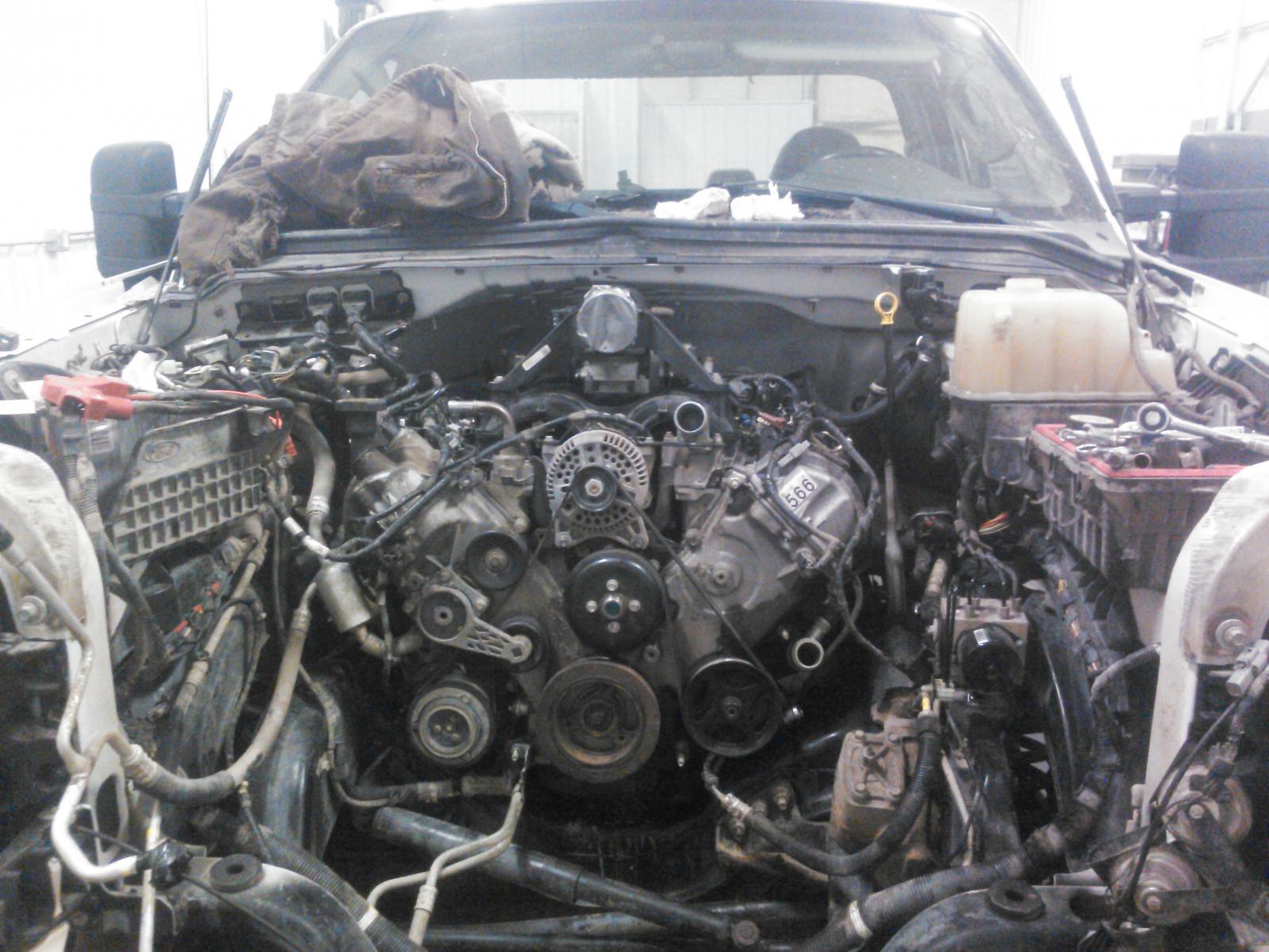

a few pics to show just how much shit has to come out before you can pull the motor.

Did it to my brother in law 2006 f 150 5.4 triton. I'm not a Ford tech took 3 week ends. Torque converter bolts suck. They want you to get pullers for the power steering pully but I just worked the bolt out on turn at a time and same for the air condition pump. Think I had to drop the front axle a little. Be carefull with the vacum lines for the front hubs if it's a 4 wheel drive. Good luck.post-2708-0-93208500-1423187969.jpg

cab would definitely have to come off to remove the head with the engine still in the truck. i would have passed on this job all together if it would have been a 6.4. however after pulling the intake manifold it looks like the engine should come out. the engine being set so far back really makes it a pia. its almost like working on a van without a removable dog house.
without a lift removing the cab would be a job in itself.

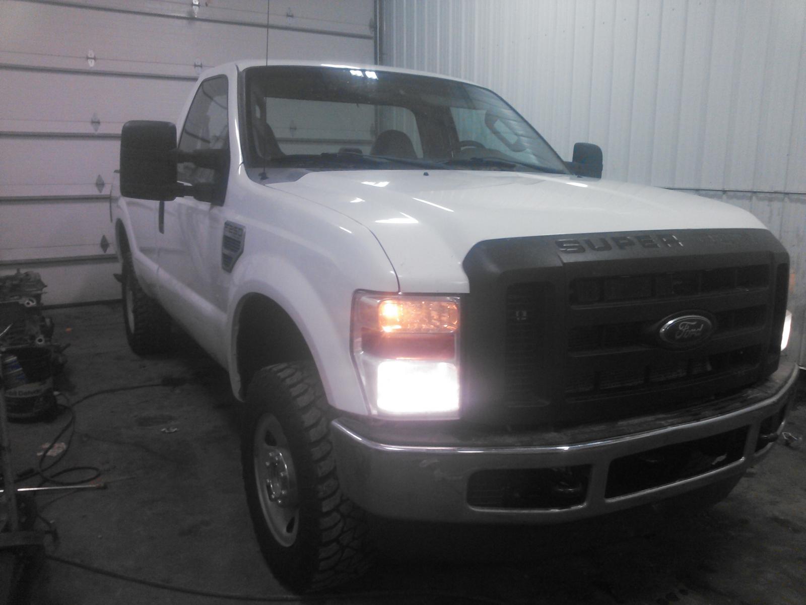

this one is the f250 superduty yours appears to be the light duty 250 witch is based off the f-150 chassis. the power stearing pump is already off on this one, someone changed the ps pump at some point becouse one of the bolts was buggerd up and another was missing. but it didn't come off too bad no need to take the pulley off just un bolt it from the motor and tie it back out of the way.
Yes his had independent front suspension. Yours has a solid axle. Yes I just laid the a/c and power steering aside. electrically it was plug and play. And I got all the bell bolts with the cab still on the frame. Not easy but I did it.
a friend of mine did a 1/2 ton 2x4 a couple of weeks ago said something about removing the dip stick tube and sliding the motor mount out to get it come out with out hanging up, I didn't see it until he had the eng. swapped so I didn't pay too much attention to his bitching. he got the job for 1k said never again, the other shop wanted 1.2k to do the swap.

I can check time with a friend up mine that has done several SD Fords for customers and the quick way is to take the cab off the truck. So much of the newer design puts the engine under the cab, it is tough to pull.
Depending on gas or diesel and which cab design, he can R and R a SD engine in 13-16 hours.
thanks
i suppose i will probably have to cap my labor at about 16 hours then, ill surly go over that but its kinda expected to take a little longer than it should the first time you do a different model.
i only spent about 2 hours on it today parts for a axle on a bucket truck i was working came in today so i had to get that slapped back together. and then the replacement motor for this truck showed up so i had to go get it and take it too my shop and some other running around ate up a lot of today.
the motor is just about ready to lift out on the super-duty now. probably a hour or less once i get back to it and the motor will be ready to lift out. got about 8-8.5 in it so far.

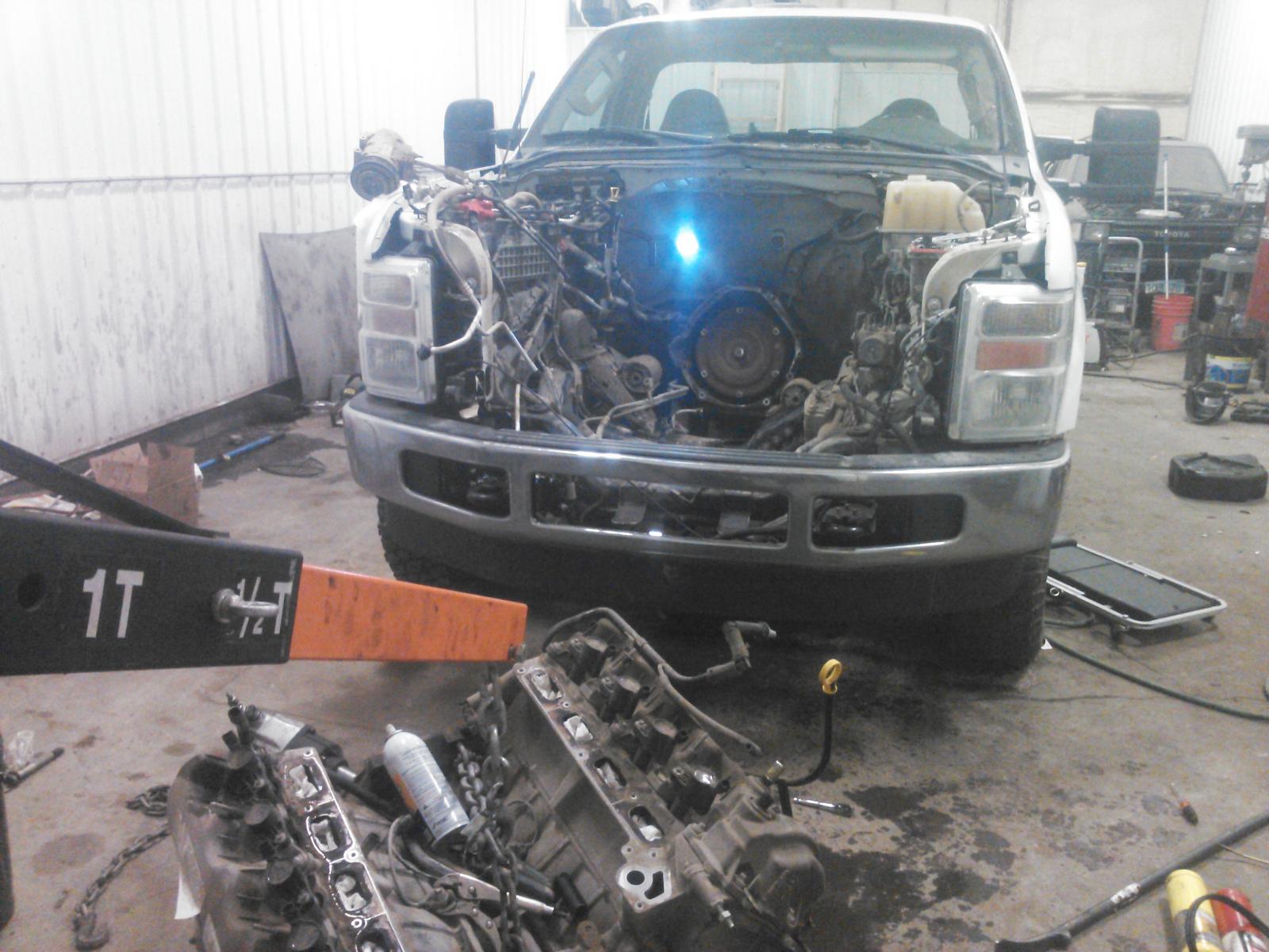

small win today
got the engine out after i did that preasure washed down the engine bay and did a general shop clean up ill let it dry off over night maybe over the weekend and then start prepping the new engine to go in.

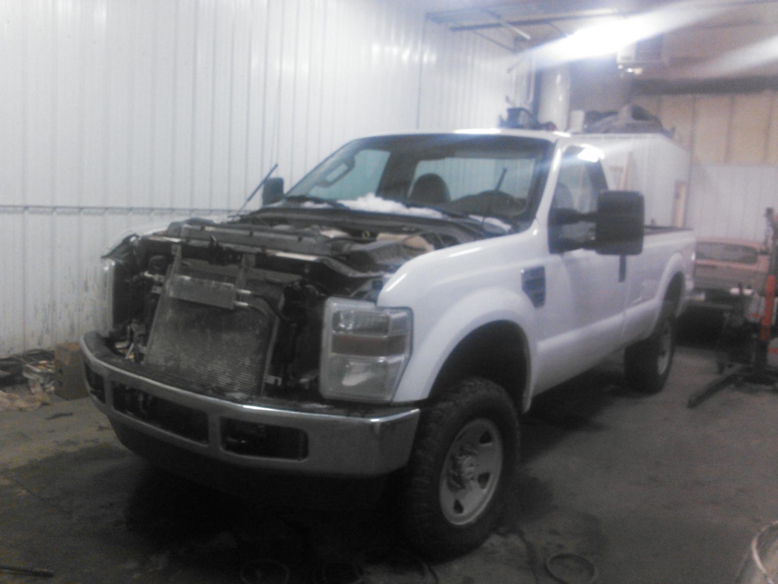

well things went fairly smooth on it today. pulled the intake off the new motor and got it ready to go in then it dropped right in place. only little hickup today was the dip stick tube on the replacement engine was mangled and kinked. so i pulled the dipstick tube off the old engine and then when i went to take the dipstick tube off the new engine it broke off at the block. glad i decided to do that with the engine out of the car rather than wait till i had it in. other than that everything went together pretty good. all the accessory are back on motor is bolted to the trans less torque converter bolts. starters back in still have the exhaust fuel rail and torque converter bolts left then putting the body radiators ect back together at about 14 hours of time put into it so far. i think i can see 16 hours being quite doable after you have done a few of them.

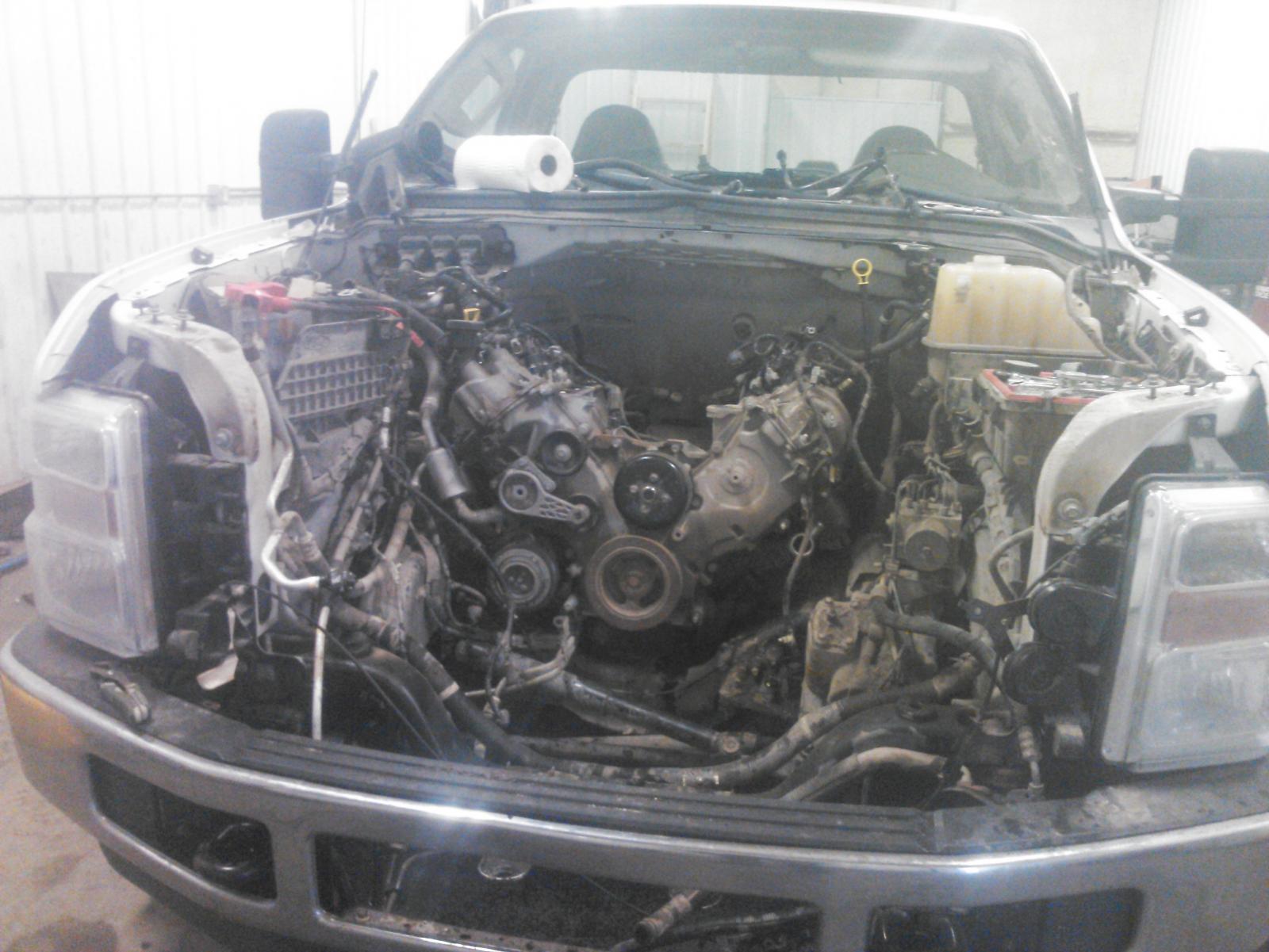

18 hours in. ready to fire less fluids. picked up a new oil filter and fluids on my way home should be firing it up not long after i get back at it tomorrow. then assuming all that goes good a little bit of buttoning up some little odds and ends recharging the a/c and it will be done.

well maybe the last chapter in this one. fired right up first thing this morning lit off with no installation issues no check engine lights no leaks finished the last few little things. runs good drives good. but the engine they supplied me to put in has a little cam phaser noise. then they bached at my bill even though i gave them a pretty hefty discount off the actual amount of time that i put into it. they thought a engine swap should be $500 umm maybe for a car made in the 80's. ended up dropping a extra 100 off the bill. they supplied the engine so if the engine has a problem its not my problem. i called them about the noise (witch really isn't too bad) as soon as i fired the engine up for the first time had them come over and listen too it and they said to just Finnish putting everything together. told them if they want to put cam phasers in it to bring it back and id give them a break on the labor to do them. all in all they seem happy and said they would drive it for a while and decide if they want to do cam phasers or not. makes me look forward to getting back to making money with the truck in the spring. next project is already pulled in a single axle medium duty dump truck that im sure to do some head scratching on i might post up another thread on that one luckally that one there in no hurry for
