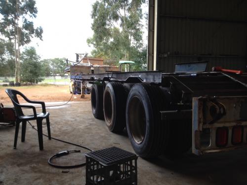

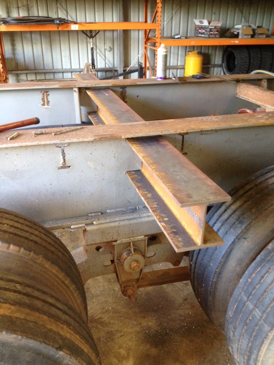

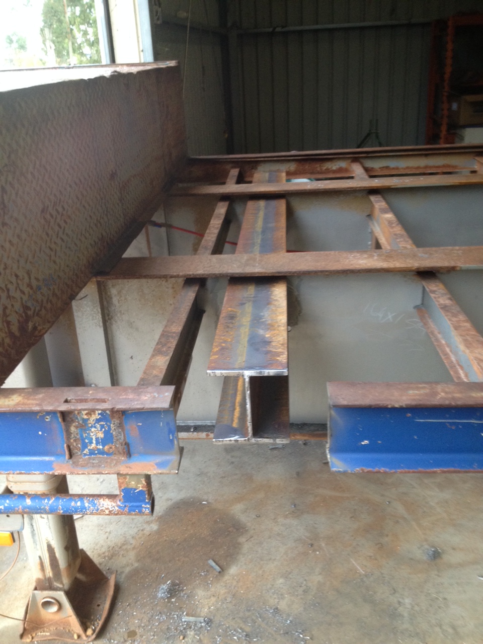

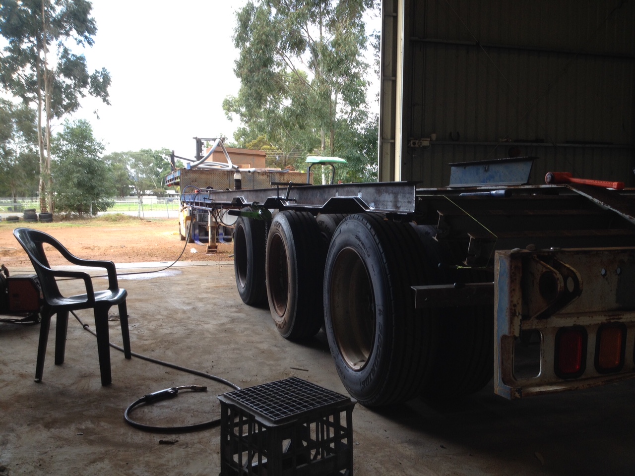

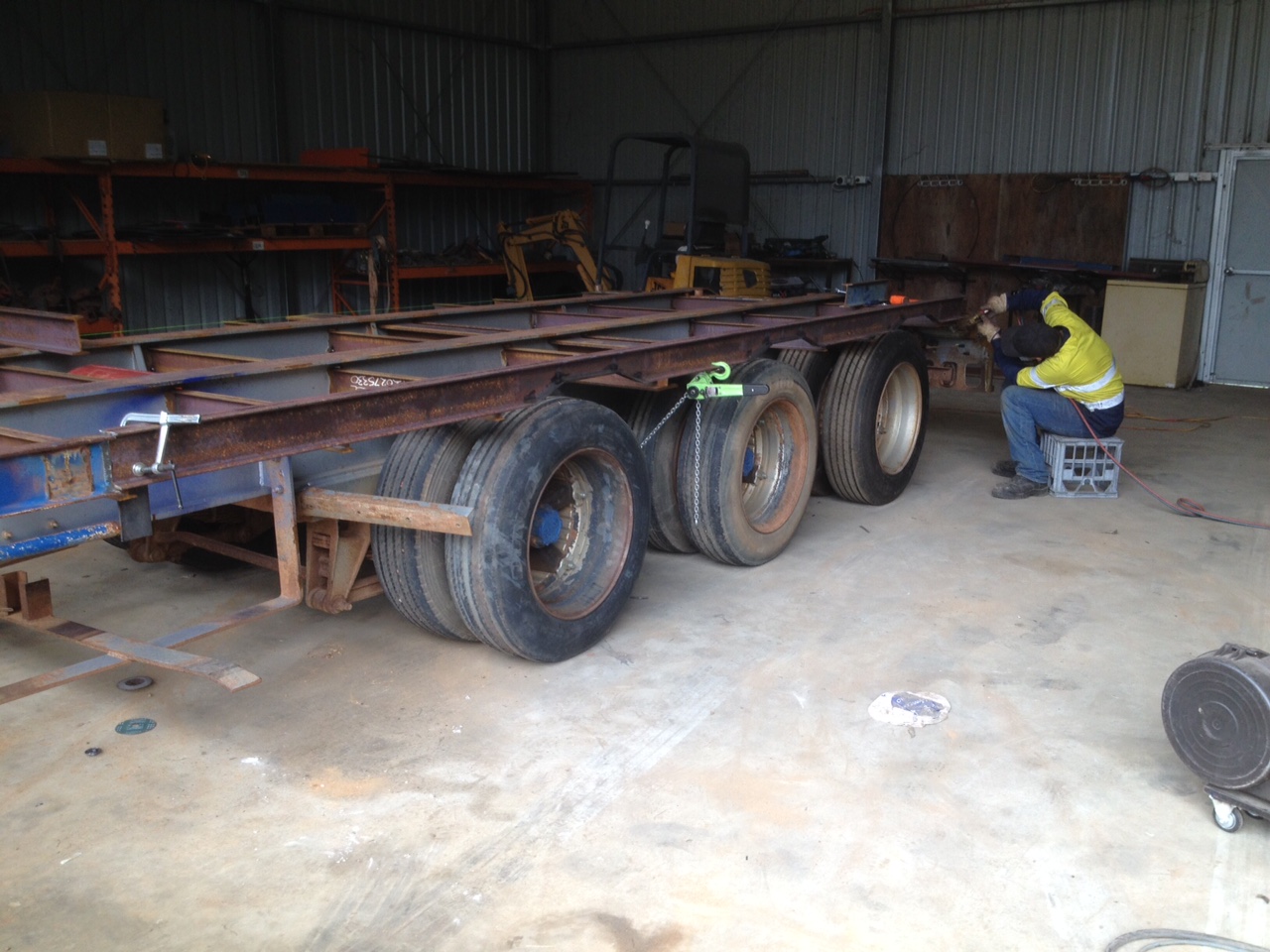

I have went a different route with the trailer. My mates brother got made redundant so gave him the job of repairing the trailer. Its slow, but I get a more hands on role and im saving as lot too!

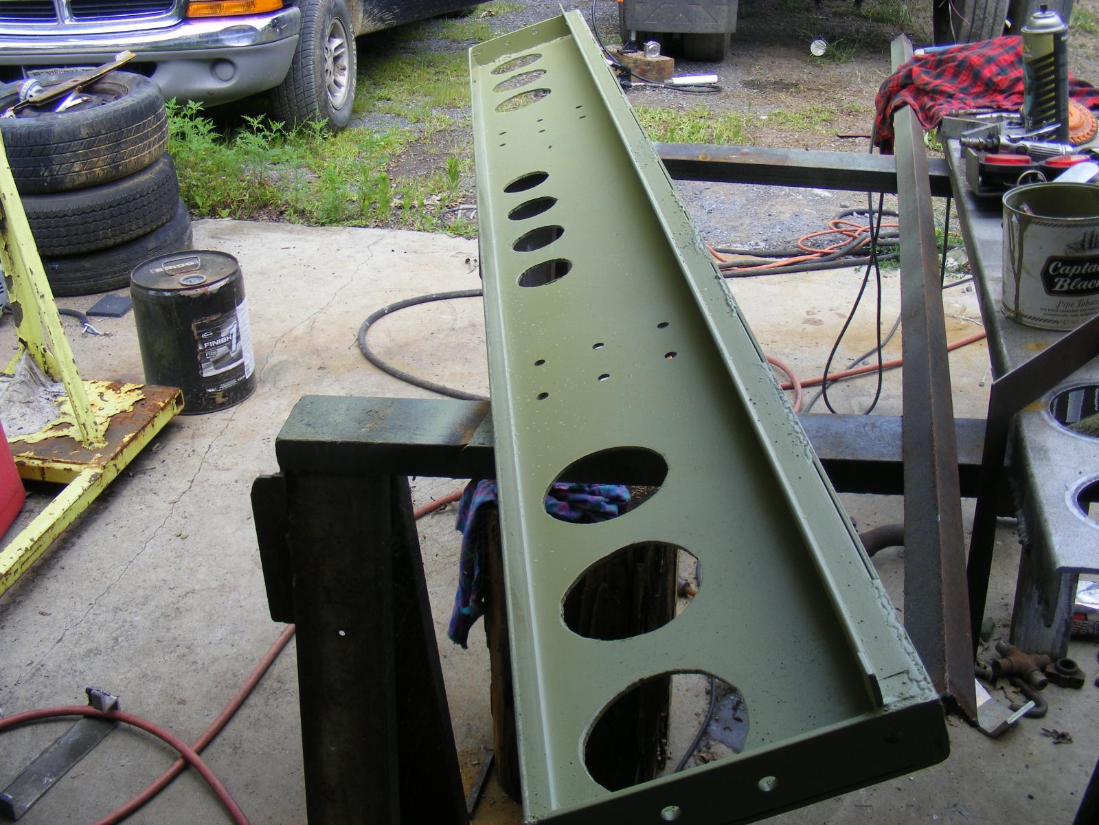

Installed some 20ft container beams while we had it apart, plus new brake boosters.
post-14557-0-39590800-1435970702_thumb.j
post-14557-0-46213100-1435970827_thumb.j
Sounds good to me, I always prefer to be hands on with stuff gives me a much better understanding of whats involved and it can make some jobs cheap to farm out so to speak
looks like its coming together nicely
Paul
Yeah we cut down the beam and plated it with 1/4 inch plate to reinforce it.
Paul, I'm a lot happier doing it this way. Mind you with work, doing bits on my mack, missus and the little fella I find it hard to find time to work on it.
That's life I suppose. Keeps me from being bored!
she's a sharp looking bit of gear now :twothumbsup:

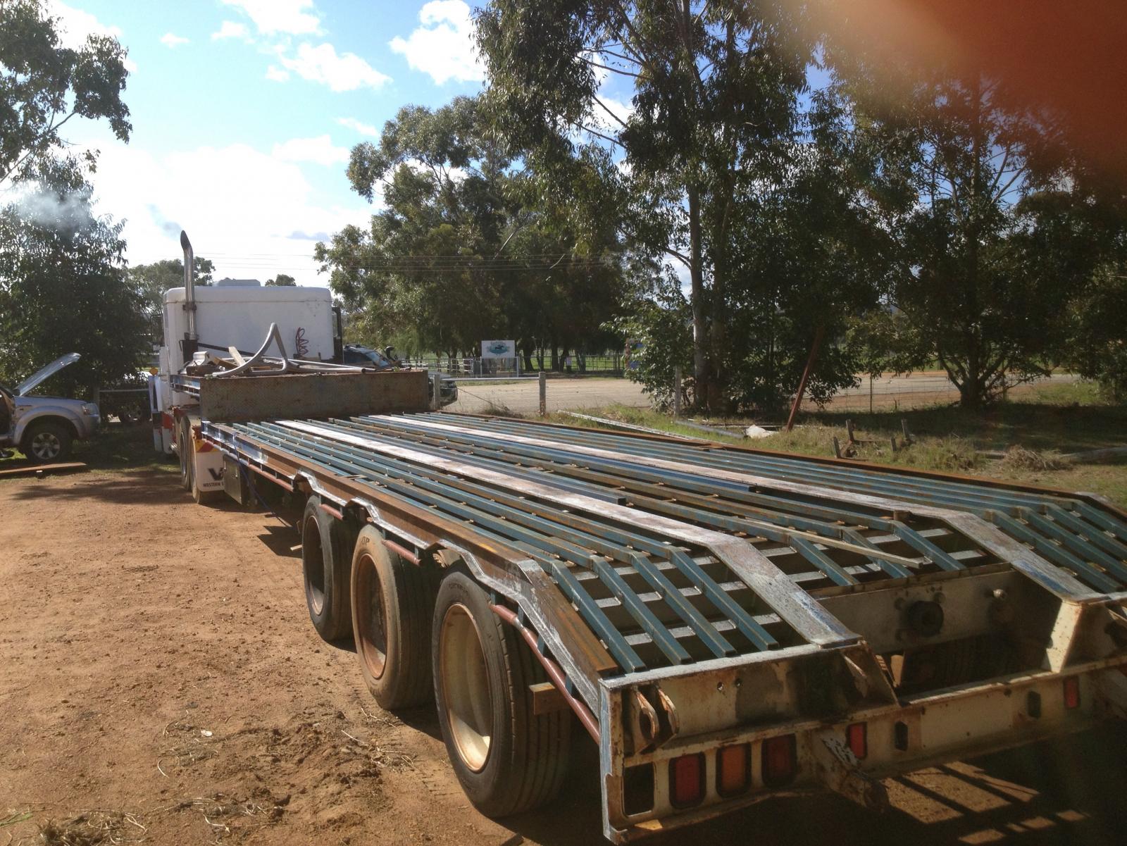

Thi Paul, well the plan is get all the sheets on, cut out the container pin holes and then my mate will tack it in place, while I'm about with a hammer.
Apparently when you weld it, the floor rises a bit. So when I see the cherry from where his tack weld is, I belt it with a hammer and flatten it out. So hopefully we can get all the sheets tacked in, then weld it the next day.
It's a lot different to driving! I'm enjoying it though. Probably wouldn't be the case if I did it day-in, day-out.
Tim.
lookin good u want to start on another one? I`ll air mail to you :)
I'm glad to say that I'm just the t/a (trades assistance) for this job. Plus the turn around time is a bit long...
Looking good wont be long now. What are you going to do about paint and did you go over budget?
Still a while away from paint. Gotta do the ramps and dummy fit the hydraulics. But it's going to eventually be red... As for budget, I reckon I'd be a touch under so far. But there is still time for a blow out;-)
