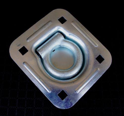

Recessed tie downs. Put them where you need them. Flush with floor, just like what is in my race trailer. It shouldn't take much to keep that "goof" cart from moving around.

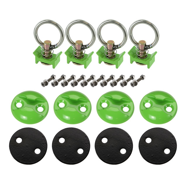

Next week I am going to MATS and see if anyone is selling tie down "stuff". I checked the front drop area and I only have 4" between the "bumper" boards so a standard E-track (5" wide) will not work. My other option is a L-track. Seriously thinking of buying these single point tie downs and install along the sides (USCC $20 for 4).

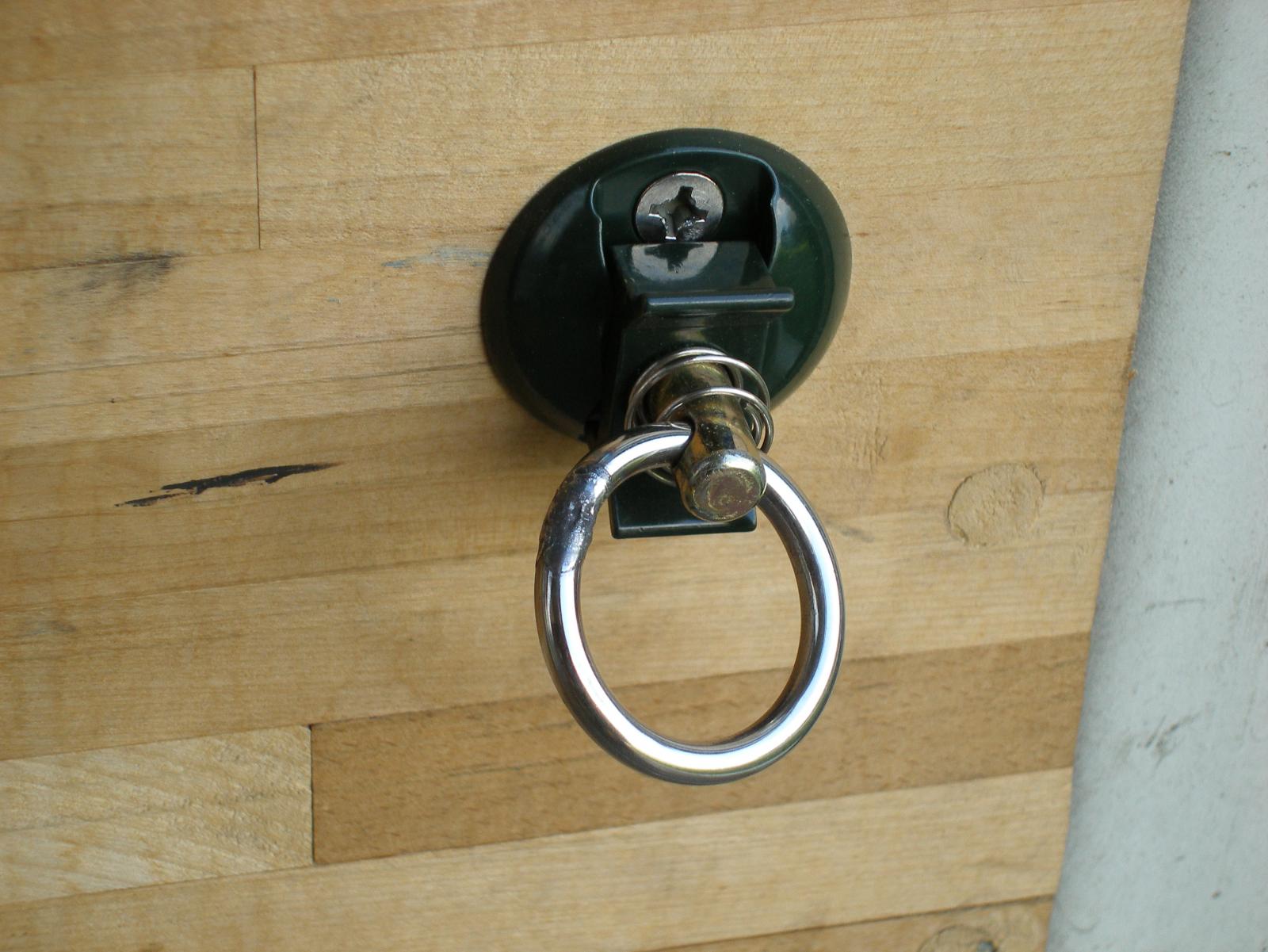

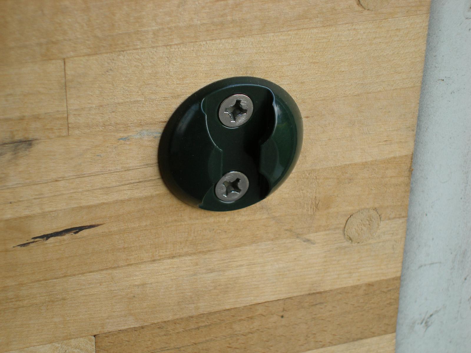

Installed six (6) of eight L-type tie downs today. Spaced them about 6' apart on each side starting just inside the rear door. Two (2) more to install in the lower front drop area. Going to anchor them with wood screws. Since they are in front, don't need that much strength. These tie downs will not hold a large tractor or Mack truck but should hold the goof cart, garden tractor, or similar size vehicle.
