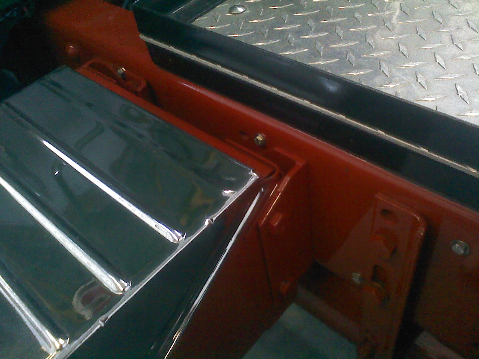

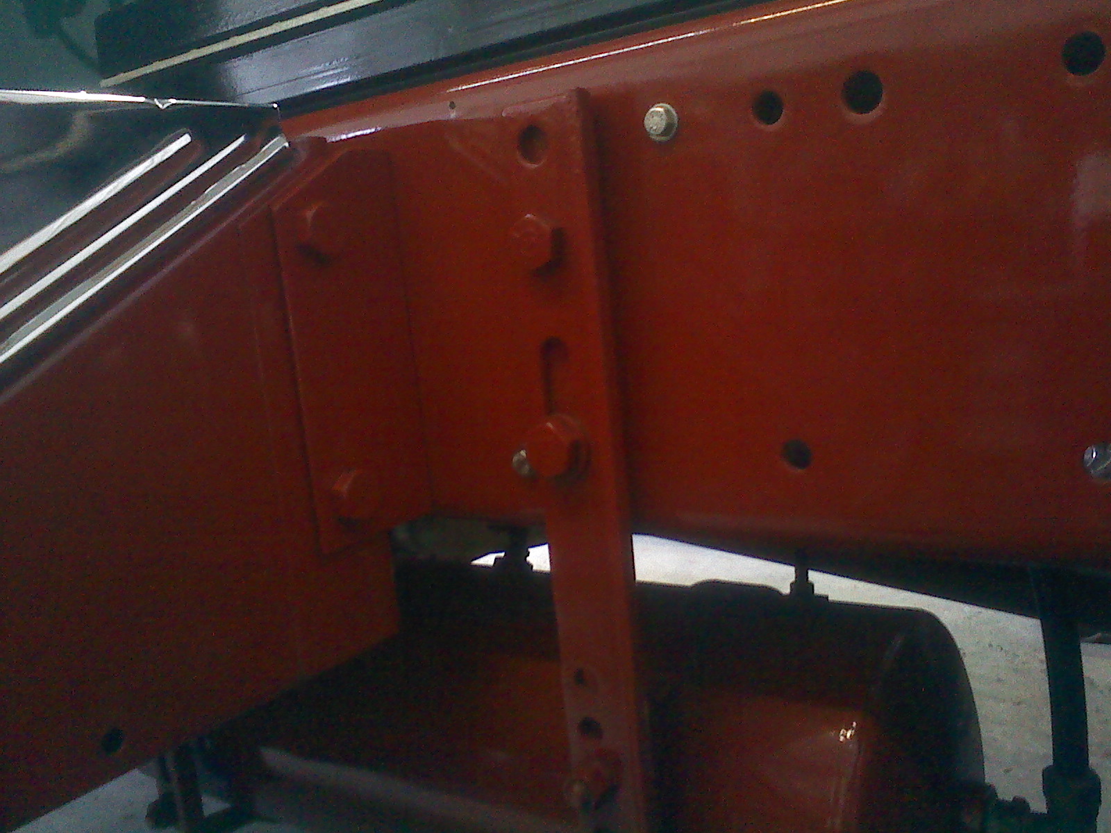

I am looking to either build or find 2 good used ones for my B87.The ones i took off were homemade and they were way over kill for what was needed.If anyone has a set of prints or a couple pictures of the ones on their trucks that shows what they were made like it would be great. Once this God Awful weather warms up a little i would like to get the old girl up and running.Thanks Mike Durkin
https://www.bigmacktrucks.com/topic/39114-b-model-battery-box/
agree. most are using R model boxes. might have the drill the holes out to 5/8 as the R model boxes are and the B models were 1/2 or I guess you could just 1/2 bolts . I made angle iron brackets for mine and bolted them on from the side to get around the extra air tank i put on the side. Tidewater Mack use to have a stockpile of B model ones back in the day but i think Matt Pfahl finally ended up with them.
