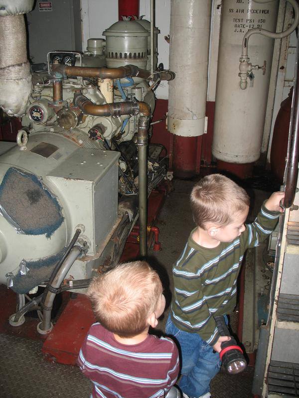

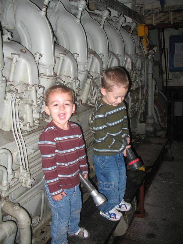

Thanks Glenn. What was the application for a 16V-149 ? Is it a 2 stroke ? When I was in the Navy 1968 we had plenty of 53 and 71 Series Detroits in small boats. 16-278A was used for emergency generators on big ships and main propulsion for Destroyer Escorts and other small ships. Green Dash never thought about stickers being stuck on engine for cosmetic purposes.We ran Detroit,Cummins,Mack and later on a few Caterpillar all were pretty good the worst engine we ever had was a C-12 Cat it had good power,fuel economy but would develop head gasket problems on a regular basis.The 3406's we had were good. Thanks Joe D.

General Motors Diesel pre Detroit Diesel with Gray Marine was a favorite for the U.S.Navy in small boats from my experience up to 100'in lenght. 6V-53in PBR's,12V-71's in Swift Boats and6-71's in about everything else small boat related worked well for the Brown Water Navy Boats. Biggest disaster I saw was 100' PGM's with 8- 6-71's,they were hooked 4 each to one shat 2 forward and 2 aft facing. Boats would go out with all 8 engnes running and sometimes only 4 on return.The U.S.Coast Guard used a lot of Cummins in their small63' WPG Patrol Boats. Joe D.
