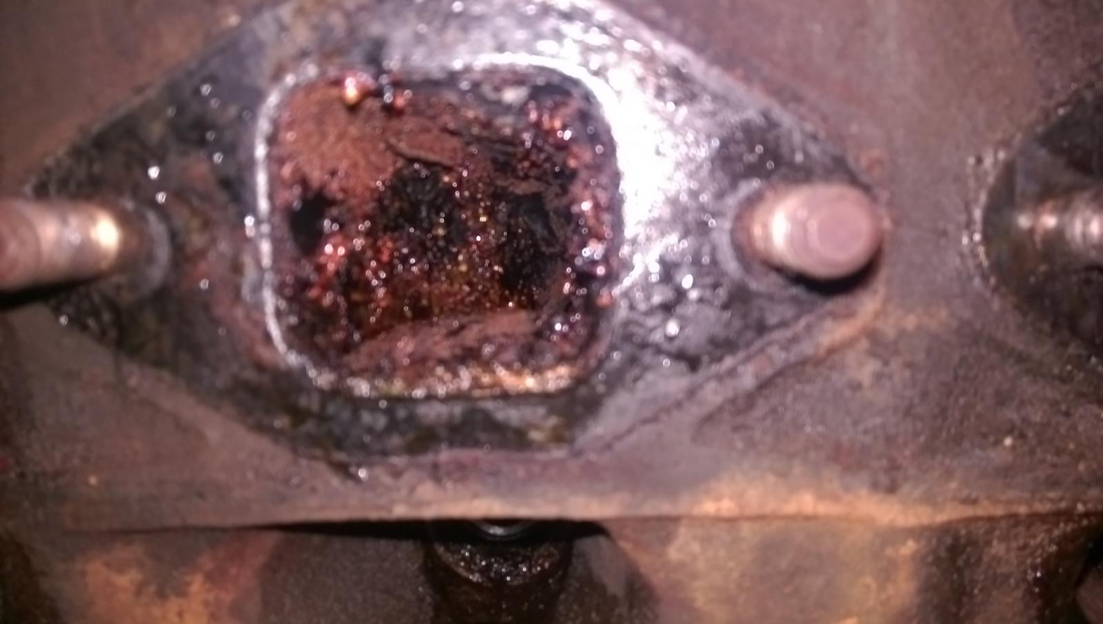

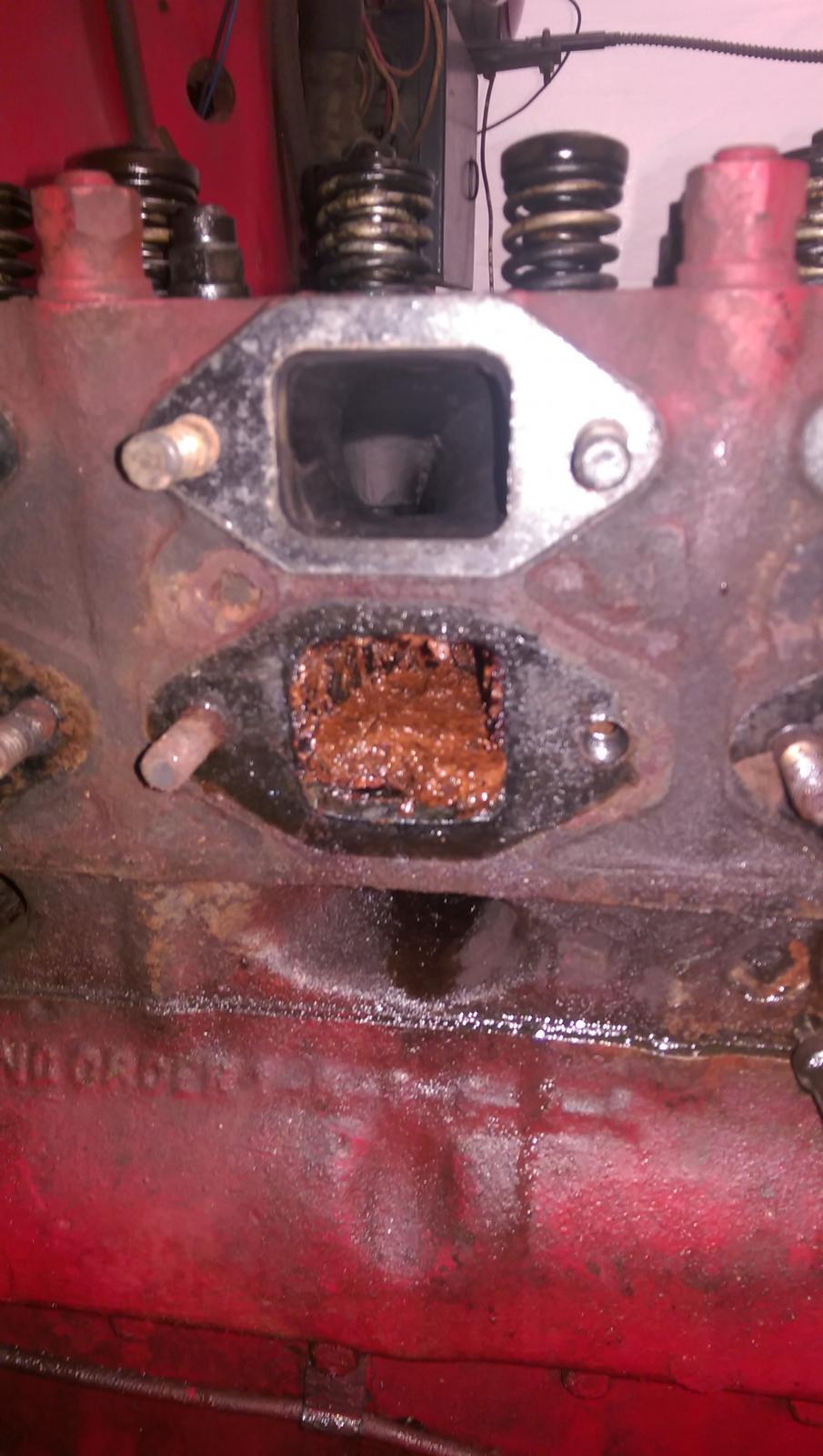

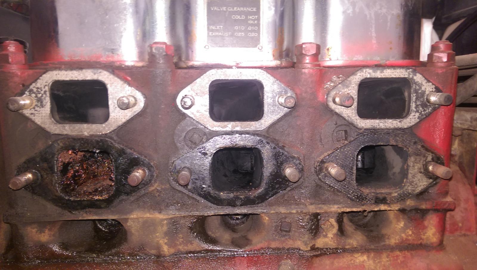

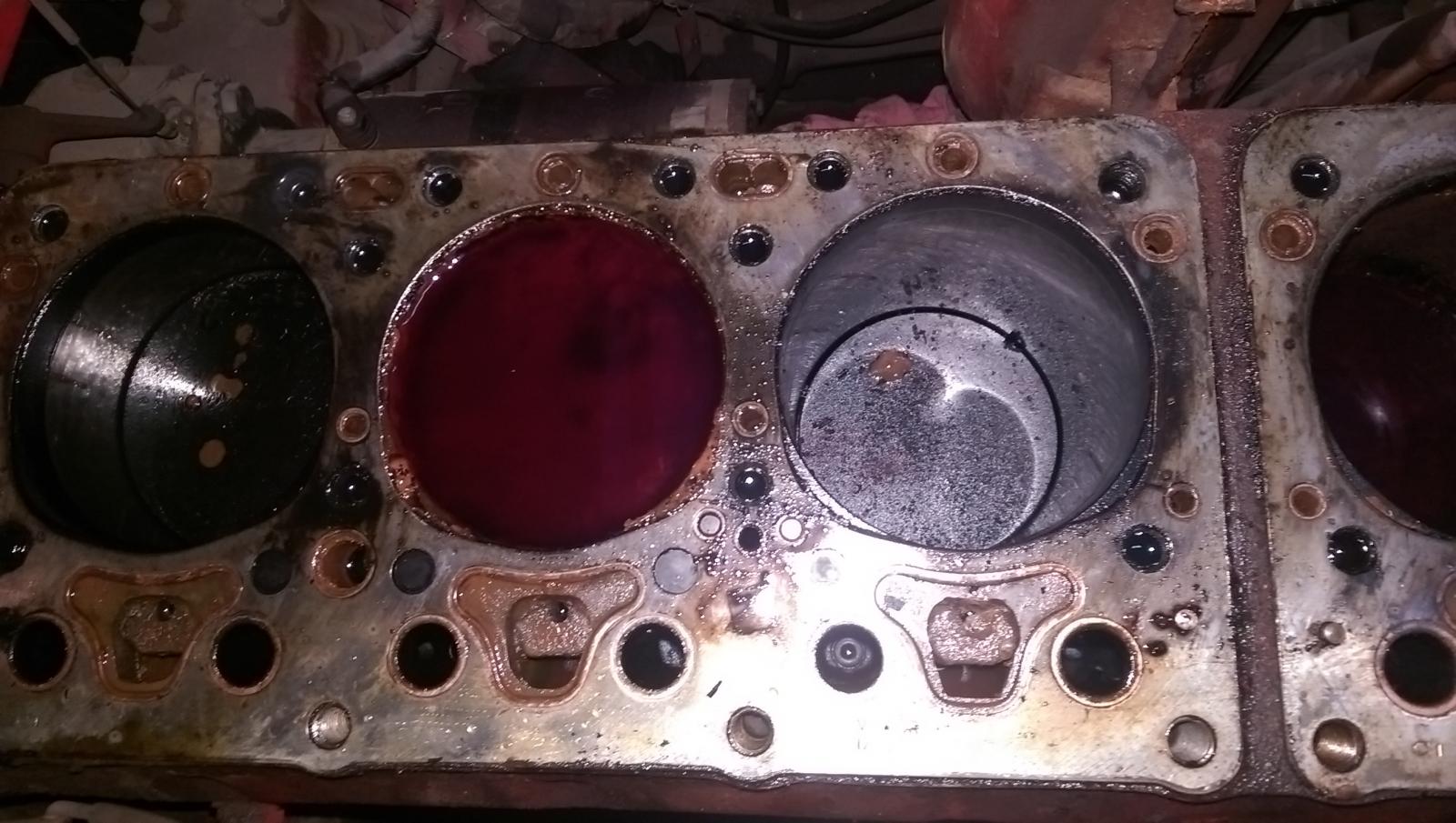

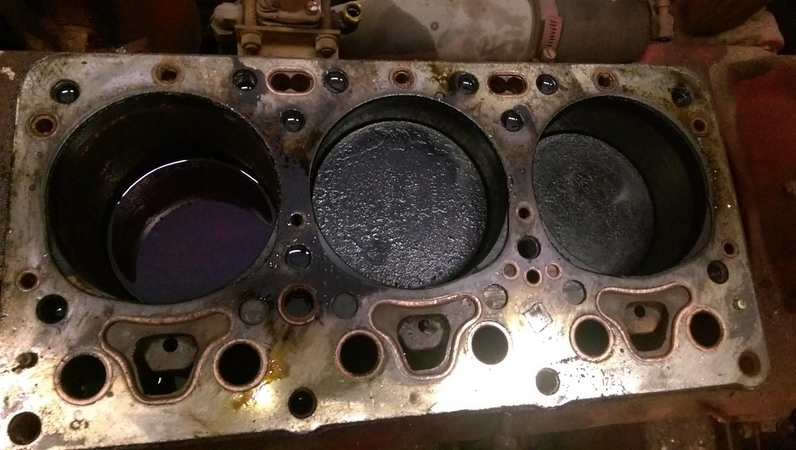

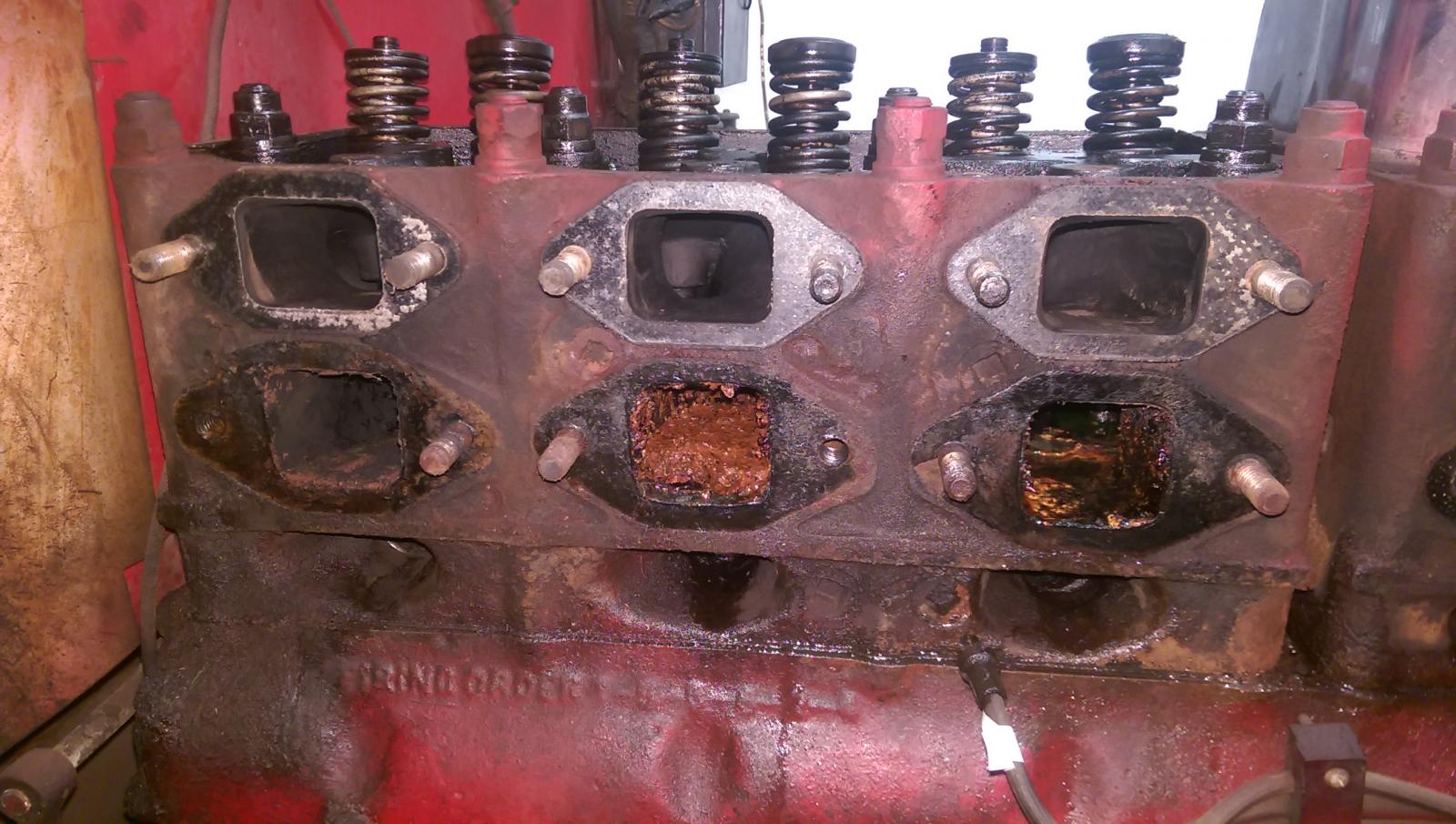

Alrighty then... listened to all of you and pulled the heads... looks like pistons #3 and #5 have crap in them... i am hoping to not have to pull the motor... but the heads look fine... i cannot figure out how water/coolant got into them... head gasket looks fine as well... some pics are below.. any thoughts are appreciated...

From seeing the rust in the port on the head it probably got there through open exhaust valves. Every exhaust port seems to have some degree of rust. Condensation has a way getting inside during storage. Probably find the rings flash rusted to the cylinder. some times you can get by with a set of rings and a light hone, sometimes not. Paul
Thanks ya'll for the feedback... and of course you were right... I just pulled the PAN, and sure enough NO water.... the underside of the motor is immaculate... clearly #3 & #5 are stuck... plan for now is to remove the cylinders that are free, try to free the two bad ones, replace the rings and then put it all back together.... my hope as of now is to still avoid pulling the motor...
Remove all the rust and scale you can including as much by the piston / cylinder area that you can. Soak it for a few weeks with Diesel or Kerosene, that usually with free it up enough to use a block of oak and a dead blow hammer and drive it out. There is an other method but I would never use it on an engine in a vehicle... 1 cup ATF, 1 cup Gasoline fill cylinder and light it off. Let it burn out and cool over night. The expansion from heat and cooling generally free the rusted rings. Fire and the engine being in the truck are a no no. Paul
