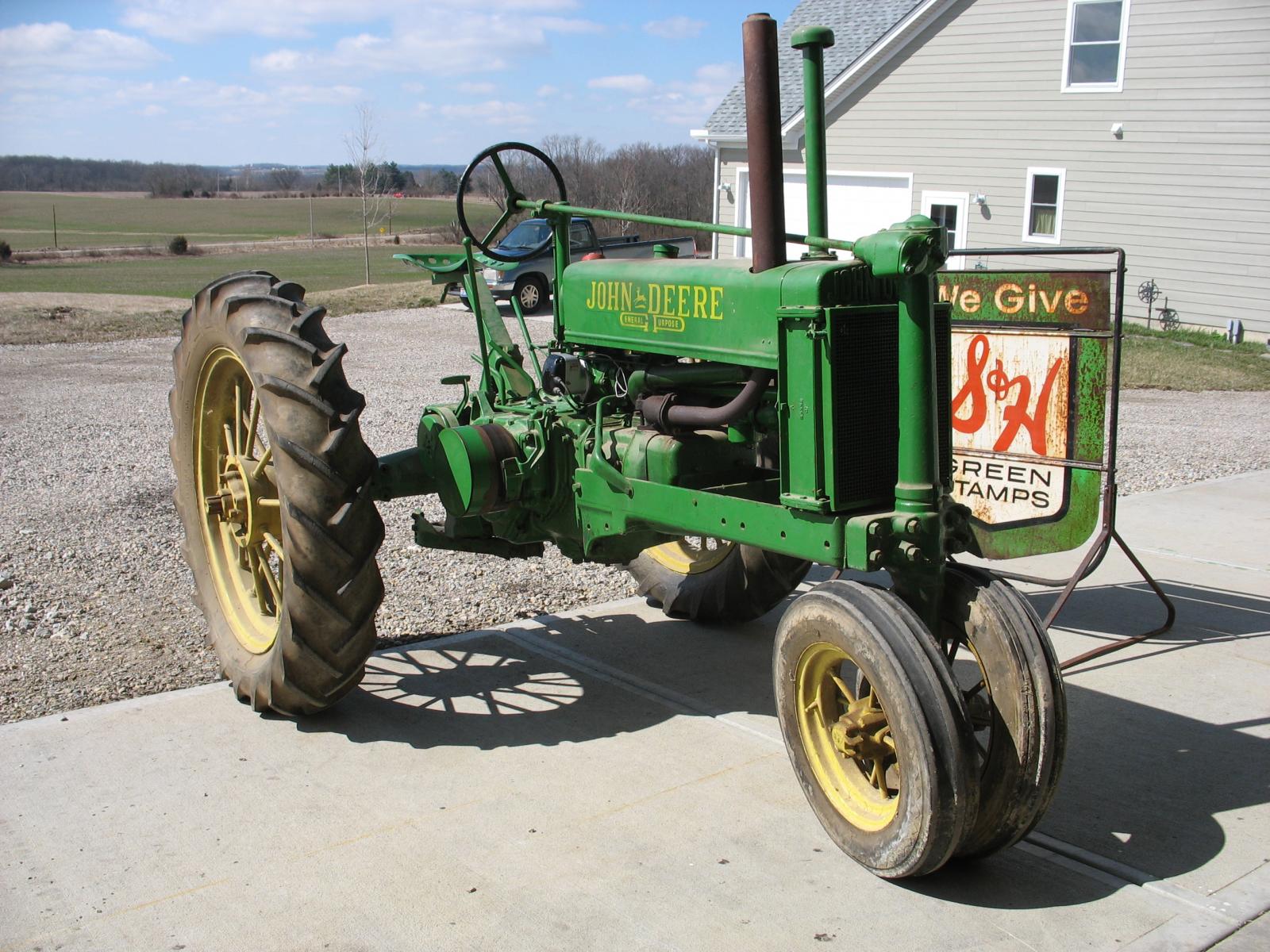

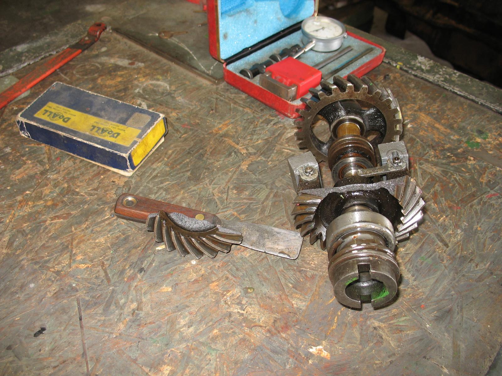

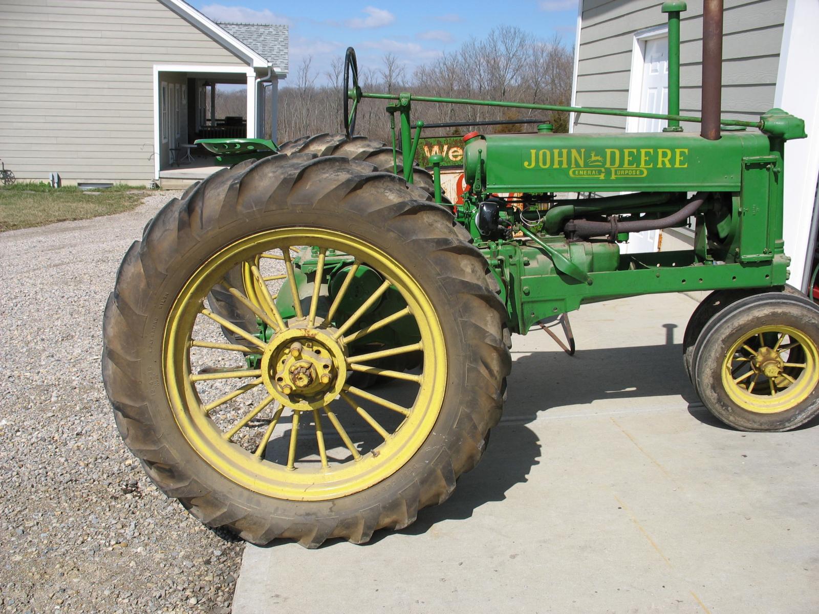

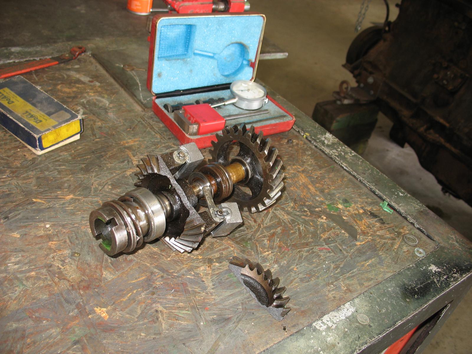

A couple of weeks ago I tried to start the model B no spark. The impulse on the mag was broken. Sent it off for repair. I turned the engine over a few times and something did not sound correct. Pulled the governor cover and saw the broken gear. Pulled the steering shaft, hood, engine cover, & fan shaft to get the governor housing off. The fan shaft gear and drive gear have to be changed as a set. I found a good used set in KS. Spent the best part of a day getting these set up with shims and gaskets to get the proper heal and .004 - .007 back lash. The next day getting every thing back together. A lot of work to keep a radiator cool. I restored this tractor 40 years ago and hope to get another 40 years out of it. No clue what caused these to fail.
