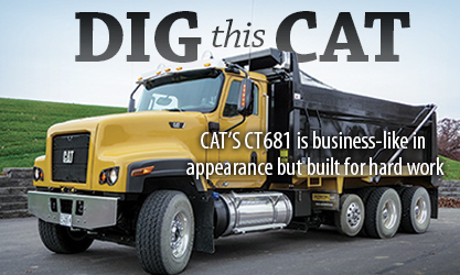

Caterpillar is taking it slow with its Cat Truck program. In 2011 it launched the vocational-only series with the CT660 truck and tractor with a setback steer axle only. This covered the majority of applications, Cat said at the time, even though it didn’t meet the weight distribution needs of others.
Three years later, the company has filled that requirement with the CT681, a truck-only model with a forward-set steer axle and simpler front-end styling.
The 681’s “industrial” styling contrasts with the wide, brushed aluminum grille bezel and bumper trim on the 660. That simplicity is preferred by fleet operators of dumpers and concrete mixers, who will be the CT681’s main customers, according to Cat officials.
A third target is heavy snow-plow service with highway departments – appropriate for what’s shaping up to be another wicked winter. Hang a big plow on the front end and you can’t see any bling behind it anyway.
“True” front frame extensions, not bolt-ons, are available to carry pumps and other gear for various types of service.
The 681’s plain, unpretentious looks means less to keep shined and implies a promise of husky performance.

The steer axle’s center sits 28 inches behind the front bumper. That’s the shortest in the truck-building business, we were told, so the long wheelbases needed in many bridge-formula states are easy to attain.
Minimum specified distances between axles and axle groups gain the maximum allowable weights and payloads under laws in such states. Think western “super dumps” and “bridgemaster” mixers and you get the picture.
Our test truck was neither; it was basically a 10-wheeler with a single, small-wheeled lift axle ahead of the tandem. Zingre said the Bibeau steel dump box carried 15 tons of sand. Add the truck’s tare weight of about 26,000 pounds and we were at 56,000 pounds gross, so the pusher axle stayed in the air.
