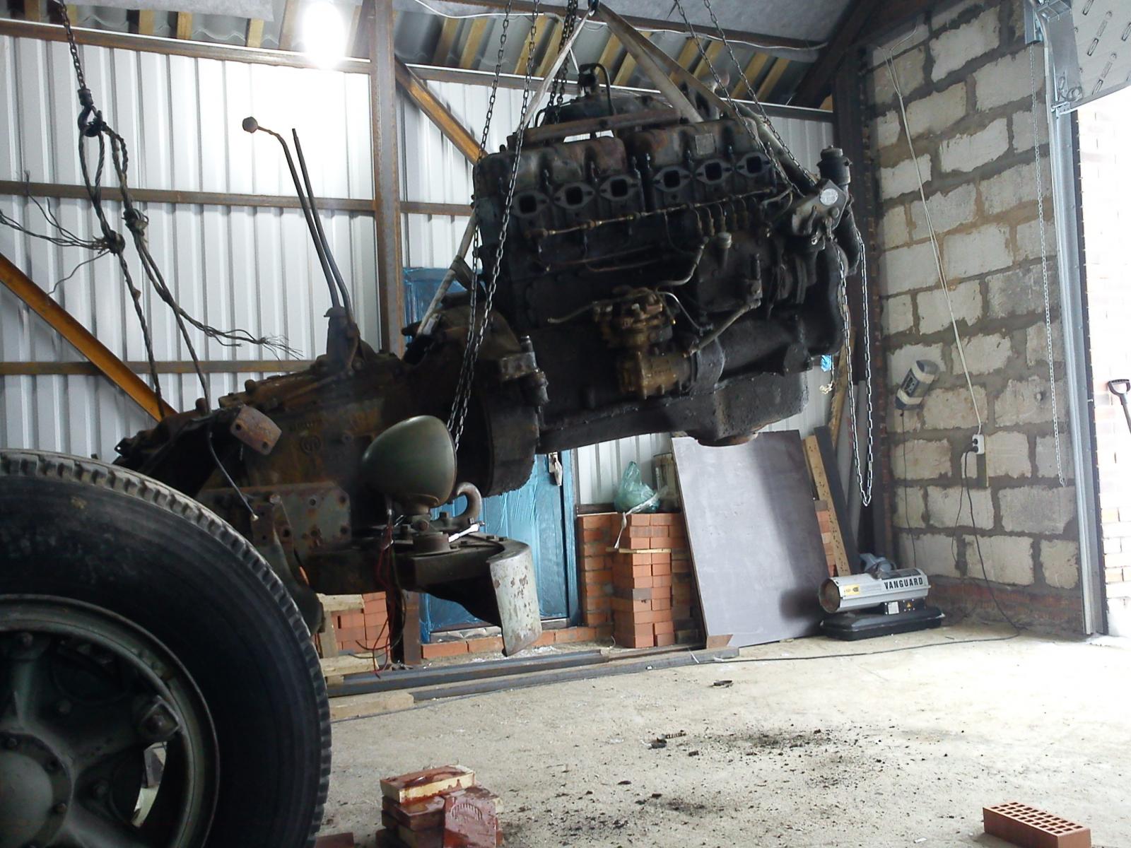

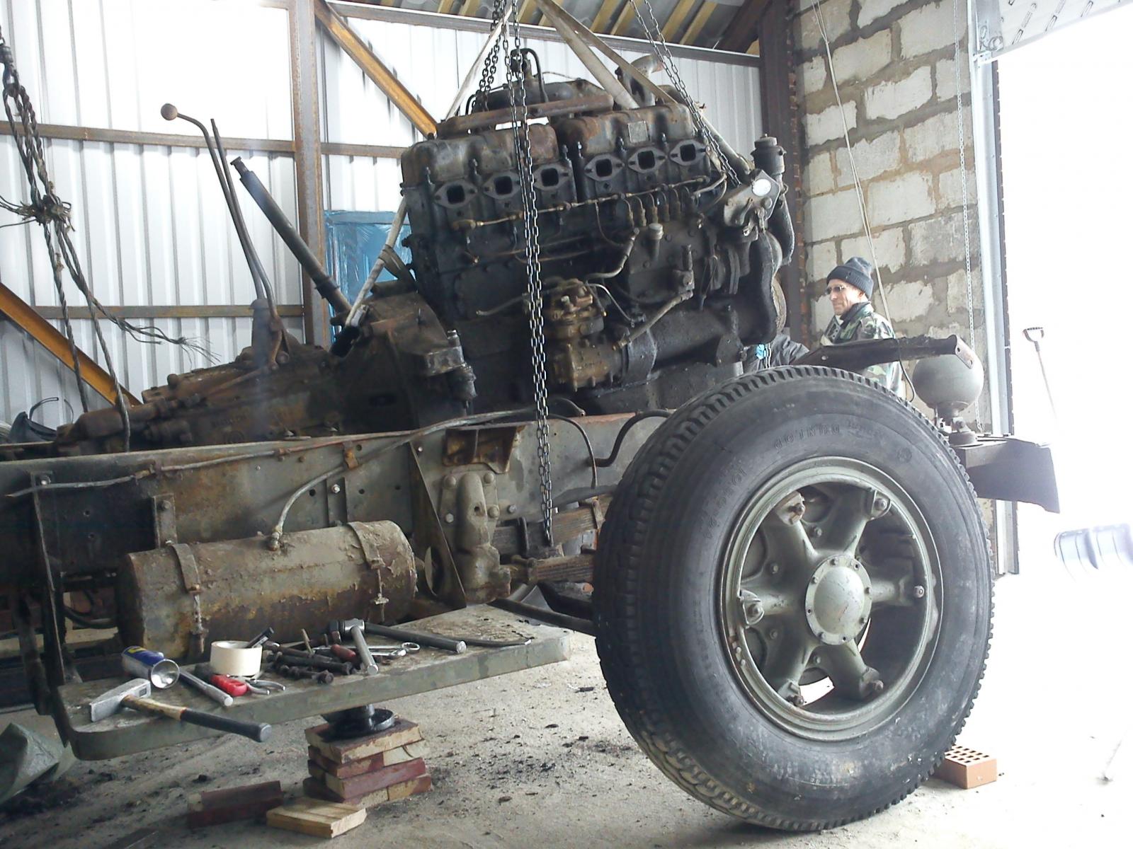

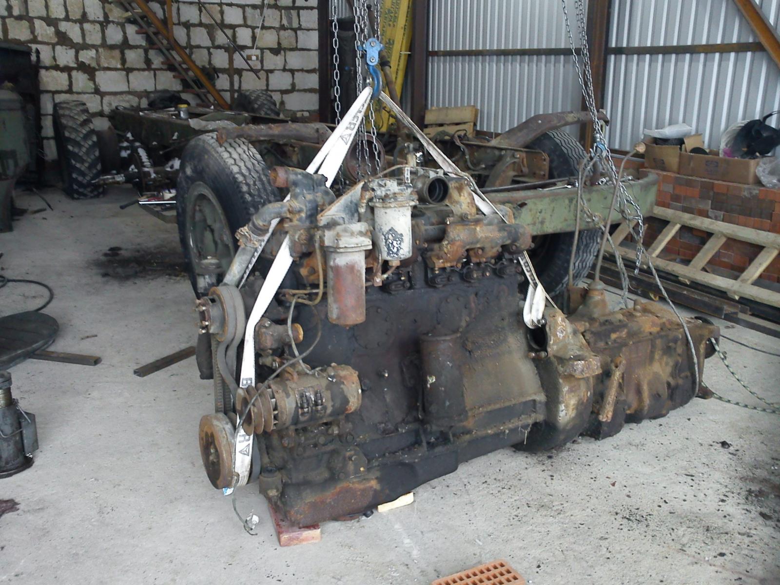

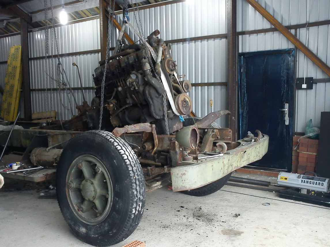

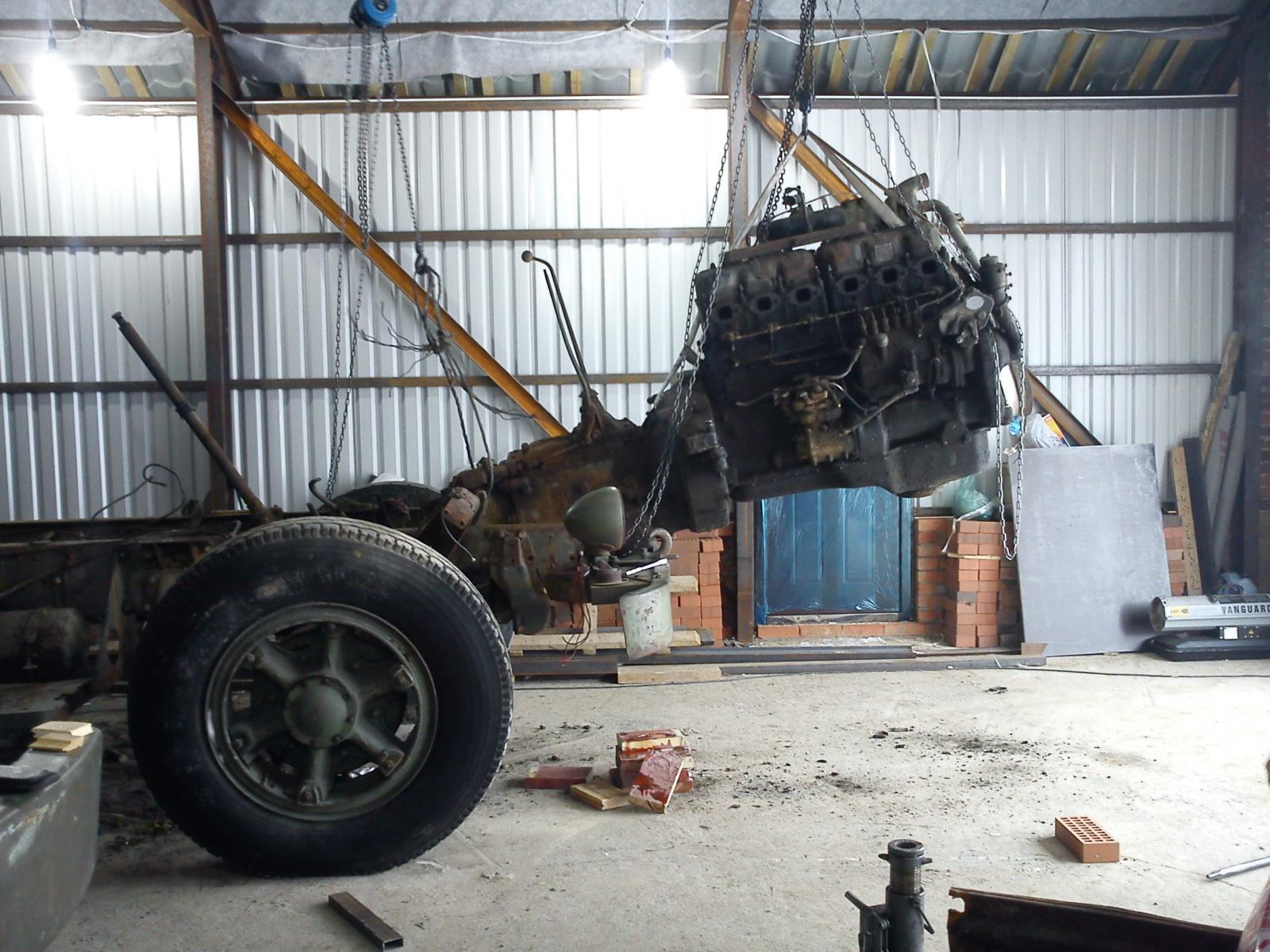

From the pic you posted I'd say your truck has rear engine mount on the bell housing, not on the tranny.
It's the L-model and it looks almost similar to my WW2 NR model.
If so it's impossible to keep the transmission in its place.
I pulled the engine with the tranny together with a chain hoist. The total weight was about 1600 kg, 1000 for the engine and 600 for the 10 speed duplex tranny.
Not exactly shure about your truck but the manual of mine said to take a cab off or backwards for a bit.
I would say you're going to go the same track.
There was a difficulty to clear up the steering gear when pulling.
I will put it back without the gear box although I'm going to do it before the cab is on.

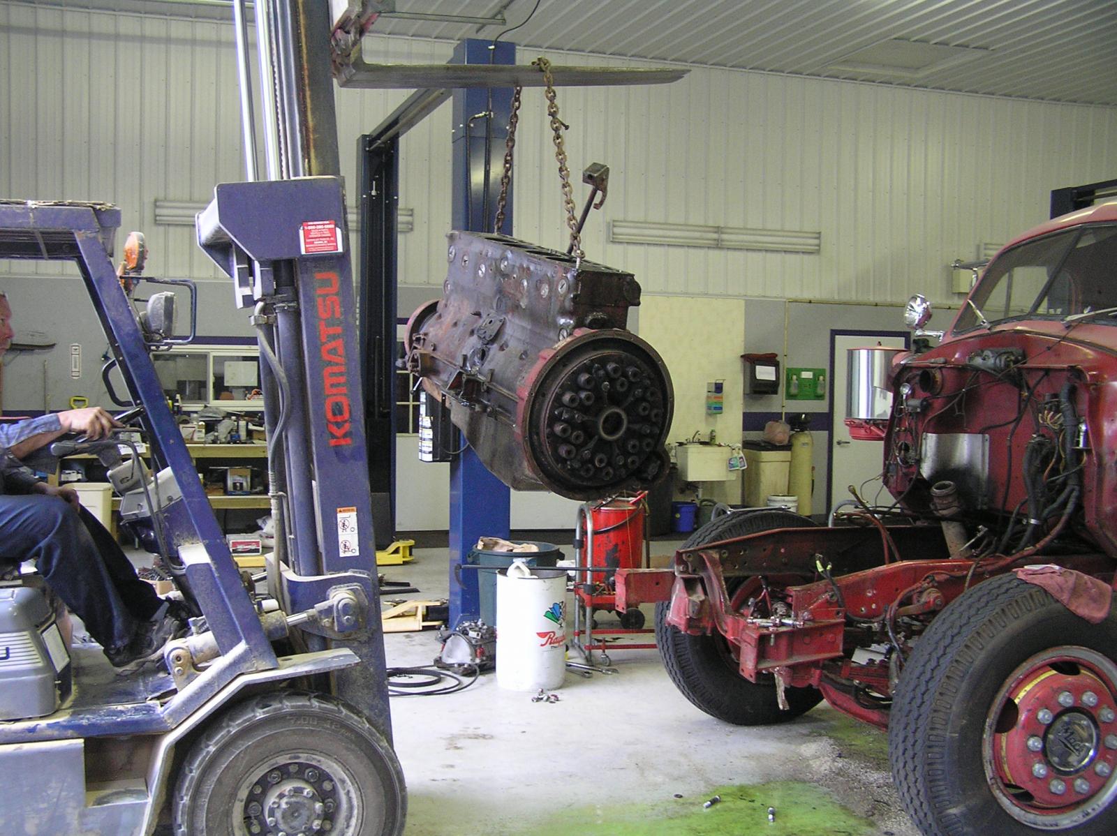

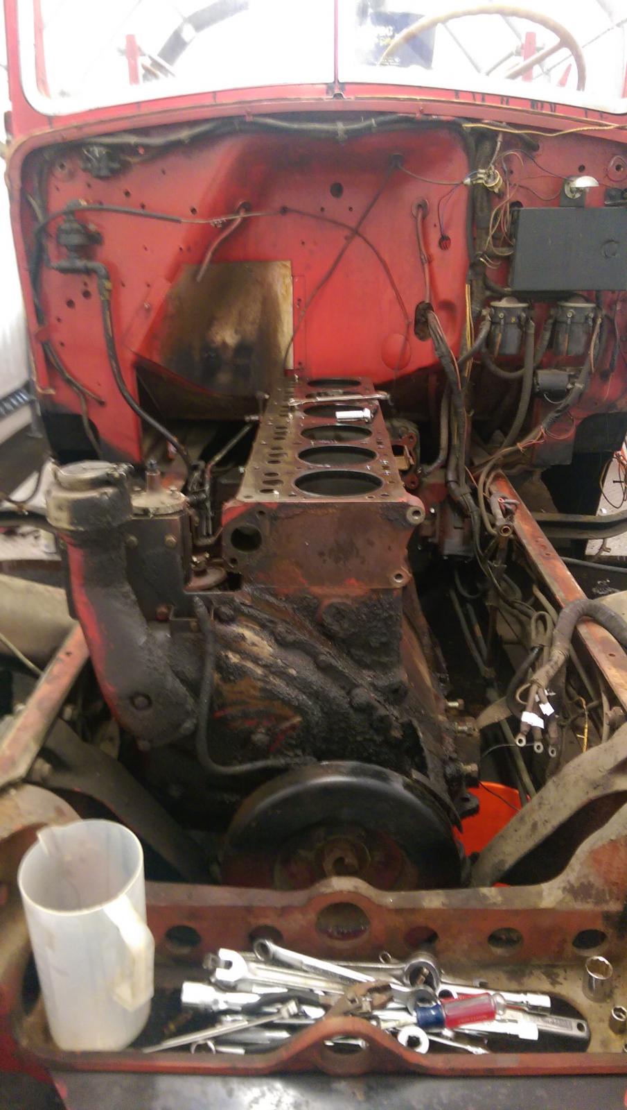

Thanks everyone for the feedback.. I am thinking that i will go the forklift route and pull the trans and motor as a whole... i am still holding out some hope that I can pull the pistons and free up the two stuck ones without removing the motor. I removed the pan tonight and found that the underside of the motor is is great shape.... next... i'll try the pistons....

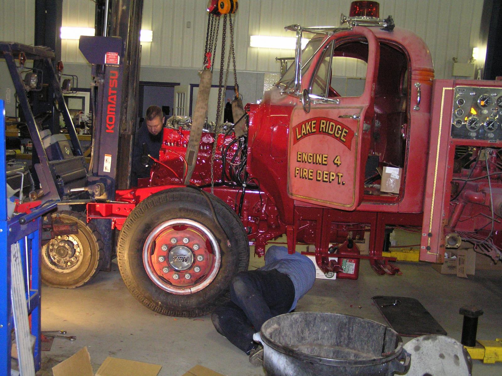

Pulled my engine and trans together but I had a good sized modern loader and operator to run it while I guided it all up and out of the hole. I detailed the trans and didn't have to struggle with the trans input shaft allignment while trying to set it back in place. I've got most of an ENF 707C if that helps. It's in Massachusetts. Need pistons and rods but the rest is there and in good shape.
