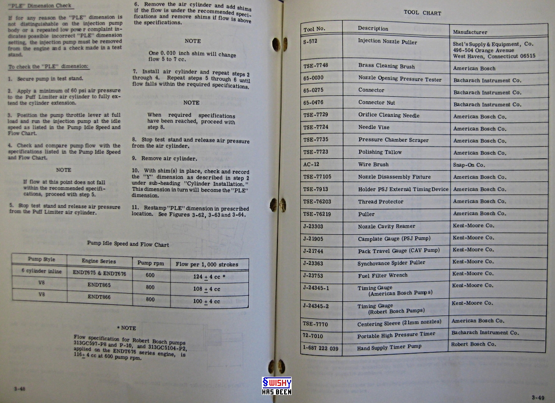

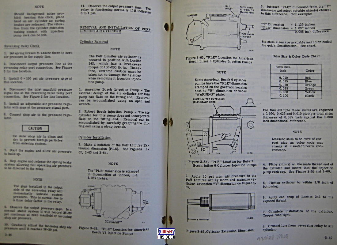

So.... After reading the book( Thanks Swishy) I see why it is hooked to the air brake valve. The injection rack requires full fuel to start the engine, after starting, the governor will pull the rack backwards. You would never start the engine without the air brakes set.... Unless you have a B model with a mechanical parking brake. This wouldn't be a problem since my truck looses all it's air pressure when it sits overnight, but going to fix that soon. I will have to run an air valve just so it will start, and a added bonus boost switch.

If the puff limiter works the way it should. you shouldn't have lots of smoke and it should run as well as the pump is set.
Releasing the parking brake should send air to the reversing relay in the intake manifold, then from there the air is metered to the puff limiter's
cylinder on the pump.....which can take a few tries to shim correctly. The reason for working from the parking brake is for full rack travel for cold starts, as an engine requires a rich mixture when it's cold ....so no air to it allows full fuel at cranking when you floor it.   and on that 460, the puff limiter is called an ECM (loL)

The puff limiter is to limit rack travel to limit smoke. As manifold pressure builds the bimba valve(on inj. pump) allows more rack travel. As long as you have the correct reversing relay and the bimba valve is correctly shimmed, the engine should run just fine. The engine will get full rack travel until the park brake valve is pushed in to aid start-up. On an engine with a LDA, the rack is mechanically restricted until manifold pressure overcomes the LDA allowing full rack travel.
