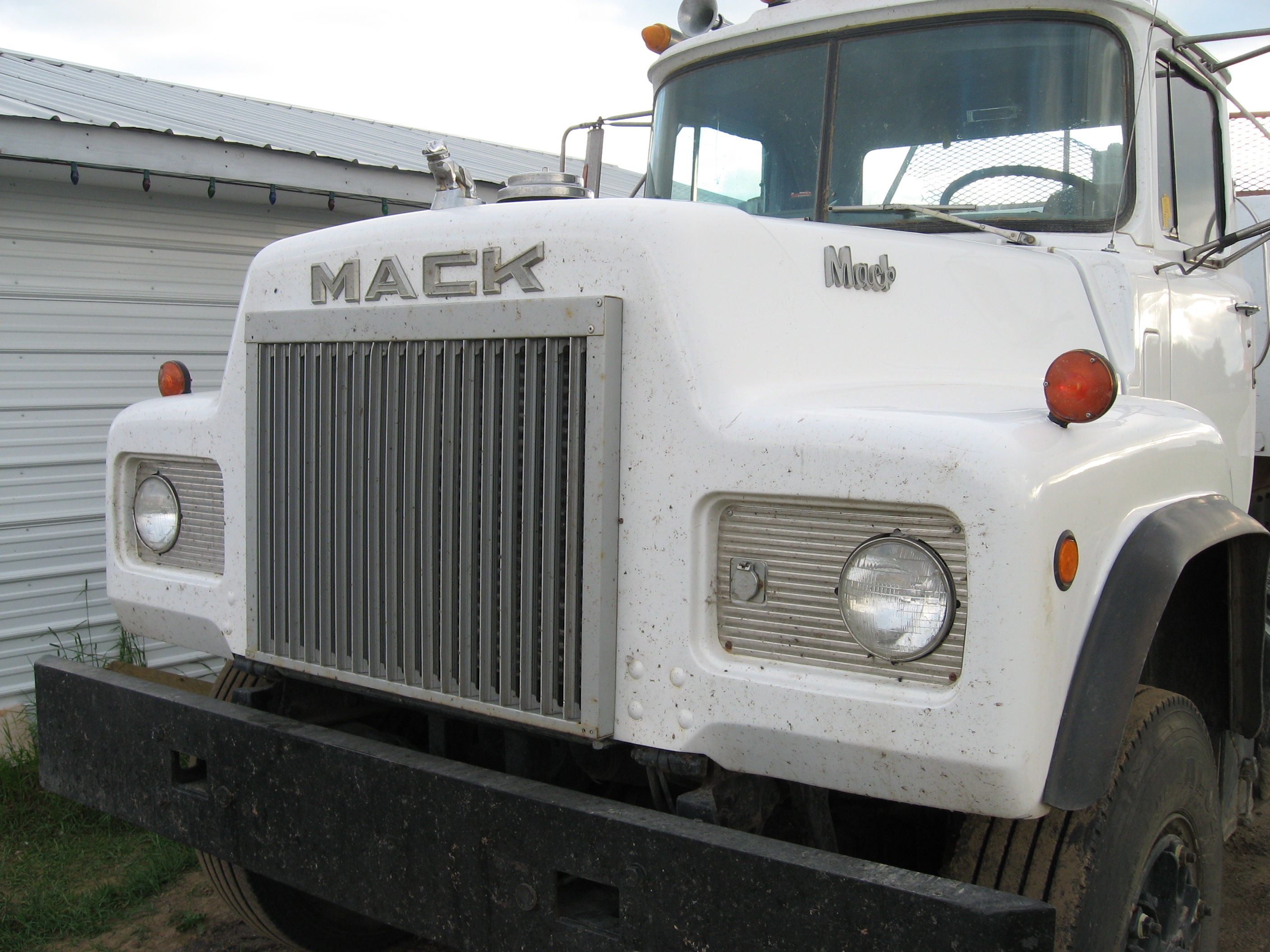

this one has them mounted on the out side of the hood because of the air to air.I have only seen one other truck like that .So if you have a fan clutch they don't have shutters? i am a fan of Mack trucks but not to familer with the options.thanks.
Those would be the "fixed" type "shutters" just for appearance.
With a viscous fan drive you would not have actual opening & closing shutters, nor would a truck with a CMCAC (chassis mounted charge air cooler) have shutters because closed shutters would render the CMCAC ineffective.

So should they be removed and just install a screen.Or i guess maybe just unhook them maybe just for now.Thanks for all your guys help.

i will post some tomorrow i am on dial up so it takes awhile to post pictuers

It looks to me like that was added on at some point. Why, I have no idea.
As I said before, with a charge air cooler in front of the radiator, shutters would not and should not be used because when the shutters are closed, the charge air cooler cannot get any airflow and becomes useless.
Lack of charge air cooling will lead to high exhaust gas temps, overheating and low power.

thanks for your help i will disable it and go from there

The only reason I can make for this type of setup would be to eliminate cardboard in front of the radiator in the winter to keep heat up in the cab. Those shutters do not look like anything "factory" that I've ever seen.
Do you have an air, or electical toggle switch in the cab, or are the shutters automatic in operation via a thermostat in the coolant passages of the engine?

they are automatic usually they are closed when i start the truck but when it warms up they open.there is an air line that runs from the coolant passage to the shutters.My dad had a 1976 mack RD700 it had the shutters behind the grill,so i was kind of wondering about these.

Hi Jook, a 1976 model would not have had a grille in it from the factory. The shutters were the grille. The opening for the hood would have been framed with a stainless steel perimeter moulding. The western trucks were different, and could of had a full grille in the form of an inverted horseshoe with a "perforated" center section. Do you have an air to air intercooler mounted in front of your radiator? You mentioned it is a 350 Mack engine and all of those with the exception of very early ones had air to air charge air cooling. The early ones used a water to air setup much the same as the 283-285 Mack engines of the 1970's, and the 300+ engines of the early to mid 1980's.
As mentioned, the shutters on an air to air setup with a radiator mounted intercooler is self defeating as related to power and economy. It will help you with keeping the water temperature up in the winter time but so will a good engine thermostat. Shutters were basically obsoleted by the advent of the clutch fan whether viscous, or air engaged. Personally, I like shutters based solely on appearance but I'm not around new stuff hardly at all.

Thanks Rob the 1976 did not have a grill it just had the shutters as a grill.Now that you mention the shutters as for winter time warm up you could be right. when i bought the truck it had a flat deck on it. i remove the flat deck on it to put a gravel box on it i noticed some body had ran cooling lines behind the cab with quick couplers. So it probally had an engine on the back for what ever job it did.They used the truck coolant to warm up that engine.
