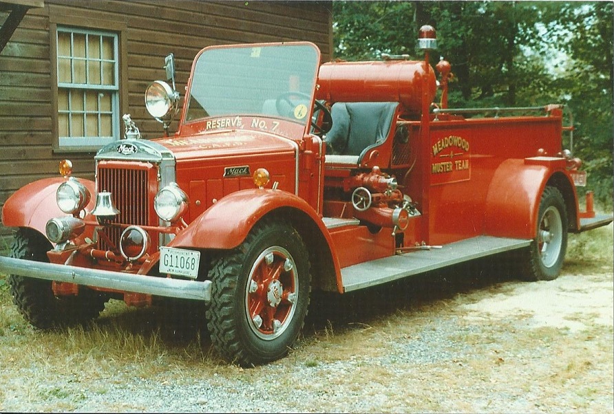

Fitzwilliam, eh? Meadowood County Area Fire Department used to have a 1930s Mack early "B" model fire truck that they used for musters, etc. Since MCAFD is out of business,
I wonder whatever happened to that old Mack. They also had an "R" model tanker, a Mack Aerialscope, and a Mack Aerialscope converted into a rescue truck.

The very first SCBA training I ever had was at Meadowood. Spent quite a bit of time in the Fitzwilliam area as a teenager. J Hancock who is quite active on this site lives in the area as well. I'm sure he would be a great contact for you.
