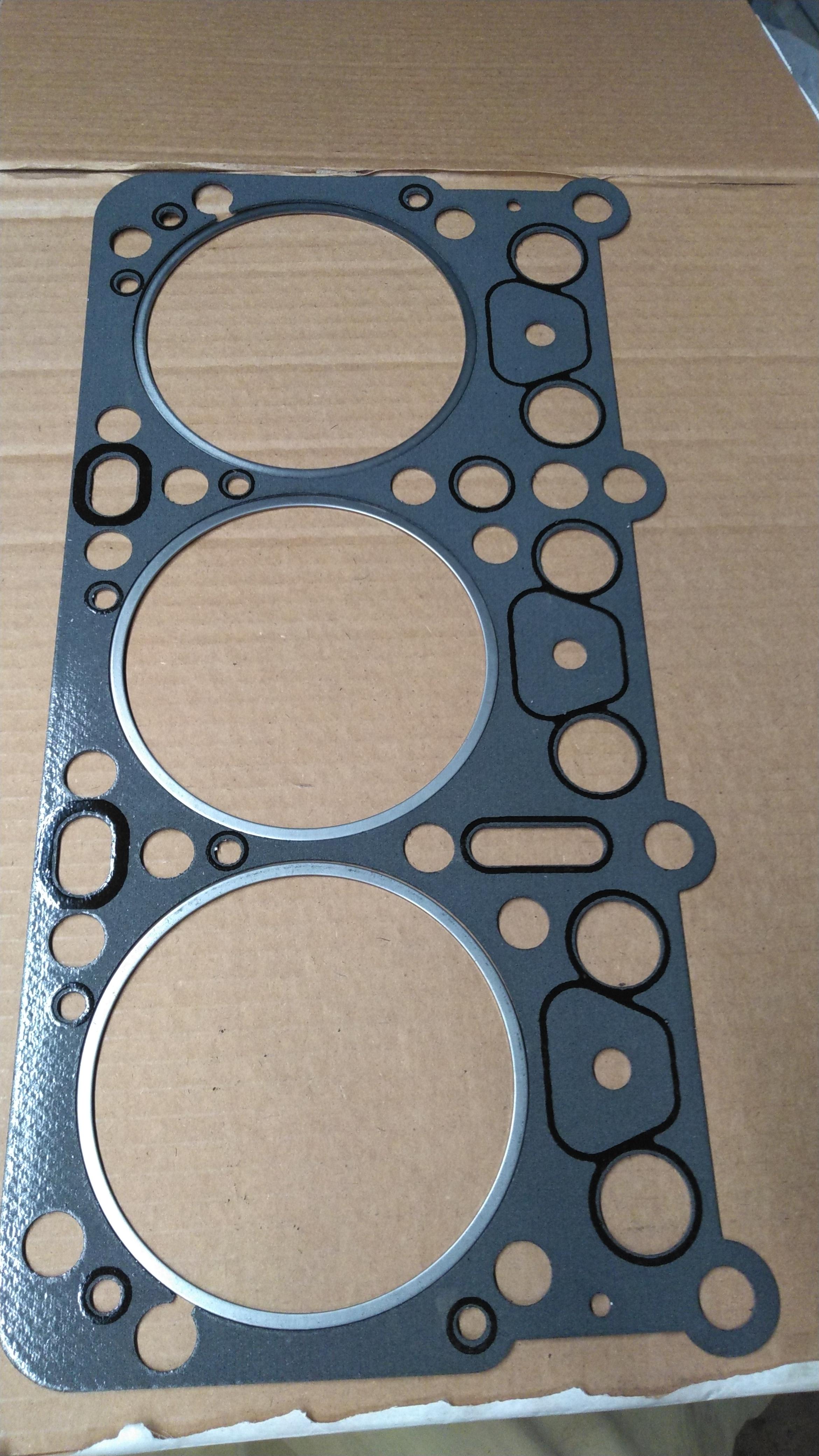

I have a 673 in my shop..  I had to change the pistons when I added a turbo..  So END-to an- ENDT...  I am not an E-6 Guru..  I just did some reading and asked a few people about the change over..  My new head gaskets have fire rings.  I wish I knew a lot more about these engines..  and when I finish this one, I will have to make a jig to mount it in, so I can start it up.  Thats going to be an effort..

Does your liners have the ridges for fire rings? and are the heads scored for the rings?   terry:MackLogo:

Terry, I went back to the begining of this thread...  I just saw that he has 18 bolt heads...  I have to apologize..  I have a 20 bolt engine block, and 20 bolt heads..  So disregard my statements about liners and fire ring grooves... Truly sorry,,,  Jojo

Yes My heads are correct..  it's not easy to find someone who knows how to cut the fire ring grooves in my area..
Expand
don't think it's limited to only your area trying to find someone to cut rings. wide spread . have 15 mins before leaving for Dr appointment. knew I should have stayed off BMT. will be in Dr office racking brain cells trying to picture head gaskets of days gone by to see fire rings/ grooves. late now !!
