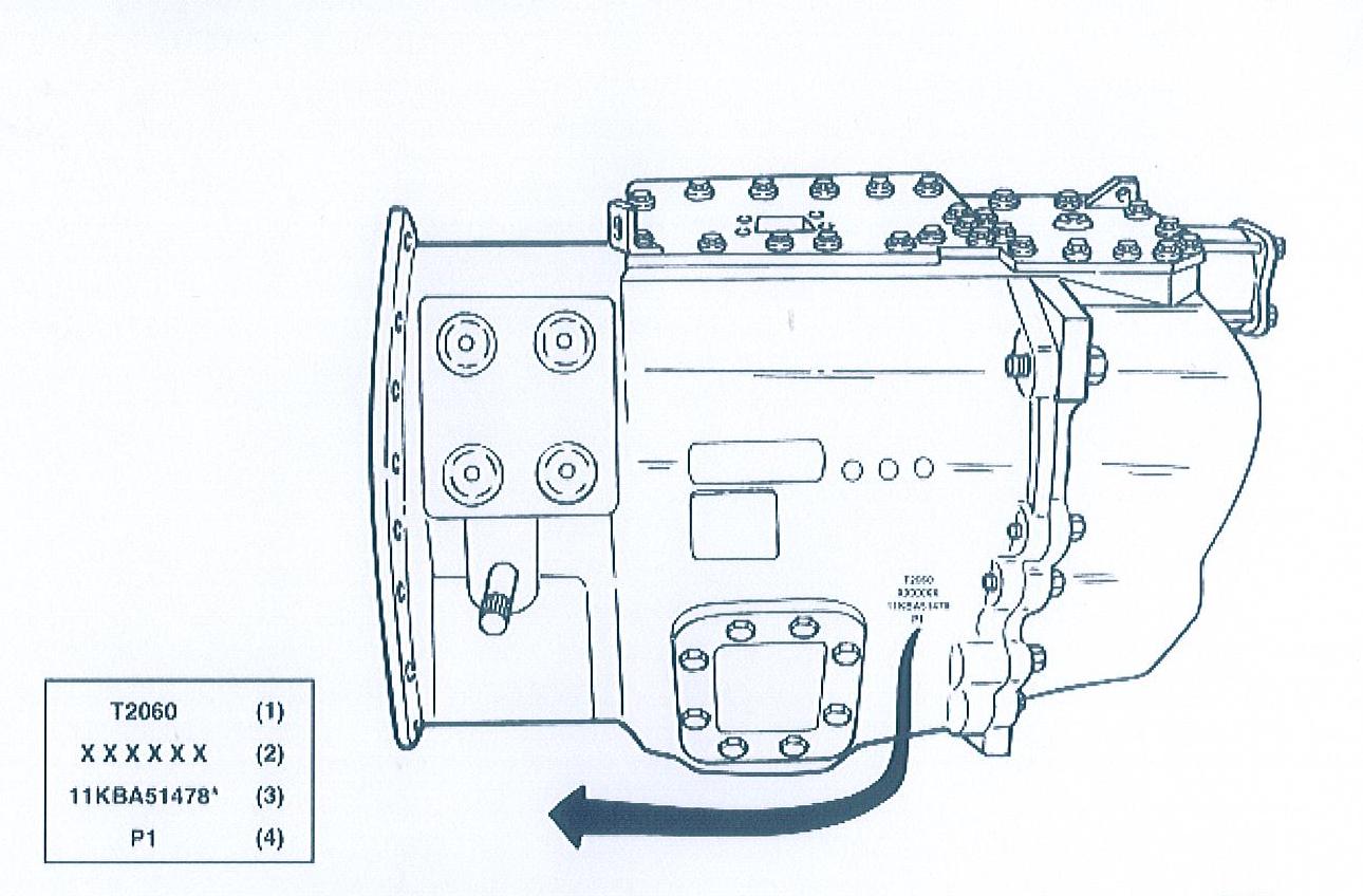

  • Solution
How do I identify my transmission model?
On the left side of your Mack transmission, toward the rear of the main box case, is the stamped identification information.
1. Mack transmission model number
2. Serial number
3. 11KBA assembly number
4. P number, which designates the variation of the main assembly.
The 11KBA number is used together with the P variation. As in this example, 11KBA51478P1. This is the number Mack dealers use for looking up your desired replacement parts.
post-16320-0-91783800-1431647295_thumb.j
