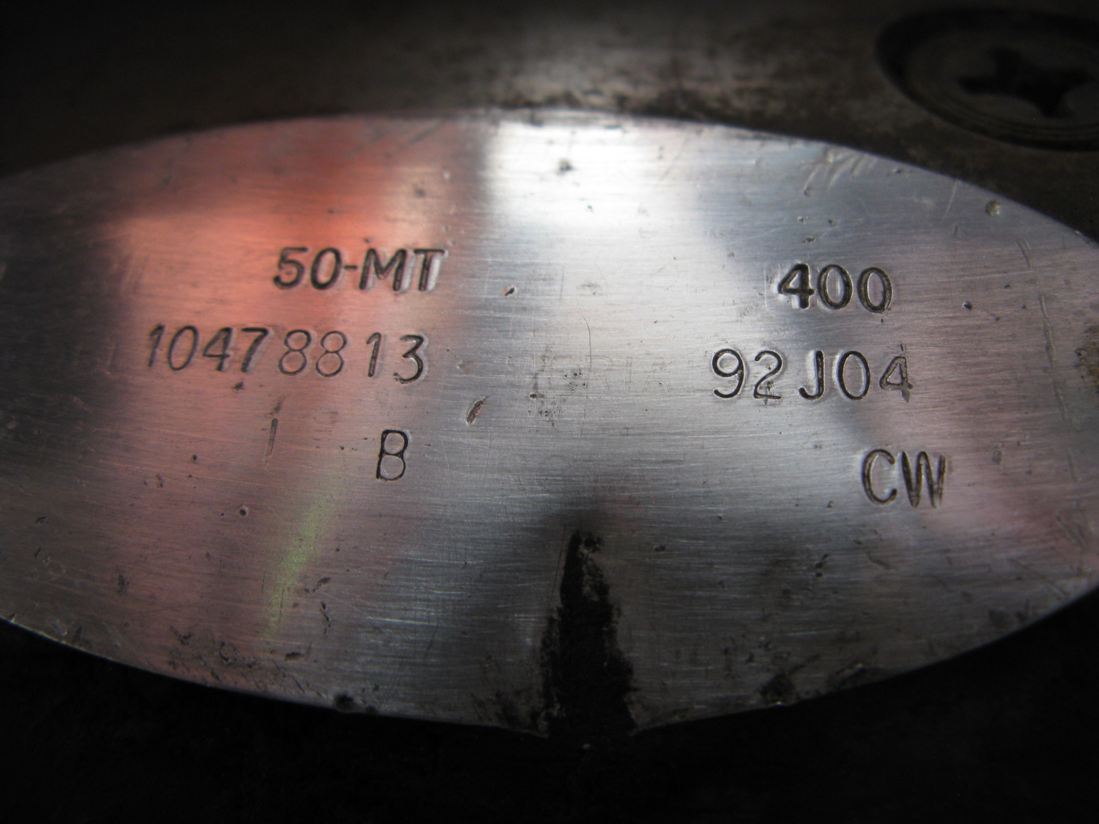

pic of the data plate... is this what you need?
11 teeth... used my squinty eye for that, hope I got it right
IF... you understand the data on the plate... is the info 92J04 mean that my starter is a 1992 unit???... if so, my 93 MH was built with 12v not 24v start.. cables all look original.... hmmm
