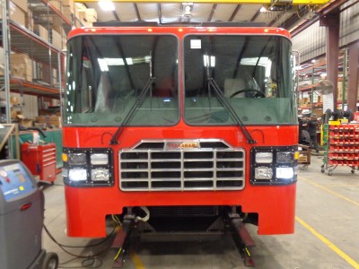

You can blame NFPA for that one as well. 1901 has such strict power load requirements for the electrical system that the builders are basically forced to go to LED's to keep the loads down. Same reason many motorized lights are no longer used.

I actually like LED's from a maintenance and amp draw standpoint. However they just dont look right in a mars light. You can still get halogen lamps in them though.

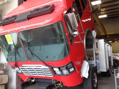

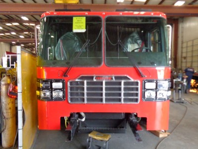

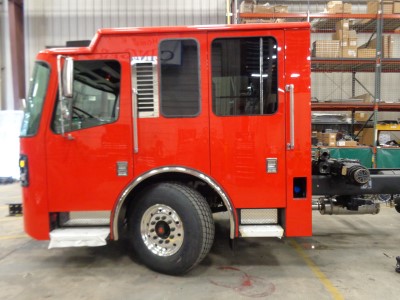

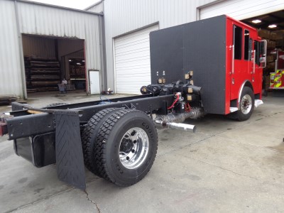

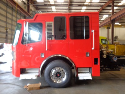

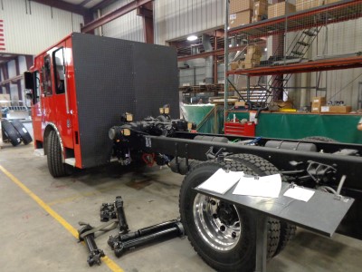

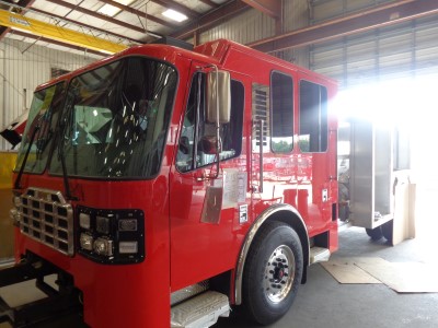

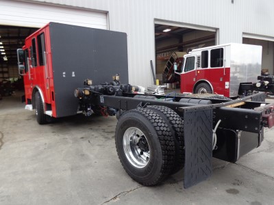

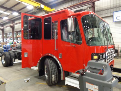

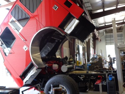

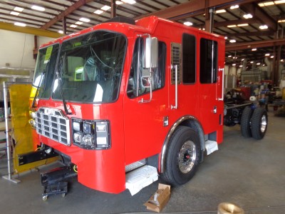

May 20, 2015. Work progresses. Most of the major cab work is done. For you Fire Department Spec-Writing guys, note the back of the cab- we spec'd a Rhino-Liner type material to be sprayed on. No one ever sees the back of the cab, so why paint it, and why waste money on diamondplate? Some neighbors of ours did it three years ago on their new pumper and they love it, so we stole borrowed the idea. The discharge valves and foam system is being installed on/around the pump. The Body Plant is 75% done cutting the body panels, and assembly is scheduled to begin on Tuesday 5/26.
Very nice. Rhino Liner! What a great idea.
The power draw on new vehicles is way beyond our systems now. You're going to see 24 and 36 volt systems in a few years to keep up with lighting, computer controls, satellite systems, entertainment /com systems and all the new drive by wire controls. Paul
The front bumper (which will have a 100' trash line/car fire line) will also be coated with the material. They will also color the liquid to the same color as your paint if you want....for a substantial upcharge.......I cannot remember for the life of me if we opted to color it or keep it black though.

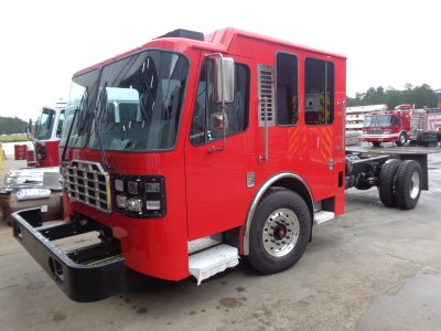

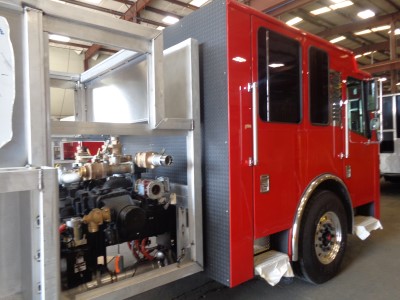

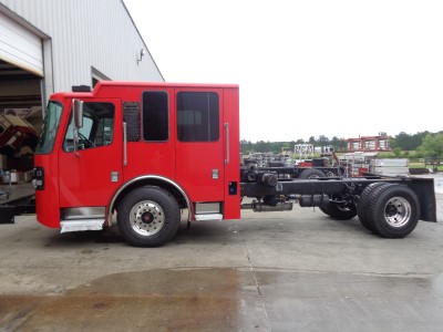

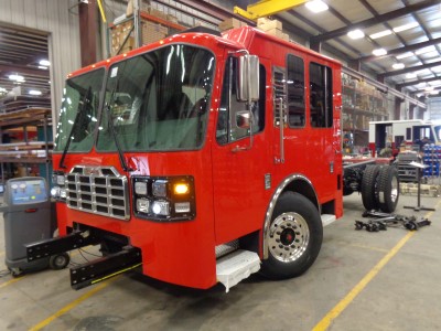

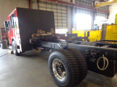

Updated photos 5/26/2015: The chassis is essentially complete and has been moved over to the body fabrication facility. Note that the front bumper has been coated with the rhino-liner like spray on material, in black. It looks pretty good, I hope the stuff is as tough as they say it is.

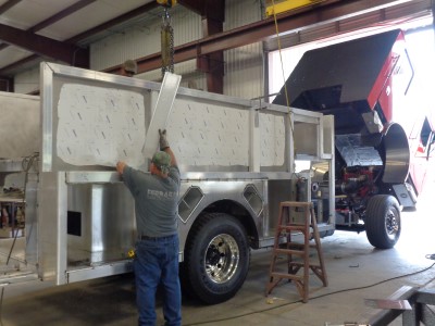

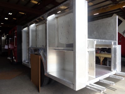

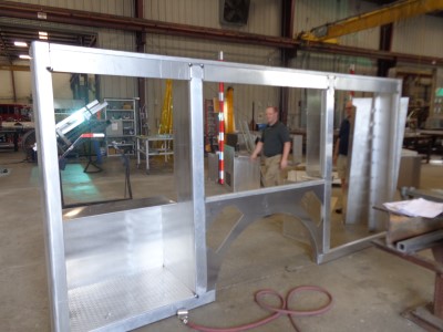

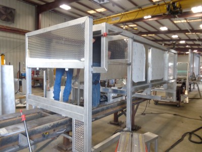

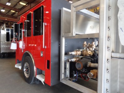

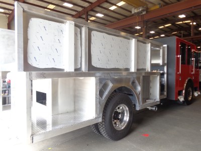

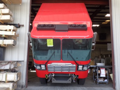

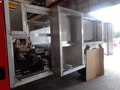

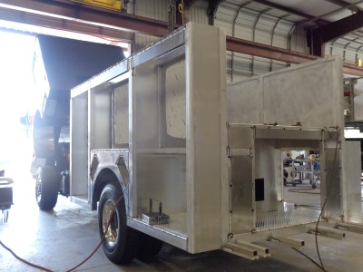

UPDATE 6/16/2015: The majority of the chassis is complete. Some of the valves and fittings have been installed onto the pump. The chassis has been moved over into the body plant. The framework of the body has been assembled, and will be dropped onto the chassis very soon. Final Inspection is tentatively scheduled for July 22/23. Delivery early August. All photos courtesy of Ferrara Fire Apparatus, Inc.

Was there any discussion about compartment doors? Traditional swing out vs. roll up like a soda truck
Lemme...lemme ...lemme axe you a kestion
See post #8. Roll-Ups.
squeezing 450HP out of an engine originally designed to be 8.3 liters scares me. But I guess Cummins knows what they are doing.
I concur. I wanted to go for the ISX instead of the ISL but the upcharge would have put us way over budget.
Generally the theory is that most fire apparatus will be a relatively low mileage application that will not trash an engine that is "reaching" for the HP they are tuning it to. In other words a fire truck will probably get less than 150K miles over it's lifetime and even a way over tuned diesel should last that long. We'll see.

Whats the pumper body, extruded or the modular one?

Body is extruded aluminum.
It'll last for longer the it will be needed. Good choice!
