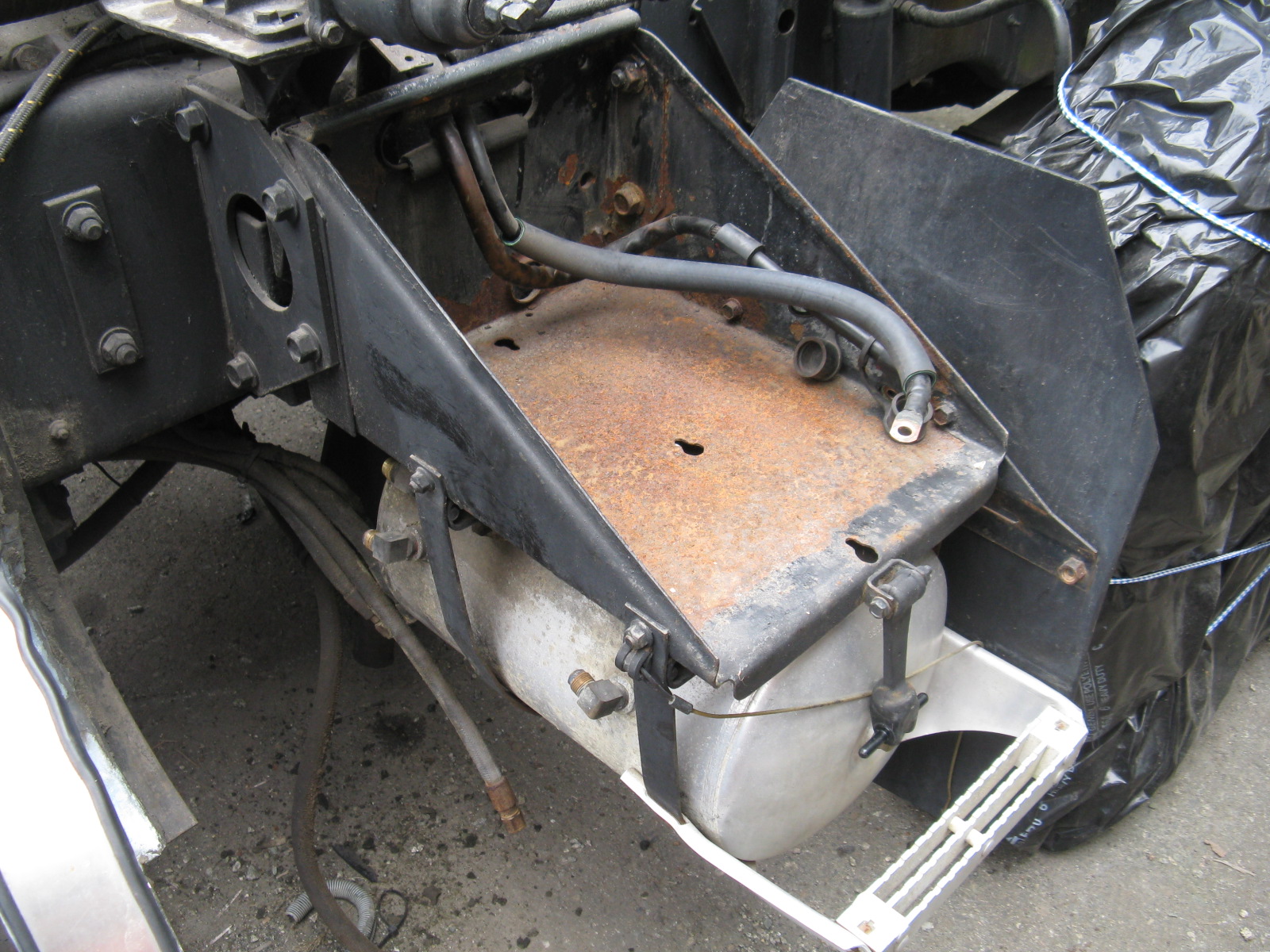

pic added of the good box from the other side, note, it has the angle reinforcements of the HD box in the PAI book...

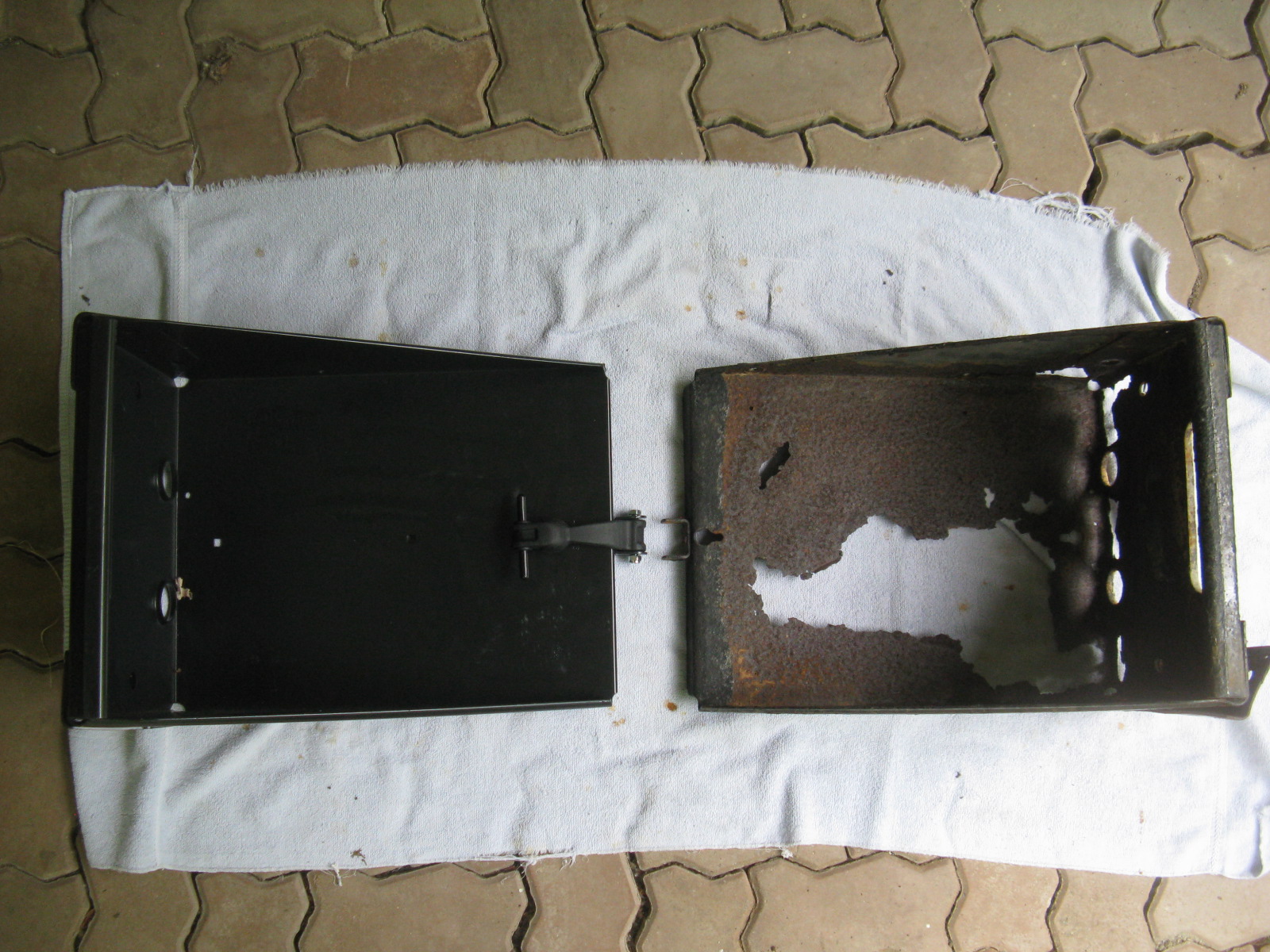

I looked over them on my trucks and both R and MH bottoms seem to me the same.
At least I can say 100% sure I took the alu covers from one to the other many times and they're almost the same, fitted perfect.
As I remember PIA had them cheaper than Mack. Don't know any difference in quality, they could be just from the same producent.
The one on the picture is a R-model.
And in relation to it yours is almost new :)

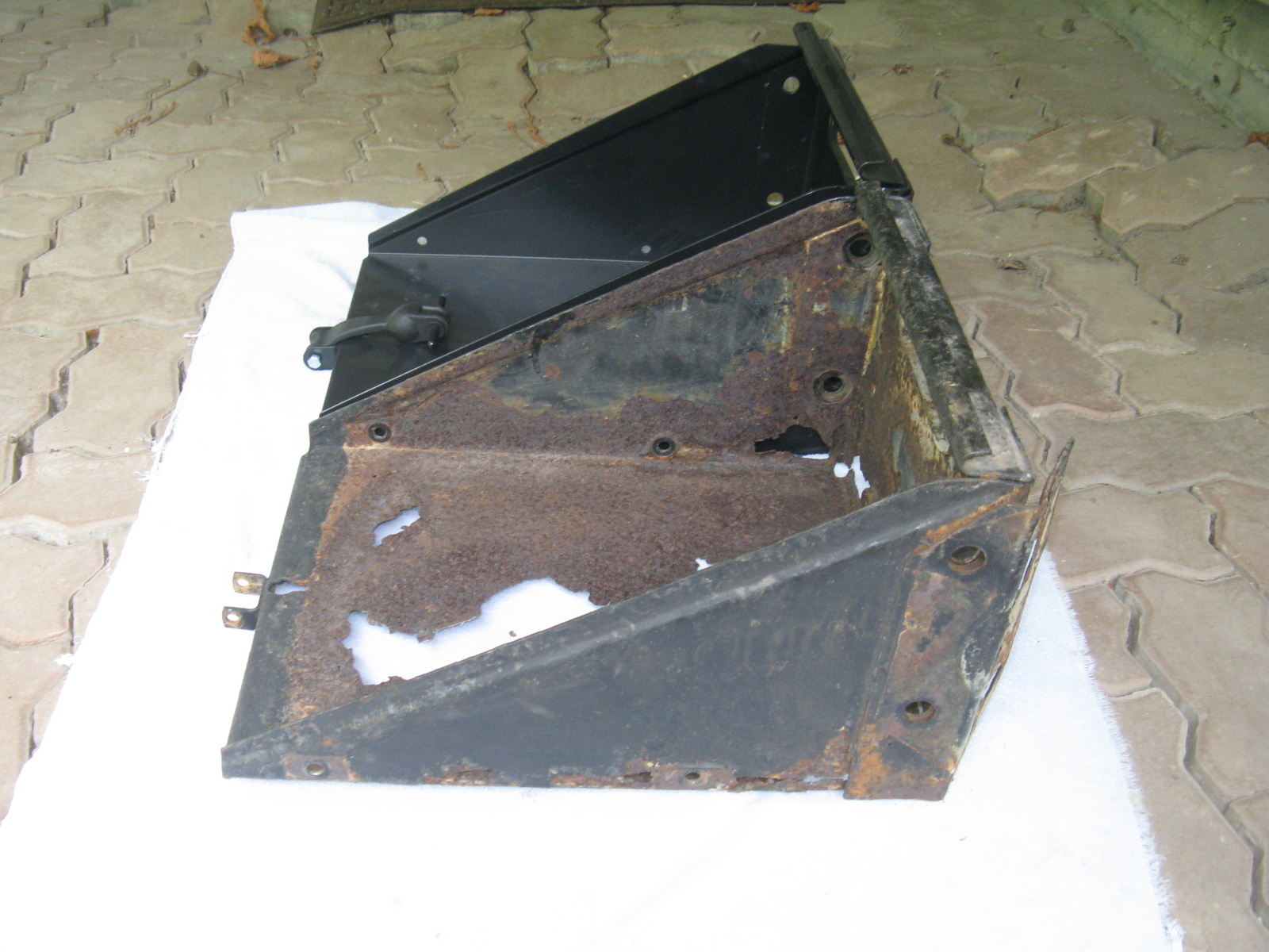

I made some check out today.
Basically both R and MH bottoms are the same.
A R-model bottom is fitted to brackets by the 4 holes in the end wall (wich MH bottom has either but they're free).
A MH part uses 4 holes in the sides to be attached plus 4 small holes along the bottom to fit air tank support strips (2 on each side).
Those additional holes don't take their place on a R-model box so you will need to drill them through if gonna use it.

there are two boxes in the PAI catalogue...
p/n FBB-4635 is a standard box with no angle plates and has no holes for side mounting on an MH
p/n FBB-4986 is a "heavy duty" box with angle plates and side mounting holes, the photo also shows the holes for air tank straps
I have added a photo of the installation on my MH
I'm wondering if PAI have made the HD box more universal than mack...

BC,
Your MH box installation is almost the same as on my MH613 of 1991.
The R-model I have has no additional holes although I have the only only two absolutely identical R's.

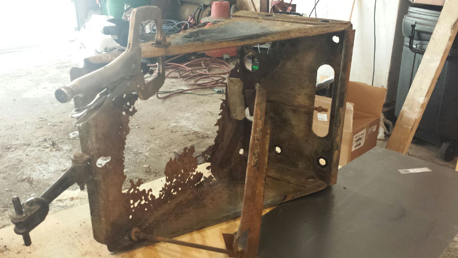

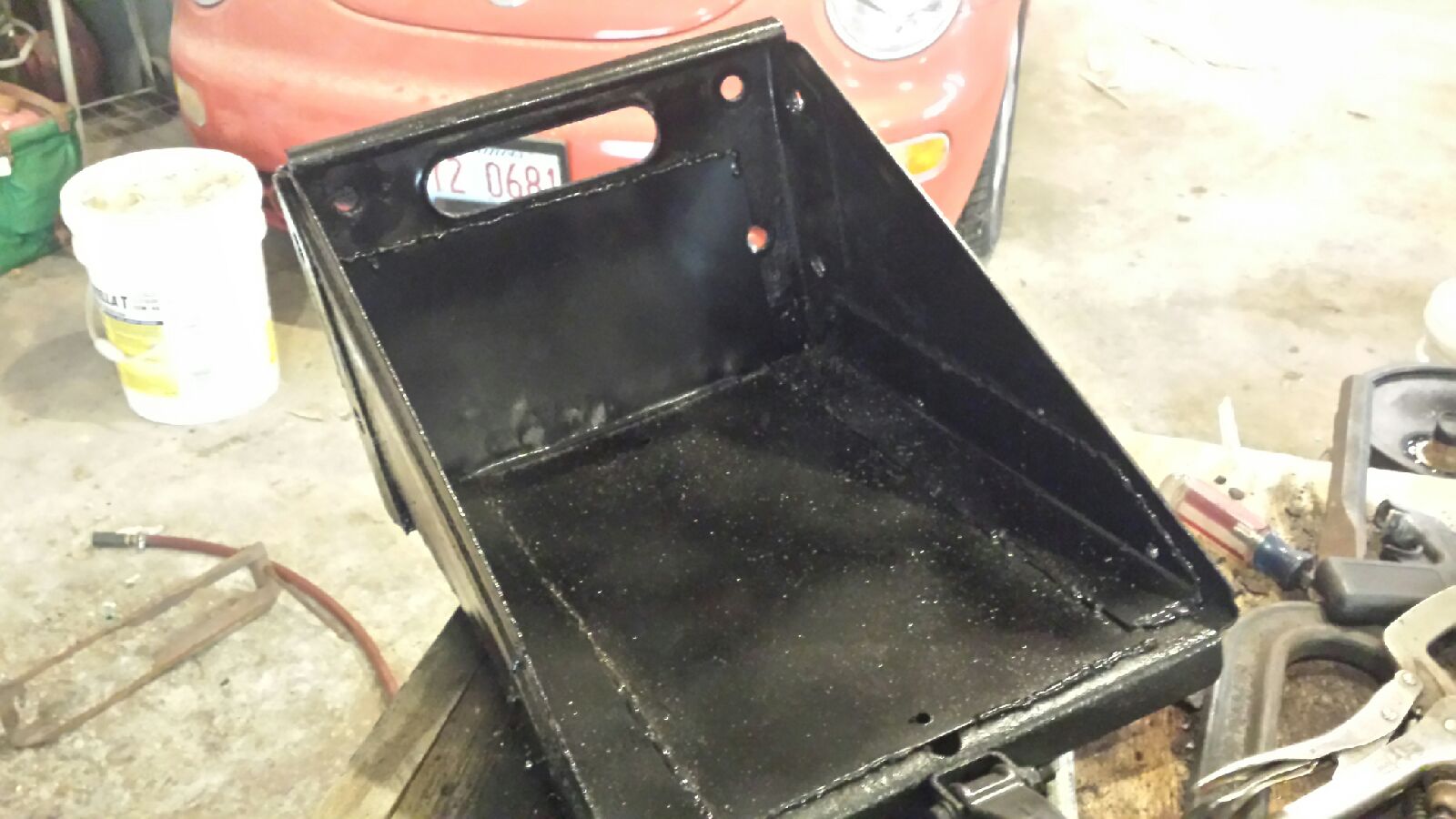

Looks the same as what's on my superliner I rebuild both back in February because the driver's side decided to rip because the bottom was gone and being hidden by part of a mudflap. Think I spent 30 bucks in steel and paint and a day welding
post-17190-0-31712200-1431698163_thumb.j
post-17190-0-32676300-1431698178_thumb.j
IH... my left one was in worse shape than yours once I got to poking it hard with a hammer... a fabricator told me he could do it for less than new, but not much less.... so, for a few dollars more I'm going for new.... my MH is a gradual restoration not a quick fixer upper so the box will even get two new batteries too...!!!!

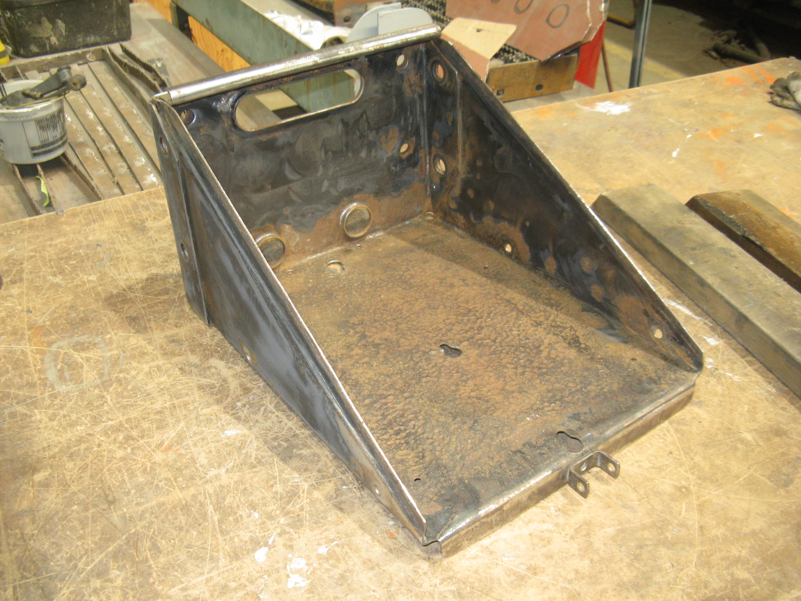

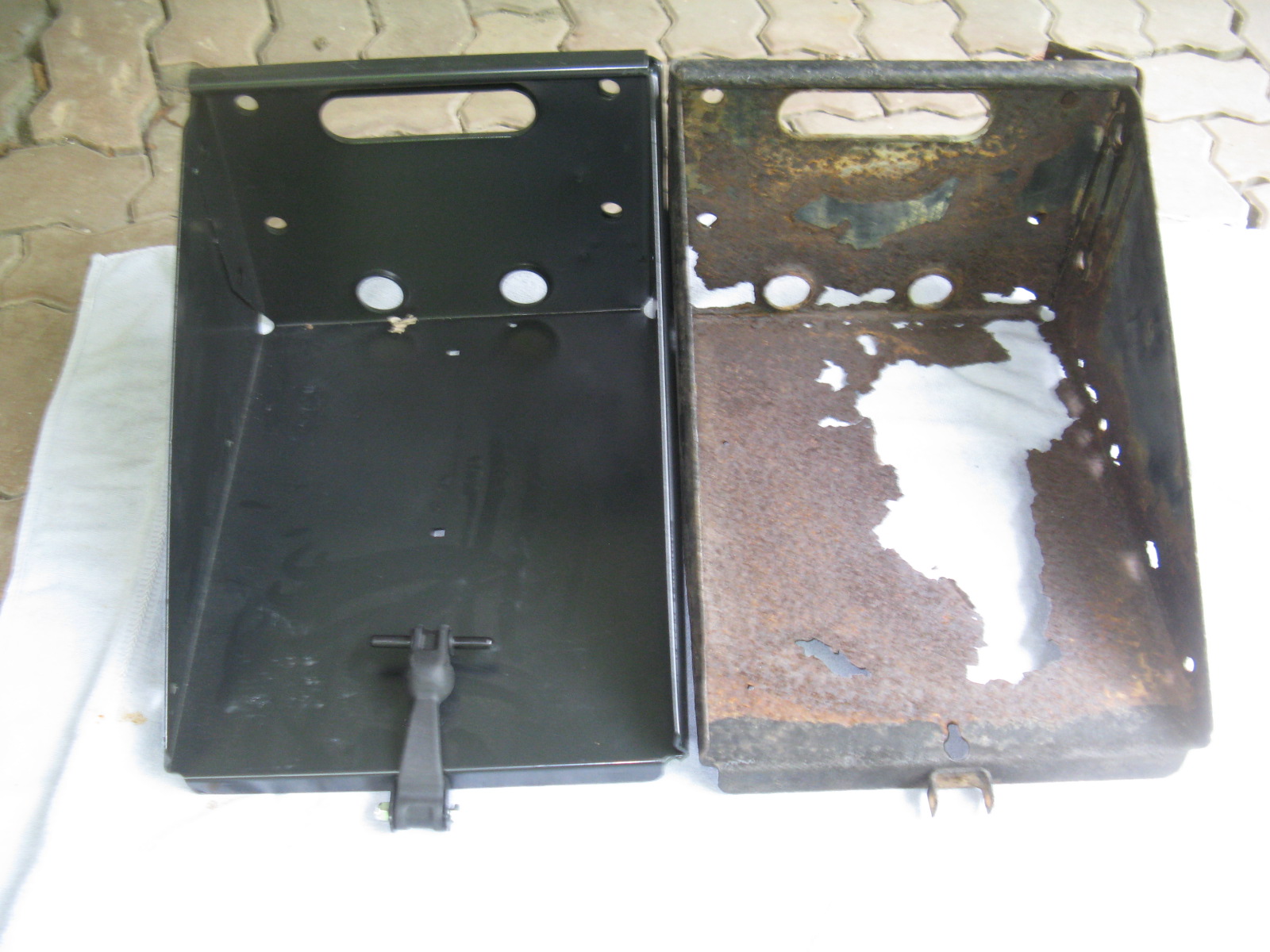

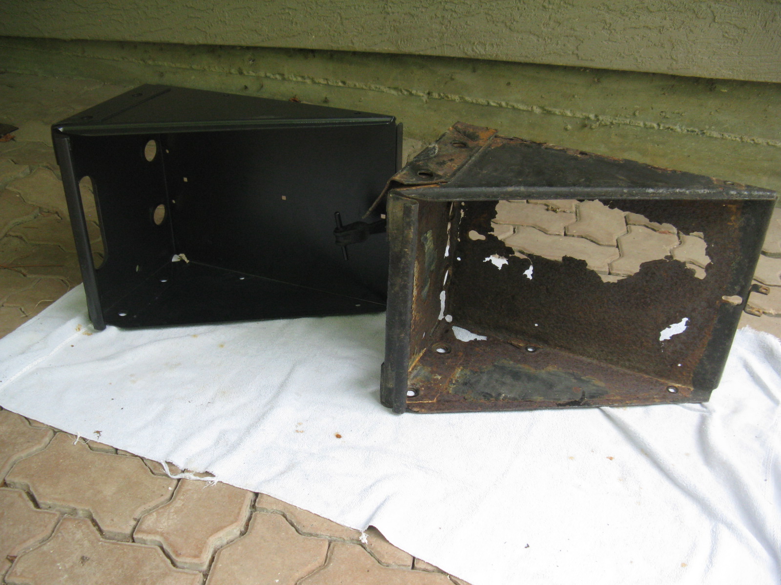

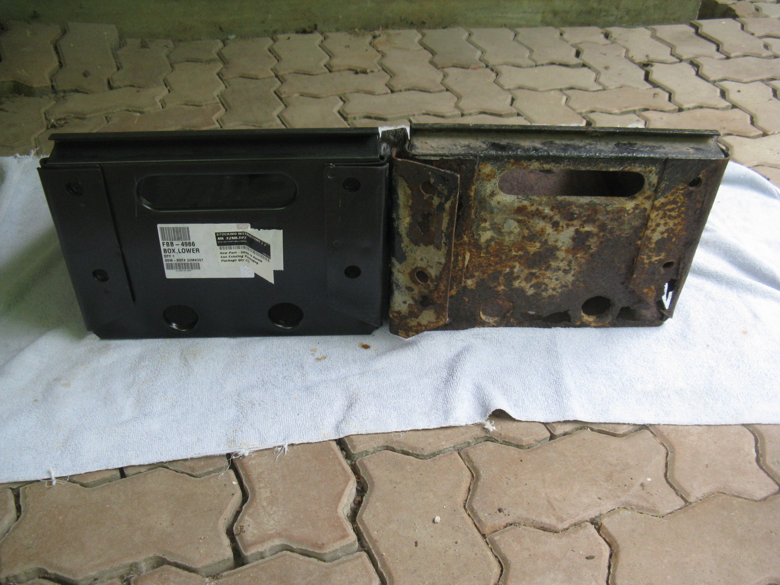

I got the PAI lower batt box delivered today and did a basic check to see how good a fit it will be on my MH... so far it looks ok, the side mount holes line up, external dimensions seem the same, the small holes for the tank straps are there...
some very minor differences... battery tie-down post hole is square not keyhole, not an issue for me.... and in order to install the airtank the plastic? supports above the tank have a small dowel at each end which is needed for correct alignment, a small 3/16 hole needs to be drilled to do this... paint needs re-doing but that's just me..!!!
it is not a Mack part, the "4986" is stamped onto it...
next weekend I will take it to the truck and do a fit check in the mounts and check the fit of the lid..
took some pics of old and new together..
BC Mack
post-10384-0-62968800-1433378382_thumb.j
post-10384-0-13135600-1433378417_thumb.j
post-10384-0-39328100-1433378454_thumb.j
post-10384-0-63328100-1433378483_thumb.j
post-10384-0-35208500-1433378515_thumb.j
Looks like about a perfect replacement.
I agree on the need to repaint. You never know what they applied on it but see quite good how the original "rust protective coverage" is gone long ago allowing the steel to fall into pieces.
Was the rubber latch a part of the set or you bought it separately?
