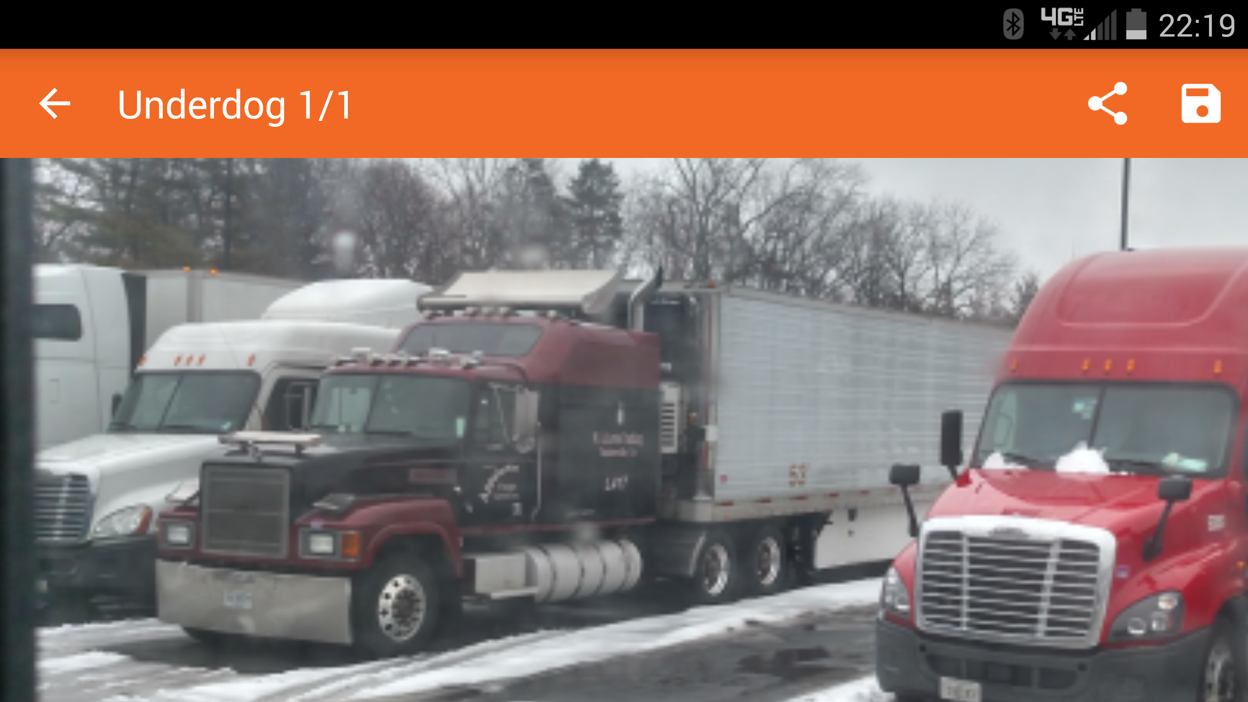

Here is me and my friend loading at the same time. His is on the left, '97 and mine on the right is a '12. Not much changed.
post-13203-0-64509800-1431657895_thumb.j
post-13203-0-19881400-1431657908_thumb.j
post-13203-0-21361800-1431657933_thumb.j

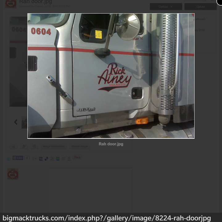

We had a 06'SFA Rawhide CHN. From factory with a 460XT ASET and ran a 5" exhaust up the sides between the cab and sleeper. If I remember correctly the sleeper seemed to be mounted higher as the trim on the lower portion of the bunk was different and larger. I have a picture in my profile photo gallery of the door and how the exhaust comes out from under.
