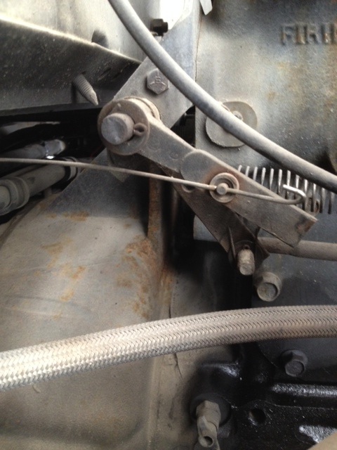

I've been working on my throtle linkage problems and I've got a question.
When I adjust my linkage out enough to get full throttle I have trouble with a high idle because the linkage is hitting the firewall and not falling back enought for idle position. Is it supposed to do this or can i trim the linkage to where it will miss the fire wall?

Allow me to answer my own question in hopes it helps some poor sap in the future.
You can cut this linkage, but you will shorten the push length and it will have to be gained back at the throttle linkage wich put me back at square one. I'm not liking the way my throttle linkage is set up! If anyone has got a pic of the way there's is set up I'd appreciate it. I'll probably re-fab this one and try to make it better, need some ideas though. Thanks

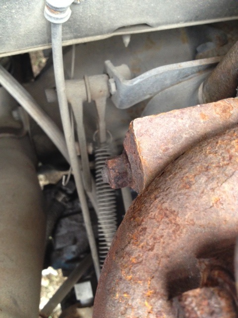

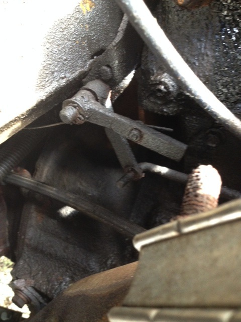

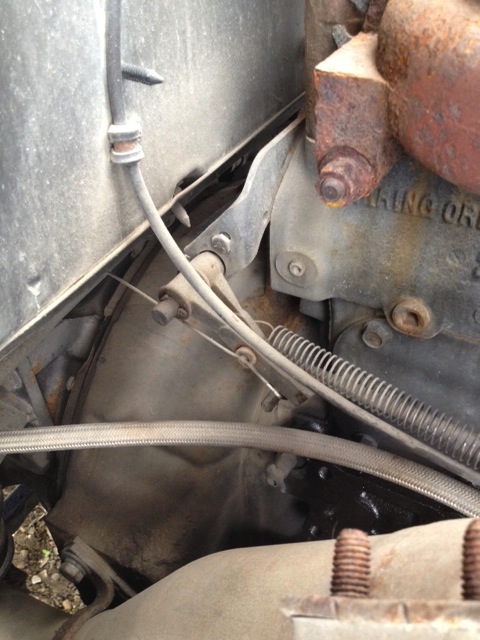

Sorry I didn't see this earlier. It would have saved you some grief.
The dirty, oily linkage is on my 237. keeping everything well oiled is what has kept it good for 30 years of being in salt.
The cleaner linkage is off a 350 4V . It appears to be the same, and a lot easier to get close pics.
I think this will shed some light on your troubles. If you want any other pics, or from a different direction, let me know
Don't let the spring in the 350 pics confuse you. Its not factory. I find I have a lot nicer pedal with 2 long springs (one there,one on the pump), instead of the 2 factory springs .

Thanks for the photos! That helps shine a light on things. It's hard to figure something out when it wasn't right to begin with.
