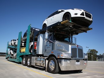

This all sounds great on paper but what does it mean out in the real world? We found out recently after climbing behind the wheel of a near new Kenworth T359 recently.
The Kenworth belongs to Prix Car and was retro fitted with the Allison on delivery with the old Eaton box getting the flick.
The beauty of this application is that the single trailer car carrier runs at 36 tonne gross, which is exactly the same as the American on- highway weight limit.
And this is the first TC10 equipped truck in the country.
When we caught up with it there was a full load of cars on the back to give us a real world indication of what this cog swapper was about.
Inside there’s little to give away what’s going on under the 359’s narrow floor. An Allison selector pad looks right at home. The 450hp Cummins ISM fires up and I hit D for drive. The result is quite startling and quite unlike any other truck I’ve driven to date.
