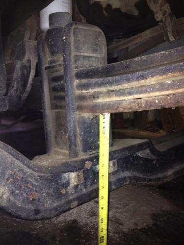

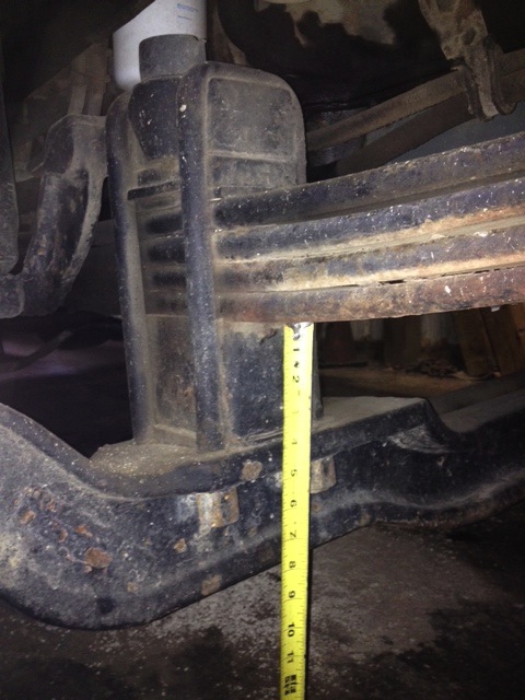

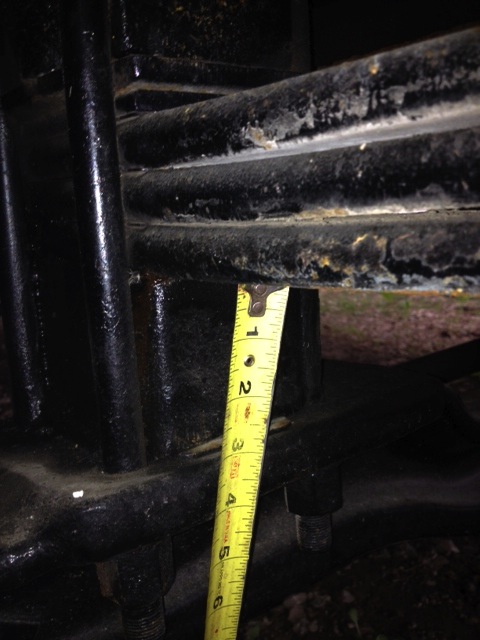

1988 R688 with 14,300 front axle - 3 Leaves …. 3 inch block
post-17364-0-17300700-1435020784_thumb.j
1986 RD688 with 18,000 front axle - 4 leaves……4 inch block
post-17364-0-21024700-1435020805_thumb.j
I'm 98 percent sure thats how both trucks cam from the factory. In my opinion, they both sit perfect.
