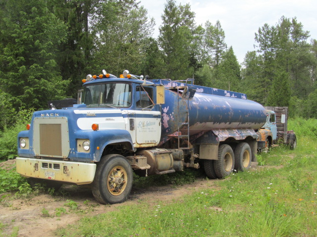

Mine is a water truck, 4000 gallon with a PTO pump (which has a broken driveshaft at the moment) I'll get pics up this week.

these fellas on here will be waiting for photo's
