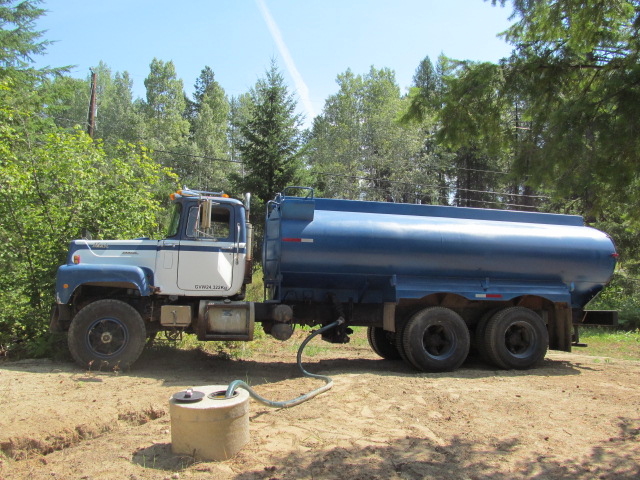

Here is a picture of the truck performing its first paid job
