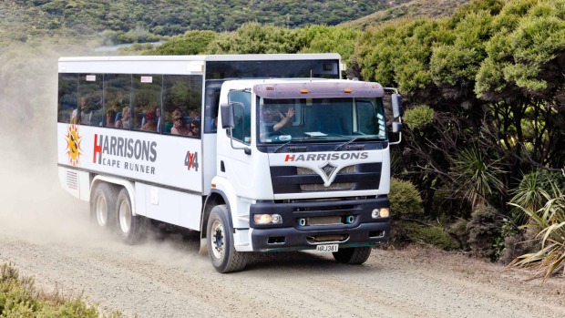

The Harrisons have owned a succession of Toyota, Hino and Isuzu buses as well as Unimog 4x4s but despite having their own workshop and panel-beating facilities found none could be kept on the road for more than five or six years.
An alternative approach began with the purchase of three 2004 model 8x4 Fodens that were ex-Fonterra milk tankers, all of which were mechanically sound despite all having more than a million kilometres on their clocks.
Driveline components such as the Cat C12 engine, 18-speed Roadranger transmission and Meritor double drive axles all checked out, although these components are common to many heavy trucks and replacement units can readily be obtained.
Basic but functional 36-seat bodies for two of the Fodens were constructed in Harrison's own workshop based on a wealth of experience gained from other manufacturers' designs.
Simplicity, strength, safety and corrosion resistance were key objectives, met by a sturdy framework of zincalume coated box section steel covered by impact resistant aluminium composite sheeting. The build process was done in close cooperation with a local design engineer who oversaw construction and stability testing.
The body sits on its own sub-frame with heavy rubber mounts allowing for chassis flex. It has a separate air-conditioning unit, powered by a three-cylinder Toyota diesel engine, and can be readily lifted from the truck chassis if needed.
Building a bus on a heavy duty bogie drive truck chassis might seem overkill but seems to work well in this application.
Murray Harrison pointed out the Foden single skin chassis will make it easier to keep rust at bay and the on-board lubrication system, originally specified by Fonterra, keeps sand out of critical components.
The biggest changes needed involved the removal of the second steer axle and fitting of 'super single' 385/65R22.5 tyres on alloy wheels all round.

The Foden happily settles into a 90kmh cruise at around 1500rpm, managing most hills with just a slight deepening of the exhaust note in top gear. With an all-up weight of around 15 tonnes, Jason needs only about six of the 18 available forward ratios, with the Cat engine brake easily holding speed back on downhill sections.

On better sections of beach, the Foden sits readily on a governed 90kmh as we head southward a couple of hours after high tide. Jason points out that the six-wheeled configuration and big tyres fitted do not compact the sand as much as conventional four-wheeled buses we follow along the beach.
Ample reserves of power from the Cat C12 reduces the need for gear changes on soft sections and the only time he requires low range and to lock up the drive axles is for our exit from the beach at Waipapakauri.
