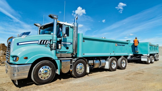

The unit on test had just clocked up two months of service in a demanding HPMV operation with Fulton Hogan in Christchurch. It is double-shifted, hauling aggregate to their inner city retail depot and back loading concrete rubble and demolition spoil to the quarries out of town. The Trident pulls a four-axle Adams and Currie tipping trailer with HPMV approval to operate this combination at 53.8 tonne gross on the agreed route. Tare weight of the Mack is 11,820kg and the trailer comes in at 6280kg providing a payload of over 35 tonne.

That second steer axle lifts the manufacturer's GVM of the Trident from the 26 tonne of the six wheeler (tested last year) to a productive 30 tonne.
The six wheeler Trident is offered in both 'axle forward' and 'axle back' configuration and this 8x4 version uses the later configuration with a second steer axle behind the cab.
A non-load sharing set-up is standard for the New Zealand market and will suit most operators until NZTA offers an additional weight allowance for load sharing systems.
The second axle is steered by a relay arm set-up and slave hydraulic cylinder on the right hand side.
The standard wheelbase of the 8x4 Trident is 6435mm but the Fulton Hogan unit has been reduced to 5835mm to meet the requirements of the HPMV permit and retain manoeuvrability in tight situations.

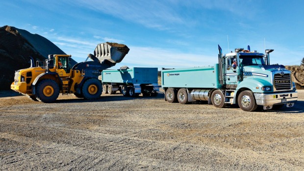

Once our tyre troubles are sorted, it is time to get loaded up for a run into the city and the company's 35 tonne Volvo L250G loading shovel soon has us loaded with 20mm aggregate.
The skill of the operator and use of modern scales makes this task far more accurate than it used to be and we come in at 53,200kg on the weighbridge, slightly under the 53,800kg allowed.
Chris explained there is no tolerance allowed on the HPMV permit and if overweight he would not be allowed to leave the site.
