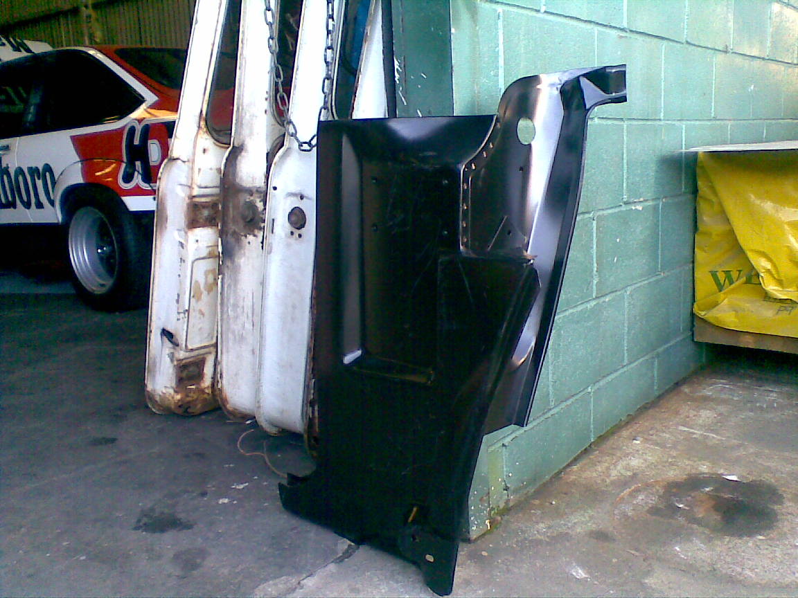

Where are you finding these repair panels?
Thanks,
Paul Van Scott
Hello, a Mack dealer in Australia. but you have to get a parts guy that knows how to look in a book and cross referance and then translate to another number and go on a computer. i am dealing with a shop in Brisbane.
most cant do that, they want a chassis number, then when they punch that into computer it says to old and they say sorry cant help.
that panel pictured is about 500.00AUD and there is a heap in sydney. there is also a brand new cab in sydney for 34,000.00
have 3 more panels to pic up today

That's about right Grant. The last passenger side outer skin panel that I bought was $430.00 about a year and a half ago.
That panel looked OEM by the photo. $34,000.00 for a new cab??? Someone really wants to own it forever!! Probably wants to be buried in it too.

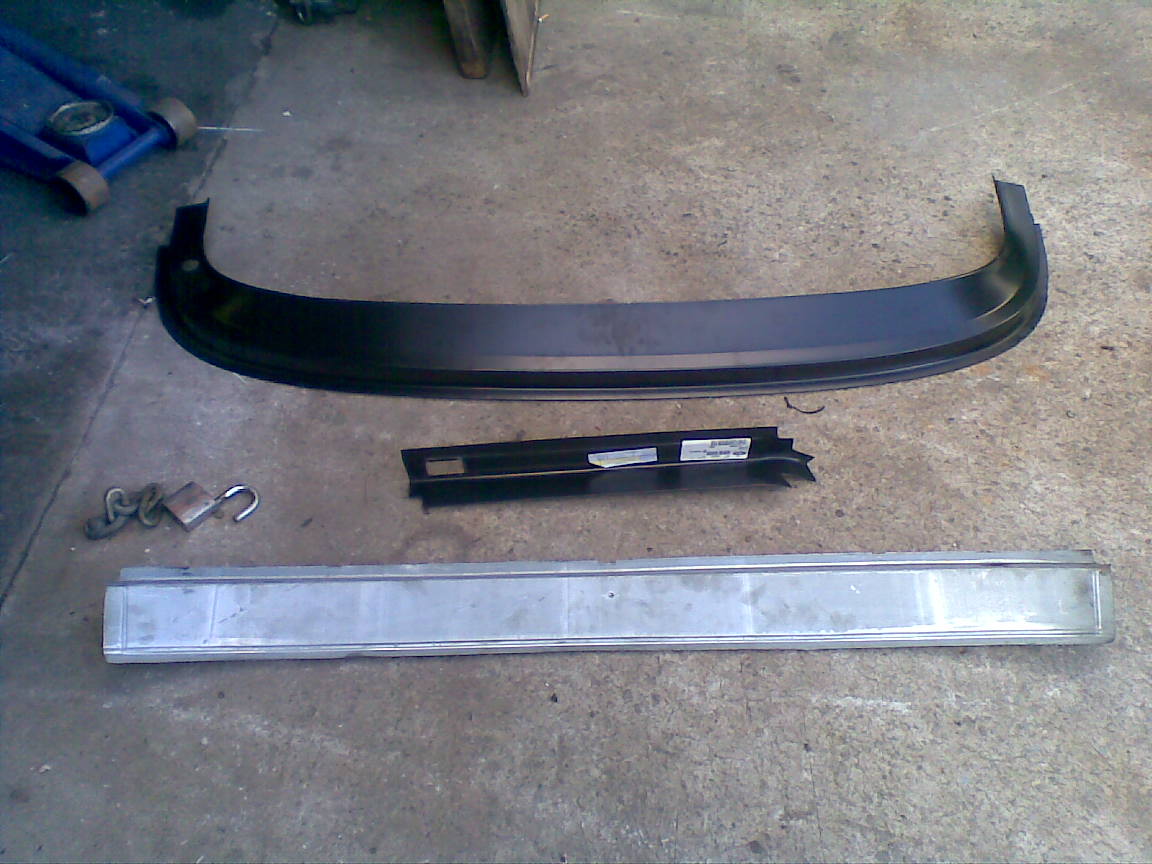

Hi Grant, I recongnize the inner roof support above the sunvisor area(s), and the floor stiffener but what is the part centered between the two?
I've never bought one of those before.
Rob
hey grand do not use all the parts by yourself.mayby i need some of them for my cab.lol.
The middle item is the inner section above the door, when you open the door and look up at cab, thats what your looking at.
i need all these panels, but more are available, just let me know what you want and i will price it for you.
Grant
Grant
Ahh, yes. The orientation of the part in the photo is not how it is mounted onto the perimeter of the door aperture opening. I've never had to purchase one of those, always made them.

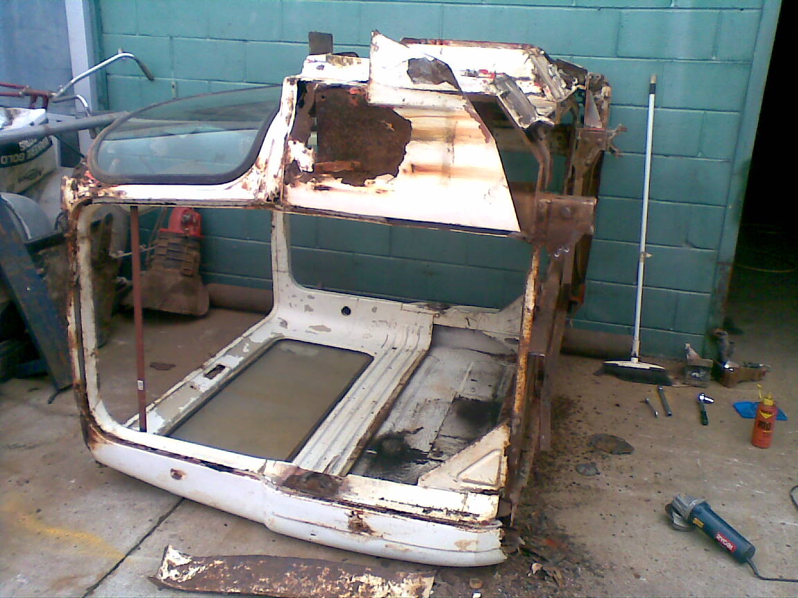

started cutting out the rust on right side today. am running out of cab. will have a new inner and outer sill soon.
youll have nothing left if you keep going at this rate, why dont you just pretend you are in england build the cab out of timber frame then put some tin sheeting on the outside, it worked for them !!!!! :P
thats a thought, but um unfortunately the Cutty Sark burnt down, so wiill avoid wood. I um got a phone call today someone looking for a cab for his R model because his had to much rust in it around the top. :D i tried selling him the flintstone cab i have but wants a plastic dash cab, he is going to chabge his mind when he sees how bad this cab is an hopefully fixs his.??
Grant

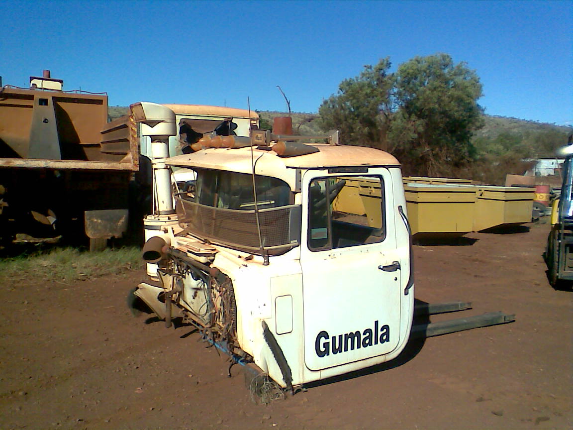

Hi all, I just bought another cab, this one has no rust at all. it has come off a 1989 valueliner, they are scrapping the truck because it dropped an engine and has done a million kays and pretty much worn out. they are now using it as a parts truck.

Hello, no worrys, looking forward to the call. i am turning the flintstone R600 into a R700, using the diffs and motor and front axle out of the F model I had, I take it you saw the flinty tucked away around the side of the panel beaters?
the cab I have outside is now for parts as I bought a Valueliner cab for 3000 that had no rust in it, i couldnt repair that other one that cheap. i am building an Australian version of the Ducks truck from convoy with twin stacks and aircleaners.
