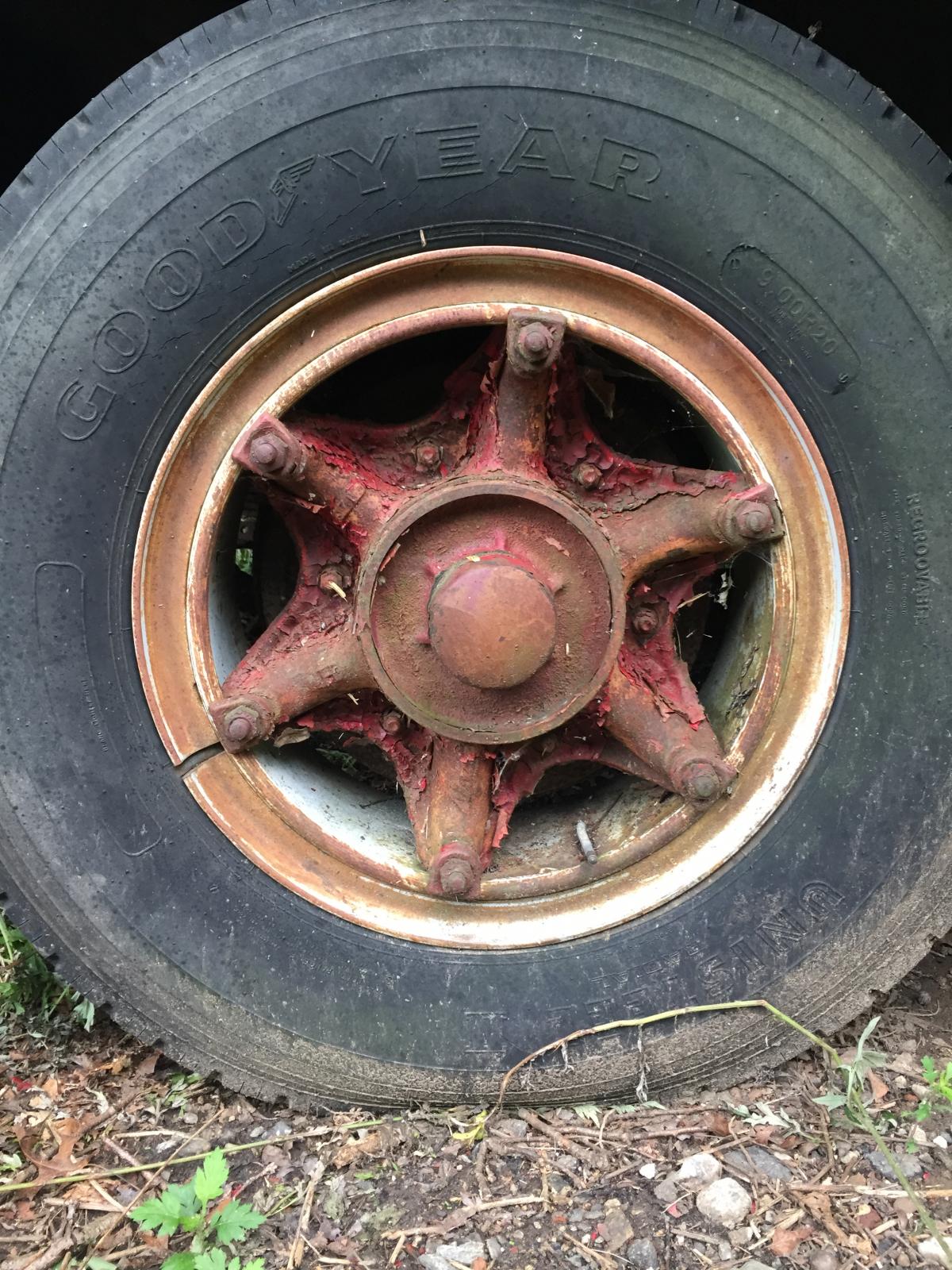

Matt, thank you. I may reach out again when I have the paperwork in my hand to ask for a bit more advice. I haven't figured out how to post a picture here yet, but will put some up soon. It is a B-42X with an 18 spd. I got it running and drove it back and forth a bit a few weeks back. The brake and gas pedal are corroded solid, I have the replacements and need to make a temporary fuel system (and some time to go visit the truck again).
My next question will be regarding what appears to be split rims on the front. I aired them up to 45 lbs but would appreciate guidance on how cautious I need to be around them.
With rust and the age of the rims, I would advise extreme caution. One memeber had the rim on his F model come apart from rust where water collected from it sitting. He was lucky to be "only" cut and bruised, could have lost a limb or his life quite easily.
air them down when you remove them and I personally would look the rims and lock rings over very closely for any damage or deterioration. Paul
https://www.bigmacktrucks.com/topic/41107-dmv-exemption/#findComment-300120
These were at 20ish psi when I found them and I aired them up to 45. I would like to add more unless that sounds like a bad idea. Primary focus now is just making the truck self sufficient enough to load/unload and pull into driveway. Maybe air them up with welding gloves and a motorcycle helmet?
