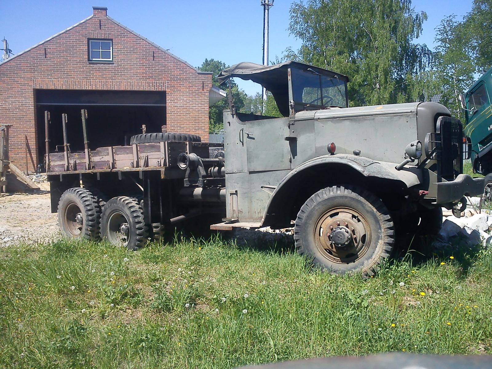

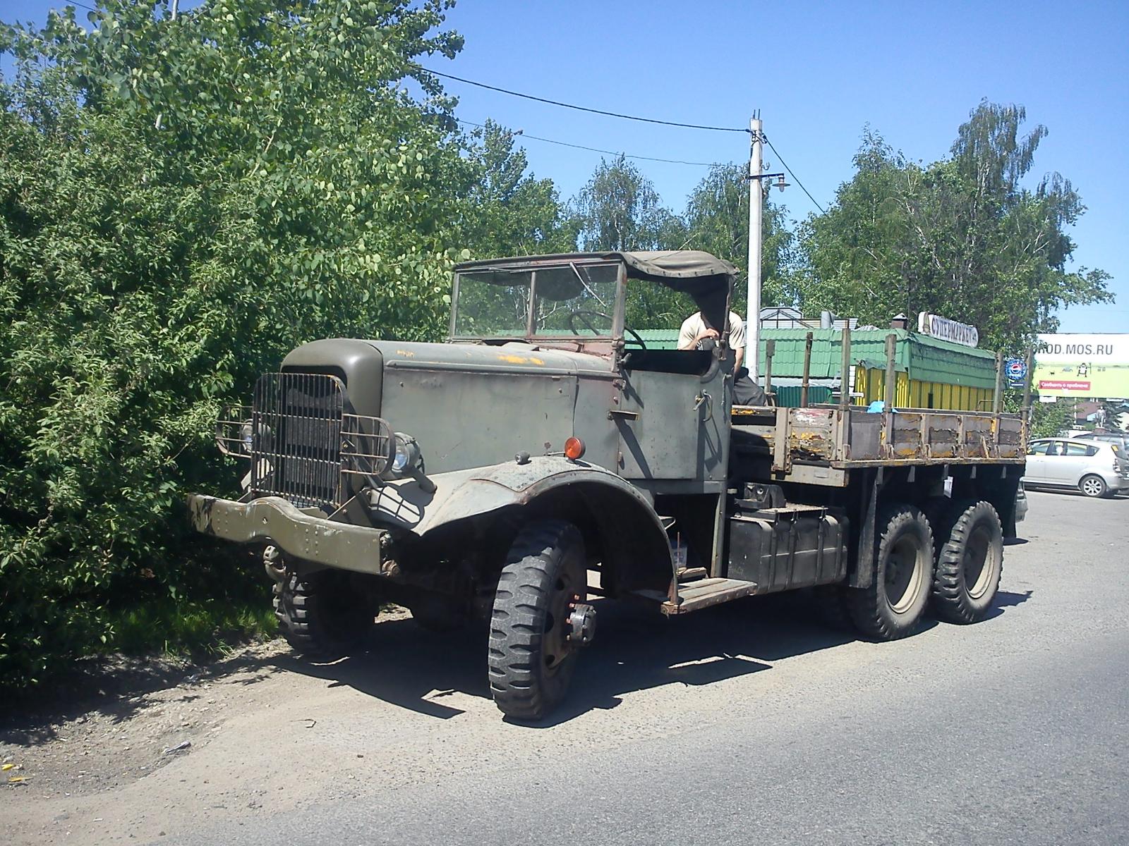

These ones left factory between 1942 and 45. Still hold pressure well. I'm not in much trust to the fronts to drive down the road though so think about a swap to 22.5 radials.
post-3971-0-91885600-1439589572_thumb.jp
post-3971-0-07524200-1439589600_thumb.jp
