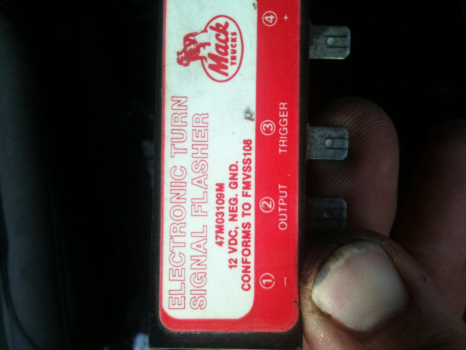

Grote makes a 12 lamp Electro Mechanical flasher. Part number 44540. 12 volt 25 amp meet FMVSS108 standards. 3 wire with out the ground lug for 6 lights per side.
There is a 1 800 number or live chat for answers on using it.
http://www.grote.com/products/44540-12-lamp-electromechanical-flasher-flasher/
The electronic turn signal flasher was a factory option.
The Mack part number is shown in the picture.........47MO3109M. Give the good folks at Watts Mack a call.
Watts said the part # is good, but they checked their entire system and they're aren't any around anymore... and you're right, evidently it was an option... I was hoping that the 'other' 'standard' model was available. IF, I could get a part number for that one... maybe it would work in its place.
Contact the Mack Museum. Perhaps they can tell you the original vendor and part number.
That's a good idea! :thumb:
I'm trolling the website now....
We used to call that option "Transistorized Flasher"
Yes, that's what is on my wiring schematic.... "transistorized".... I can't help but wonder why they'd be an option for a flasher...??? All it needs to do is "flash".
Because of the longer service life offered by the optional transistorized flasher (47MO3109M in your case) some customers elected to pay extra for that option over the standard electro-mechanical type flasher (46MO212 3-prong / 47MO274R 2-prong)
