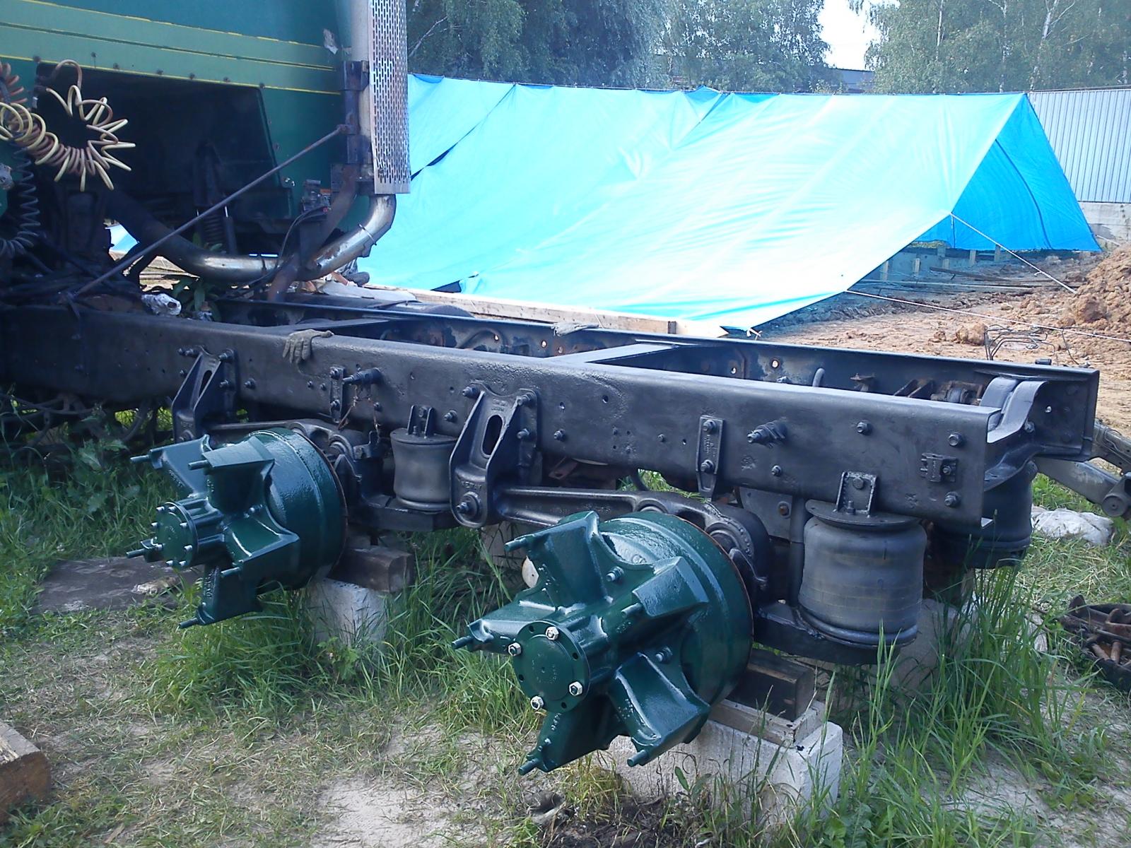

I started a play over my MH the other day, was going to put the hubs and wheels wich were laying painted for a while.

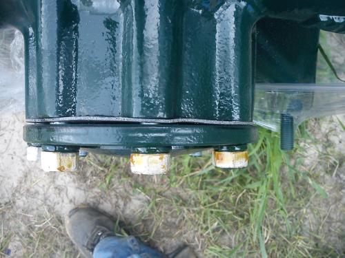

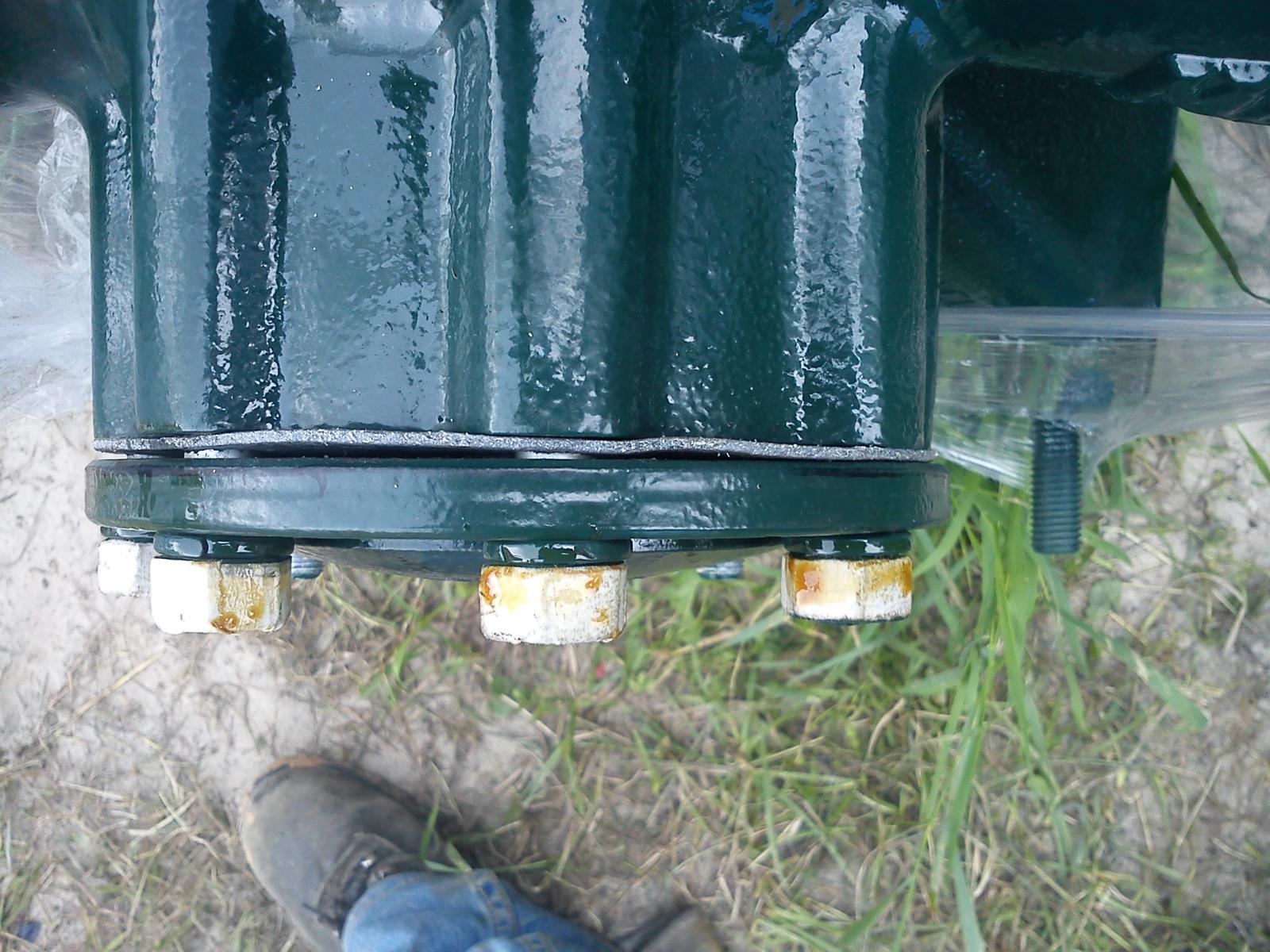

Did all 4 and got the jack shafts installed. When putting the flange nuts on I noted I couldn't fit one of the shafts almost in place. It touched hub's mating surface at some point and there was still the gap of 3-4 mm (1/8") at the opposit. To my big surprize I found out that contact point didn't turn over together with the hub but always stayed at the right of me - the direction front to the vehicle. That gave me a thought I wasn't glad to have.
Took the hub back off (and the opposite one) and looked through the housing...
I sure know i should swap the axle and I will do it in the future. Probably together with that strange "new style" Neway air suspension nobody could determine what it was. Although it's just a hobby truck. And the one I haven't planned to spend alot on in the nearest future.
I see no trouble about tyre wear since I planned to drive it for nearly 100-500 miles a year.
But I'm afraid it will ruin the jack shaft.
Any thoughts on how quick it could happen?
The B plan is to remove the jack and drive one axle only. I need to lock the power divider for that.
But it's a stock one, with no interlock. Does anybody know an easy way to lock it?
Vlad
post-3971-0-87002600-1438724163_thumb.jp
post-3971-0-37791400-1438724195_thumb.jp
post-3971-0-44966200-1438724232_thumb.jp

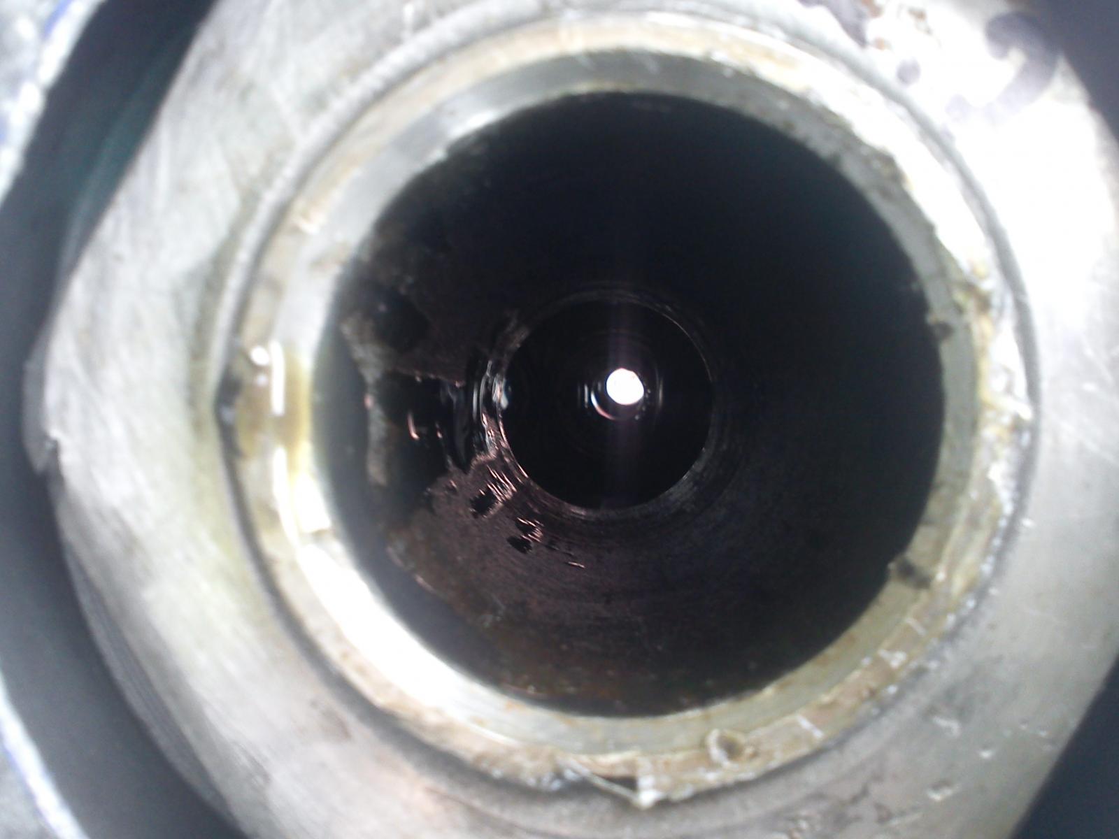

Yes, the housing is bent for sure.
After ovserving the axle shaft pay I resolved to pull the shafts out and saw a pear shape.
As I can see (and you can see it either on the last picture) the housing is bent to the rear and up.
Still wonder how the center axle could be hit so hard with no effects to the other parts.
I would say the tubes are both straight. Seems like the banjo itself is deformed.
