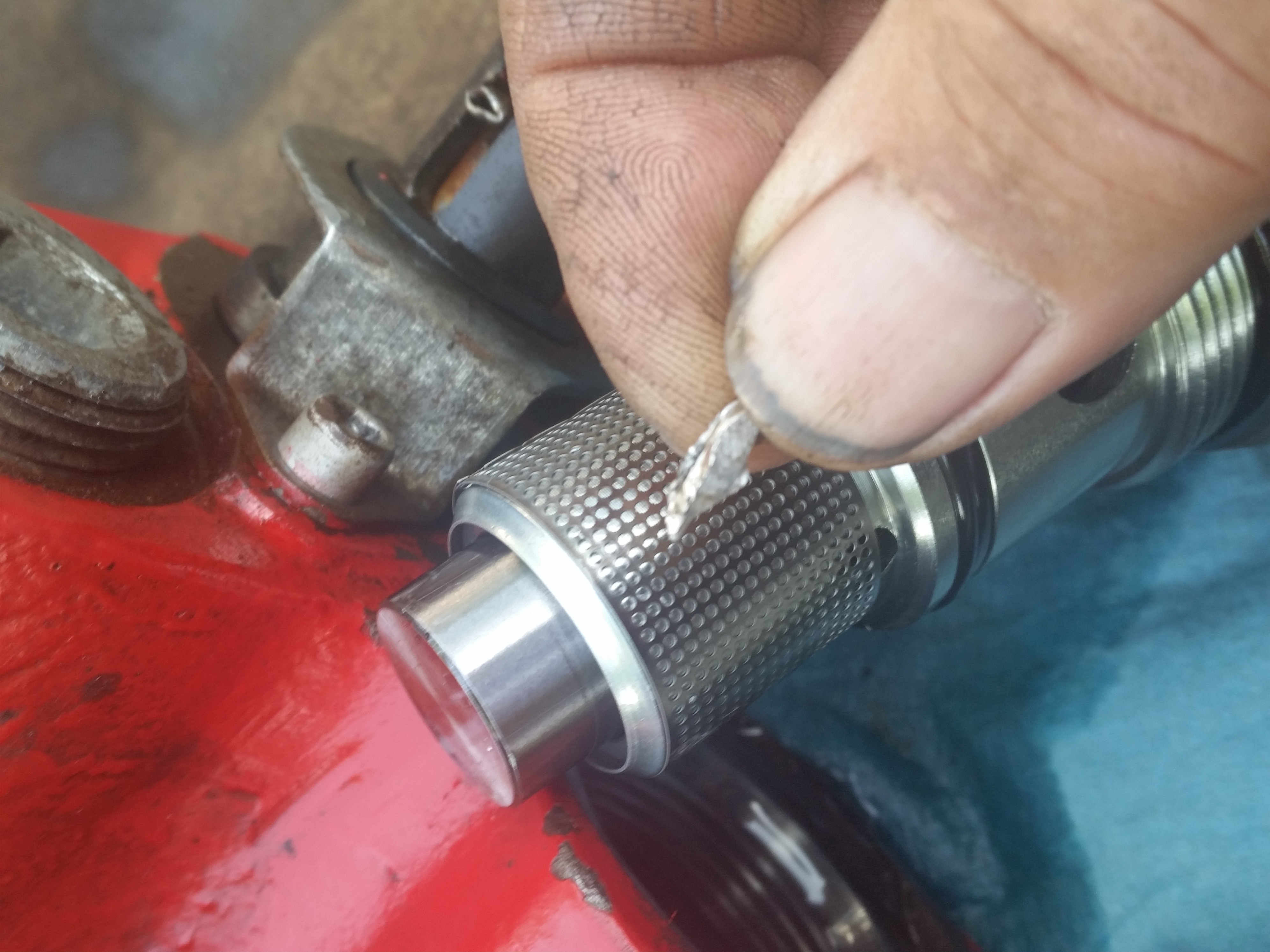

Its a side mount pto and Munchi hyd pump mounted to a Mack 12 speed.problem is all of sudden the body wont stay up loaded or empty,goes up fine but then slowly come right back down,the directional valve is moving freely back and forth when i move the lever,its air operated,thinking theres dirt or something stuck some where,but where,can i take something apart and clean it or should i take the pump off and bring it somewhere to be fixed,got to get back up asap,thanks for any help

Im sure its not the piston and the valve is closing all the way,i went under and taped it in the make sure,could there be something wrong with it like o ring or something,seems like its just not shuting of the flow.

i think you will have to remove the selector valve and see whats going on, it might be a broken centering spring if it was other debris in the system i wouldnt think it would lower. because the center spool land couldnt go past center.
Drained it out and dropped the pump,took out the selector valve and clean it and inside and also the pressure valve blew everything out with compressed air and also clean out hyd tank and re installed with new hyd fluid,same problem,so tomorrow I'll get a new pump and be done with it..
No filter,my fuel tank was converted to a hyd tank when i added a drop axle,thats where that piece of aluminum came from,I took the tank off and flushed it out good added all new hyd fluid,400 bucks just for the hyd fluid,nothing is cheap any more..lol
