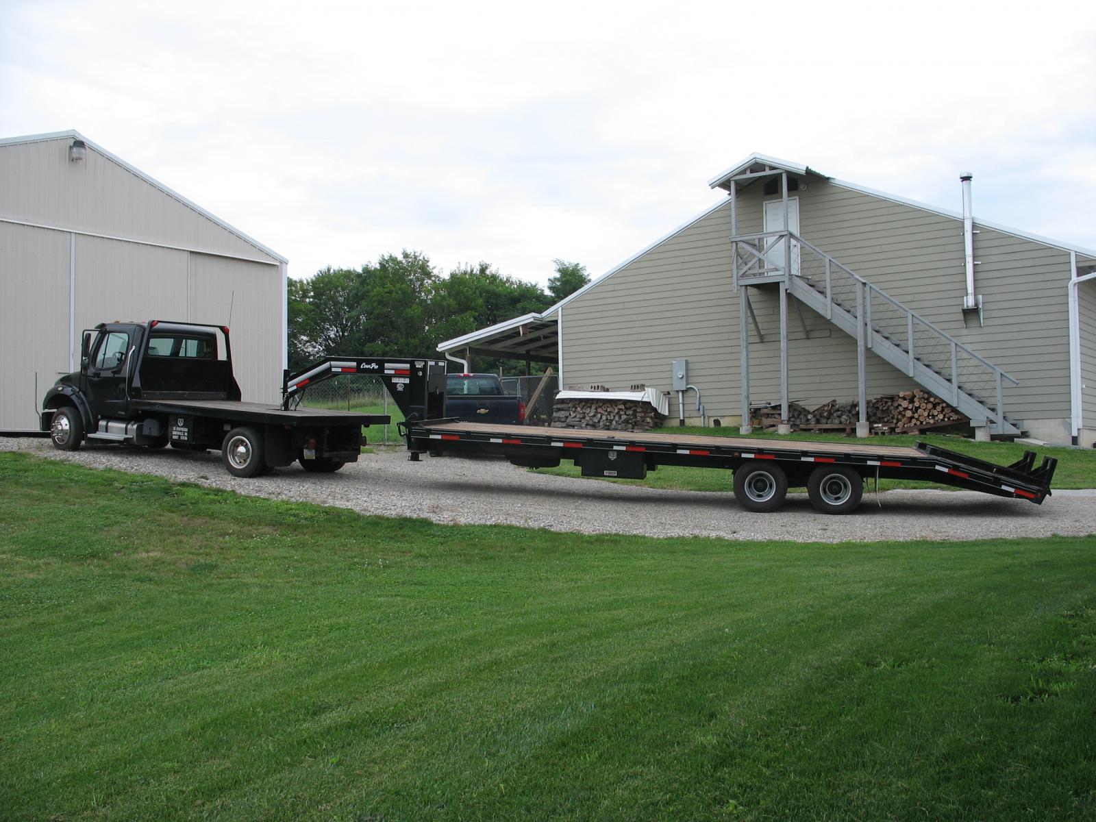

I do not think there is any good answer to this. I had Gulfwayinsurers on my Mack with Ohio historical plates and was allowed to pull a trailer. I was never near any scales but would have stopped. All states seem to be different and D.O.T officers in the same state will give different answers. A few years ago I had a 1 ton truck & 25' gooseneck and was stopped buy the D.O.T. in Indiana. All I had was an IFTA sticker. After I passed a safety inspection. The officer said you have four violations come back to the car with your paper work. I said I only haul my own stuff. His answer was "doesn't matter when you cross state lines with any thing with a GVWR rating over 10,000# you fall under Federal jurisdiction". I do not know where antique trucks fall under this but I would a get a CDL or medical card and paper work for a annual inspection which you can do your self. A log book is good. They pulled my IFTA sticker and sent my last payment back reason did not travel enough miles for all the paper work. This is what I haul with now and get pulled over sometimes but just get told to go on. I think if you are polite,have some paper work, and act like are trying things work out. I always scale. If they chase you it is not good.
