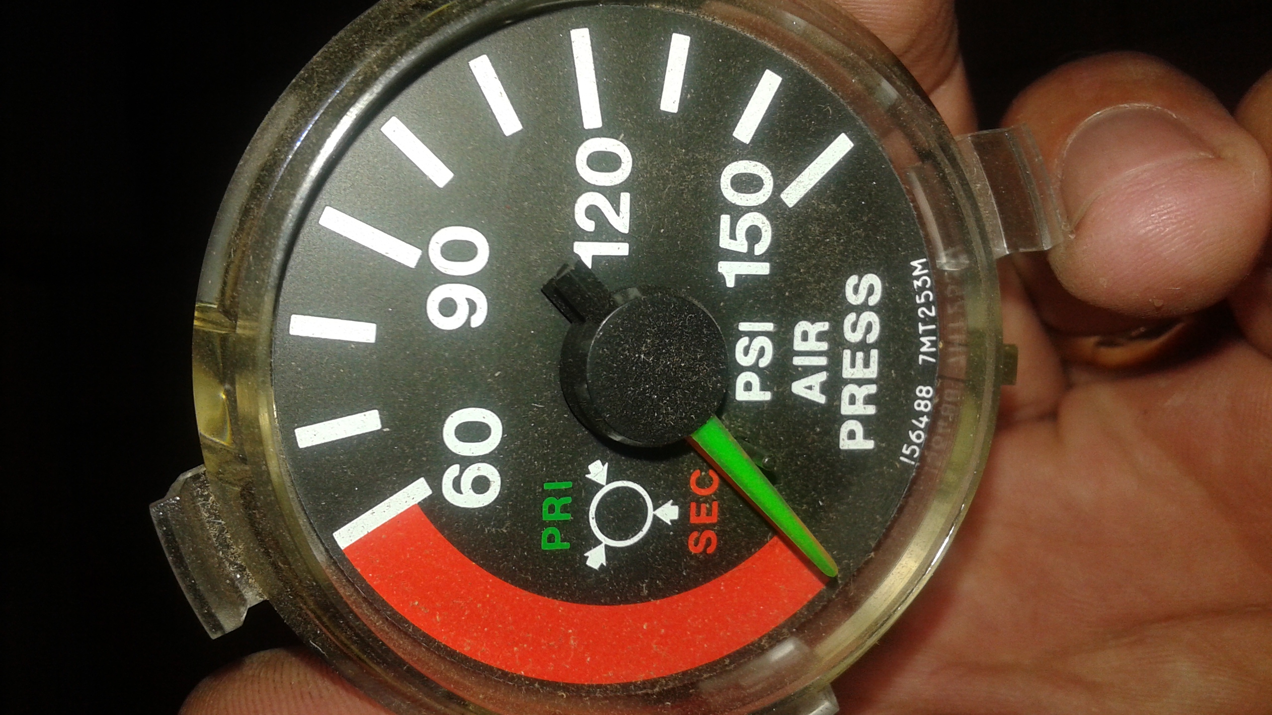

Anyone know where I can find brass quick connect fittings for the air pressure gauge in my CH.I changed the motherboard part of gauge cluster and air leaks from fittings after I unhooked and hooked them back up.Both air lines are very loose in the fittings and will stop leaking if I put a little pressure on them.Local Mack dealer said they unavailable.Even asked if we could order a whole new gauge.Any help would be appreciated.
https://www.bigmacktrucks.com/topic/41409-2000-ch-613-air-gauge/
If it is a compression fitting with the nut and collar you can get them at the local auto parts store in Brass nut and Brass collar or Brass nut and Nylon collar.
41Chevy,I tried going to local truck parts store and bought two fittings but they would not work.I guess fittings on back of the gauge are metric.Not sure but new fittings would not screw onto them.Anybody know if they make metric brass fittings?
They may be metric ,worse comes to worst, they are available from Thompkins Industries in Charlotte N.C. but Granger, Tractor Supply or maybe Home Depot should have them. Also a foreign auto parts store or Japanese Motorcycle shop. Paul
Finally found it.Local dealer was able to get it but not just the fittings.I had to buy the whole $145.00 gauge but no air leak now.They said the truck had a newer gauge cluster and was part of the early rawhide interior.Never saw a truck that old in a rawhide edition.Oh well it's fixed.
