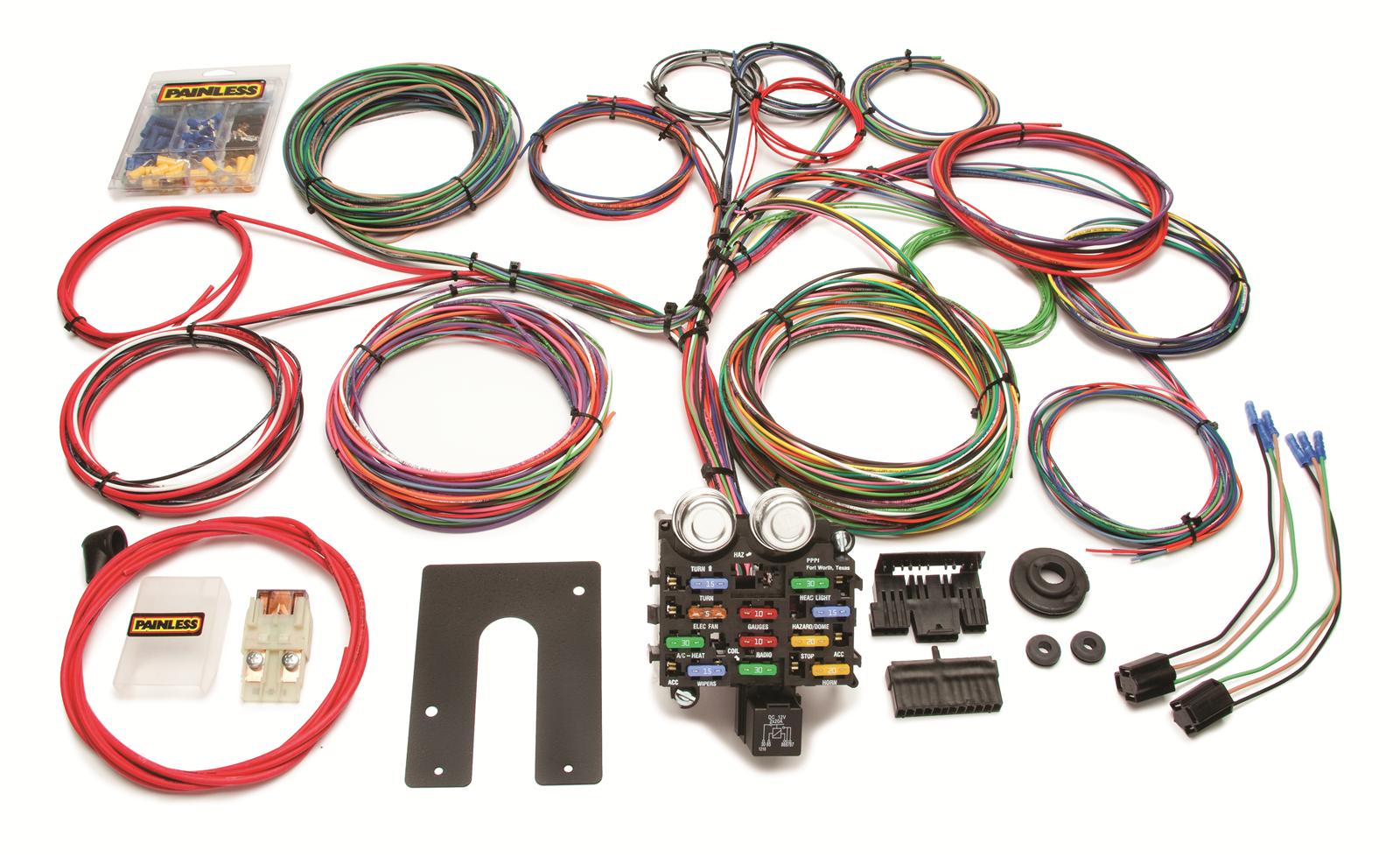

After having a small short/fire in the harness on my f- model it got me thinking I should replace the harness just to be safe.
My question is has anyone ever used a Painless performance universal harness with say 20+ circuits on it and adapted it to a Mack?
http://www.summitracing.com/parts/prf-10104/overview/
This would net me two things not fearing leaving the batteries hooked up at night and all modern relays and fuses. I can't see any reason why it wouldn't work but maybe I am over looking something.

I put a repro wiring harness in my B model which wasn't too bad just a little tedious. The repro's are a lot more expensive. I was lucky the harness I had came with the truck. The only difference I see in the Painless harness is it appears to use fuses as opposed to circuit breakers which I'm not sure of the advantages of one vs the other. The only other thing to check would be the gauge of the wires to handle additional lighting, etc.
I have a Painless switch panel in my race car. Nice piece, been there near 20 yrs.
I am in the process of putting an "EZ Wiring" kit in a 41 Willys. I think they are all pretty comparable overall.
http://ezwiring.com/
The one thing I did on the Willys, I put the headlights on relays. Takes all the load off the dash switch(generic GM switch). With the halogen bulbs today, these old headlights switches don't like the amp draw. The rest of it is pretty generic and can't see any kind of problem using it.
I put my B model headlights on relays a few years ago. I couldn't run my bright lights for more then a few minutes before it would start flashing on/off. Now they work great.
As for the Fuse/ Breaker comparison. Just keep some fuses in the glovebox. I'm sure they put breakers just to make them resettable and not have to worry about replacing fuses. If you do it right, I don't see a problem with fuses.

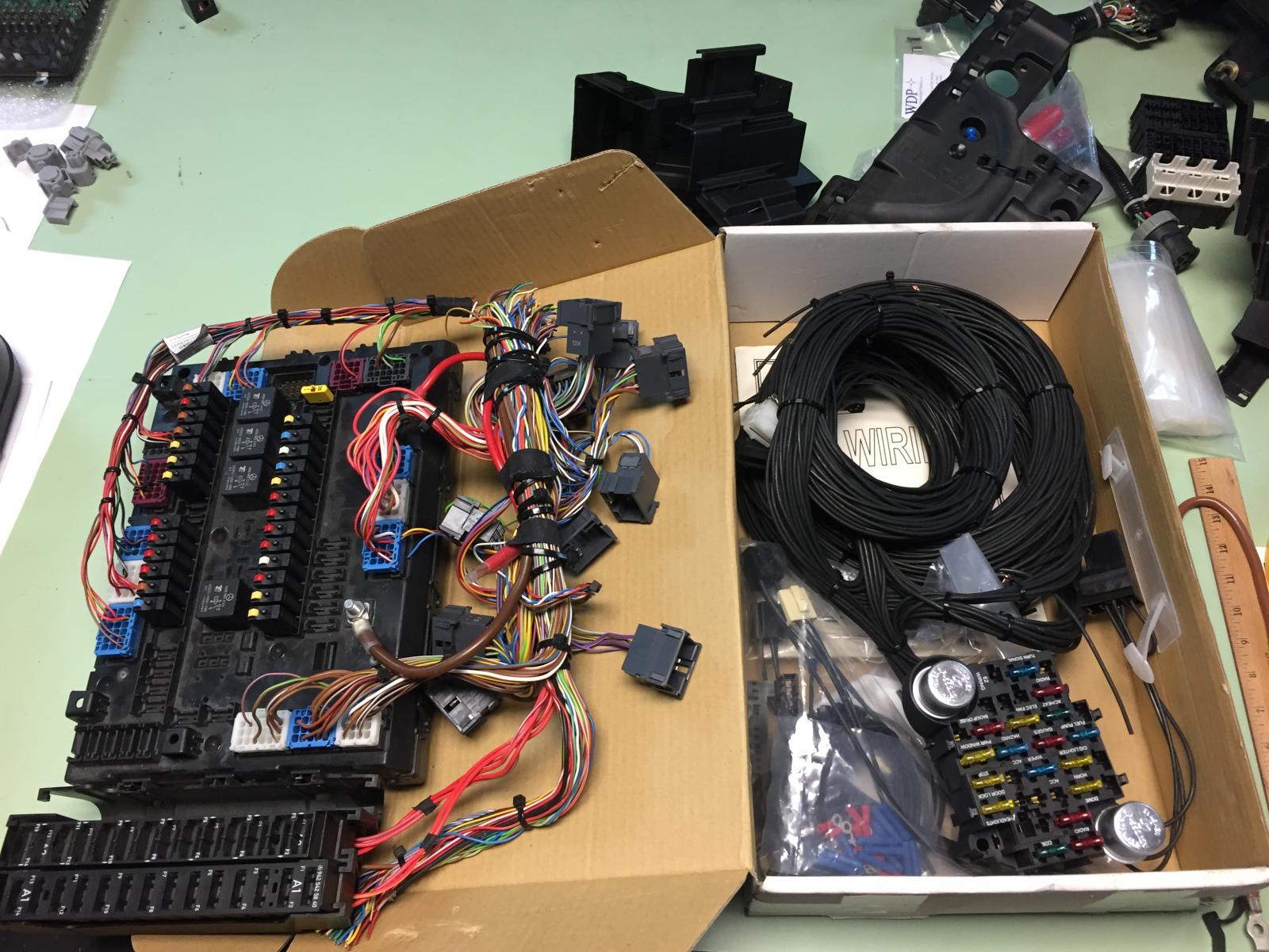

One reason I like old trucks vs new.
Mercedes semi truck fuse box on the left (one of many in the truck)...... my new harness and fuse box for my Mack on the right.
Yes I ordered the all black harness from E-Z Wiring as I think it will look cleaner installed. It is screen print labeled every 6 inches so identifying wires is simple. I said to myself for under $200 why mess with old questionable wiring.
