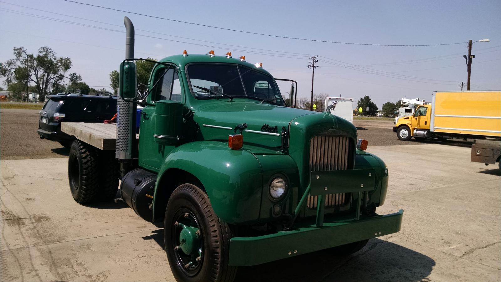

Hi All,
I am very new to the Mack world and somewhat of a diesel novice as well. Other than all of that, I am fairly mechanically inclined.
Recently purchased a 59 Mack B61T that has been restored. First wondering if anyone recognizes this beast and can provide some history on the refurbishment?
Secondly, I really want to make it a driver; roadworthy and dependable. To do this, I am thinking about changing out the engine and transmission to something more modern with good parts and service availability. Any suggestions for engines and transmissions?
Thanks in advance. I am sure to have a hundred other questions as I move forward with this project.

that truck was for sale in upstate Ny last year. Lake George or Glens Falls I think, then it ended up out west or maybe was still in Ny and sold by a broker out west?
I actually bought the truck from a vintage auto dealer in Denver, Colorado.

Okay, that sounds good about keeping the factory drive train. I want to comfortably cruise at 65 to 70 MPH. I have a metal lathe and can do the drive shaft work.
Can you direct me to some specifics of changing to a triplex or quad box?
