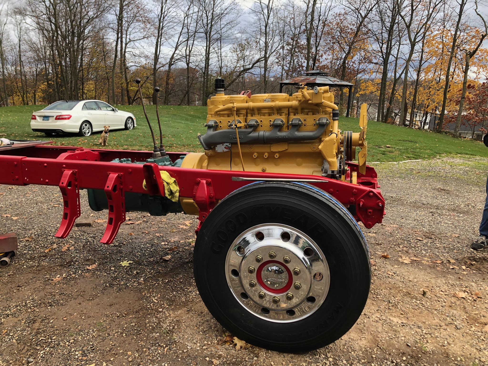

18 minutes ago, theakerstwo said:

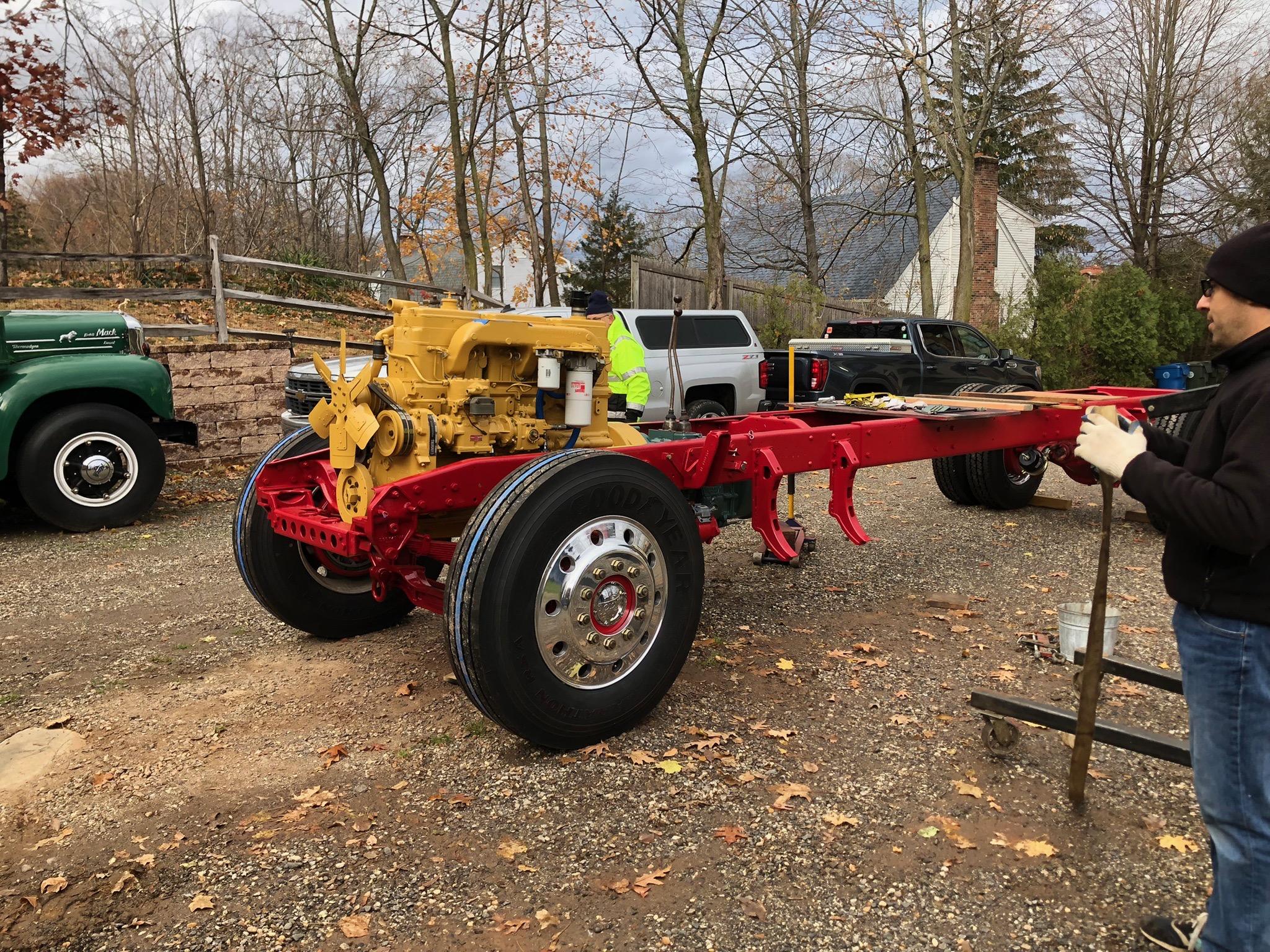

I should say that is thee correct color for a 220.The later 250 and 335 was beige
I think it’s pretty close. It’s Bill Hirsch engine enamel in “Equipment Yellow”. I like the paint for its durability and longevity and have used it on numerous engines. There were some spots on the engine with some paint that seemed original that I painted some test spots on. It was a decent match to those spots. It certainly looks better than what it was.
20 minutes ago, Licensed to kill said:
Actually, you should say "the original colour". The "correct" colour for an individuals engine is the colour THEY like and choose. I painted my E6 the "correct" colour for MY project, Model A Ford green.
Wow, nice detail work!!
20 hours ago, mowerman said:
i expect your going to a negative ground with auto alternater....i thought you hadda late model cat there at first....great progress and ten four on the weather....im on vacation this week i have been hoping for the same thing,,here....bob
Yeah, that was the plan. It’s tough to find an alternator to fit that area. The oil cooler is above it and the water inlet pipe runs down beside it. Generators are narrower in general. This is a 100 amp AC Delco unit, which should supply enough juice to run everything.

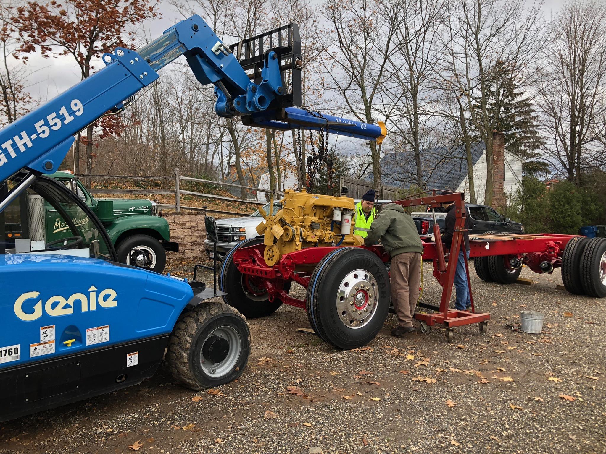

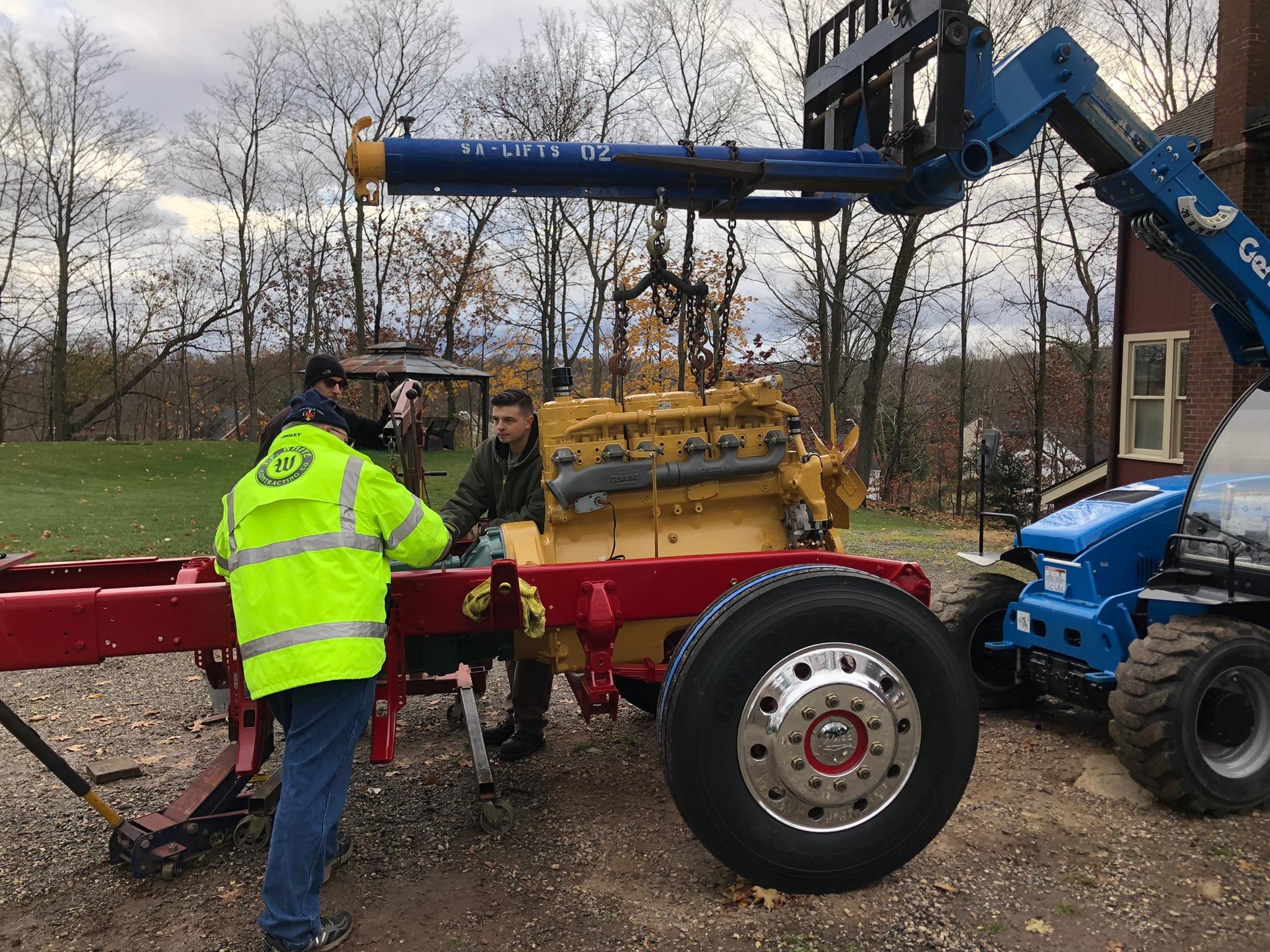

Right on man another step towards mankind  lol probably picked a great weekend end your helping hands were probably all around anyway.. great progress… I did start my DM and let it run 15 minutes or so yesterday .. bob
5 minutes ago, mowerman said:
I expect that engine was in good running condition I don’t recall you mentioning anything about It  except it came out of something else… bob
I heard it run before I bought it. It was supposed to be a low mile in frame overhaul and from the markings on it it appears to be. That was about 20 years ago. I pickled it and drained it a while ago and turn it over now and again. I'll have to prime the oil system as all the external lines have been replaced before I try to run it. I was going to do the cab at the same time, but I'll wait and do all the plumbing and electrical work that I can when the weather permits. Also need to get the driveshaft done. But, plenty inside the barn to do this winter to get ready for the final push this spring.

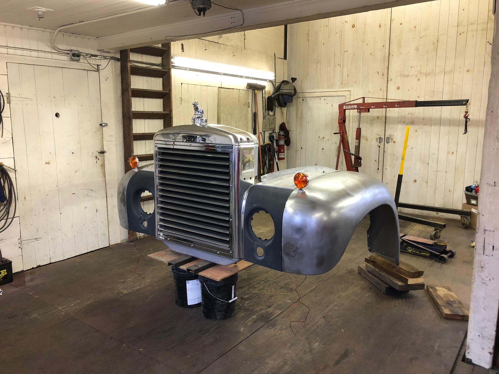

Thanks. All for nothing really since as soon as I stick it down between the fender of my B61 you won't be able to see much of it. No matter, It's just my OCD at work I suppose. Its why I even changed all the oil pan bolts to yellow zinc grade 8's because they look better as if anyone will see them. I guess it is like when I was a kid with my '57 chevy and put new chrome jug nuts under the baby moon hub caps because "I knew they we there".

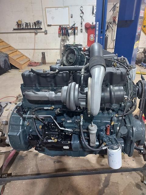

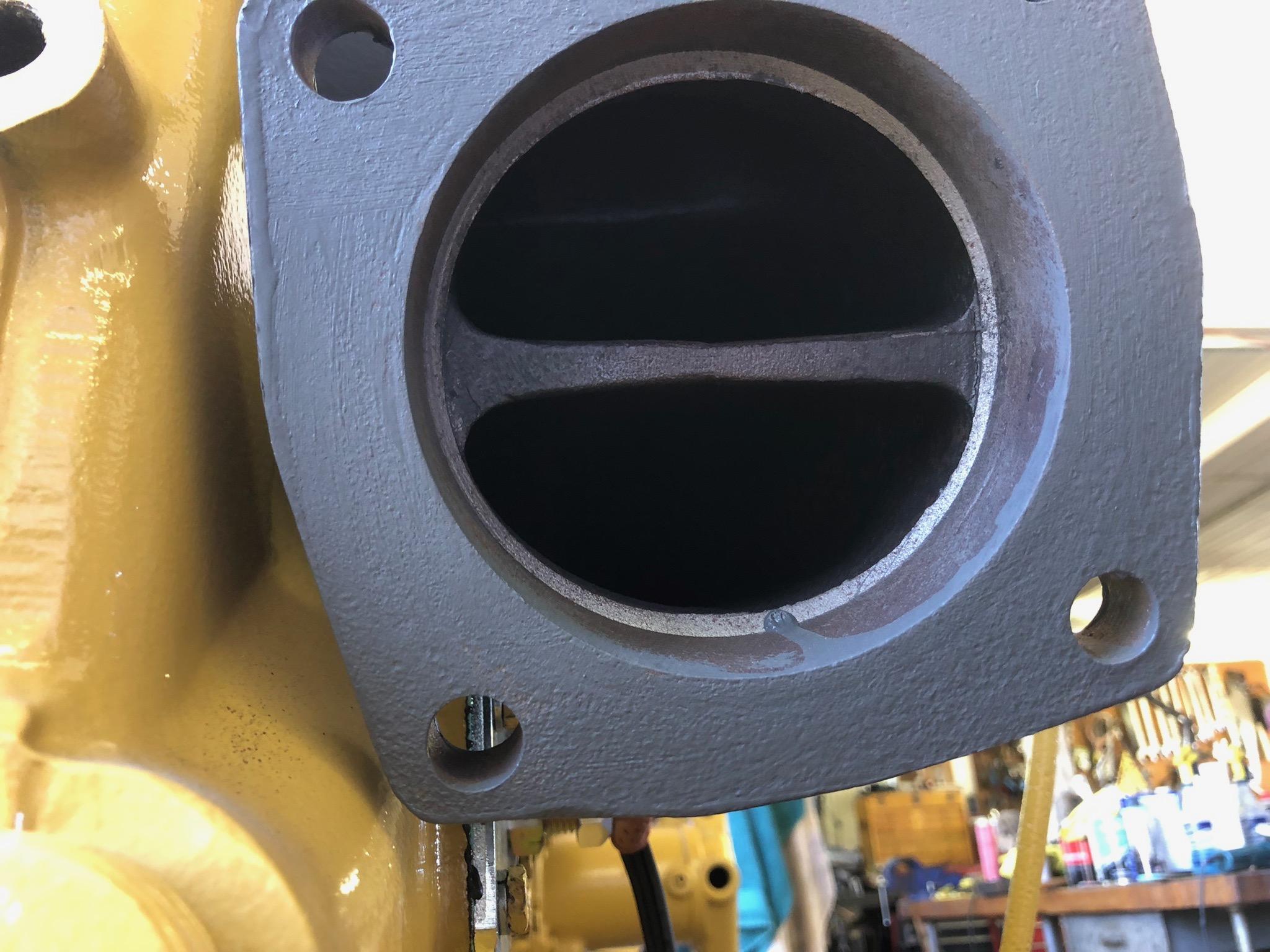

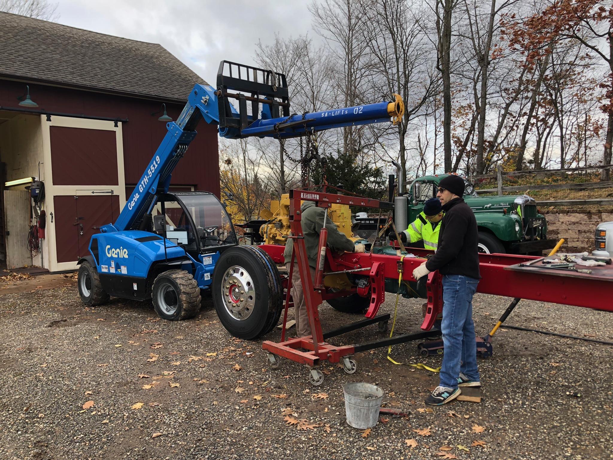

The magic baffle/divider within the rear half of a NH220 backdrop. I finally got a picture of it when I pulled the engine out of it's hiding spot. It's my understanding that the same manifold without the baffle/divider was meant for the 855 CI, 250 HP version.

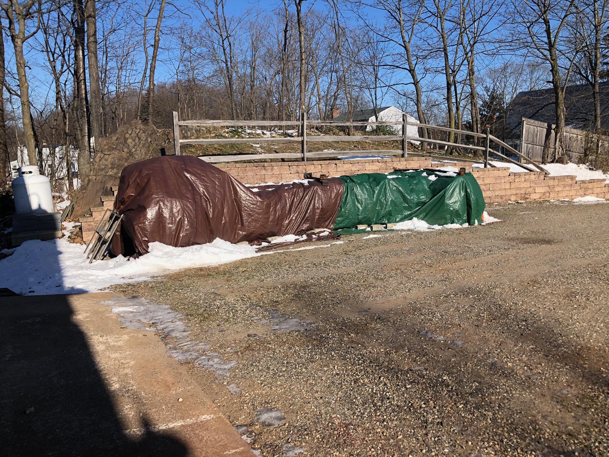

How long until it warms up again ? 10 weeks  ? I have no idea, I  was expecting white stuff to be everywhere in the photo
Anyway the time will pass soon enough and you'll back it before you know it
