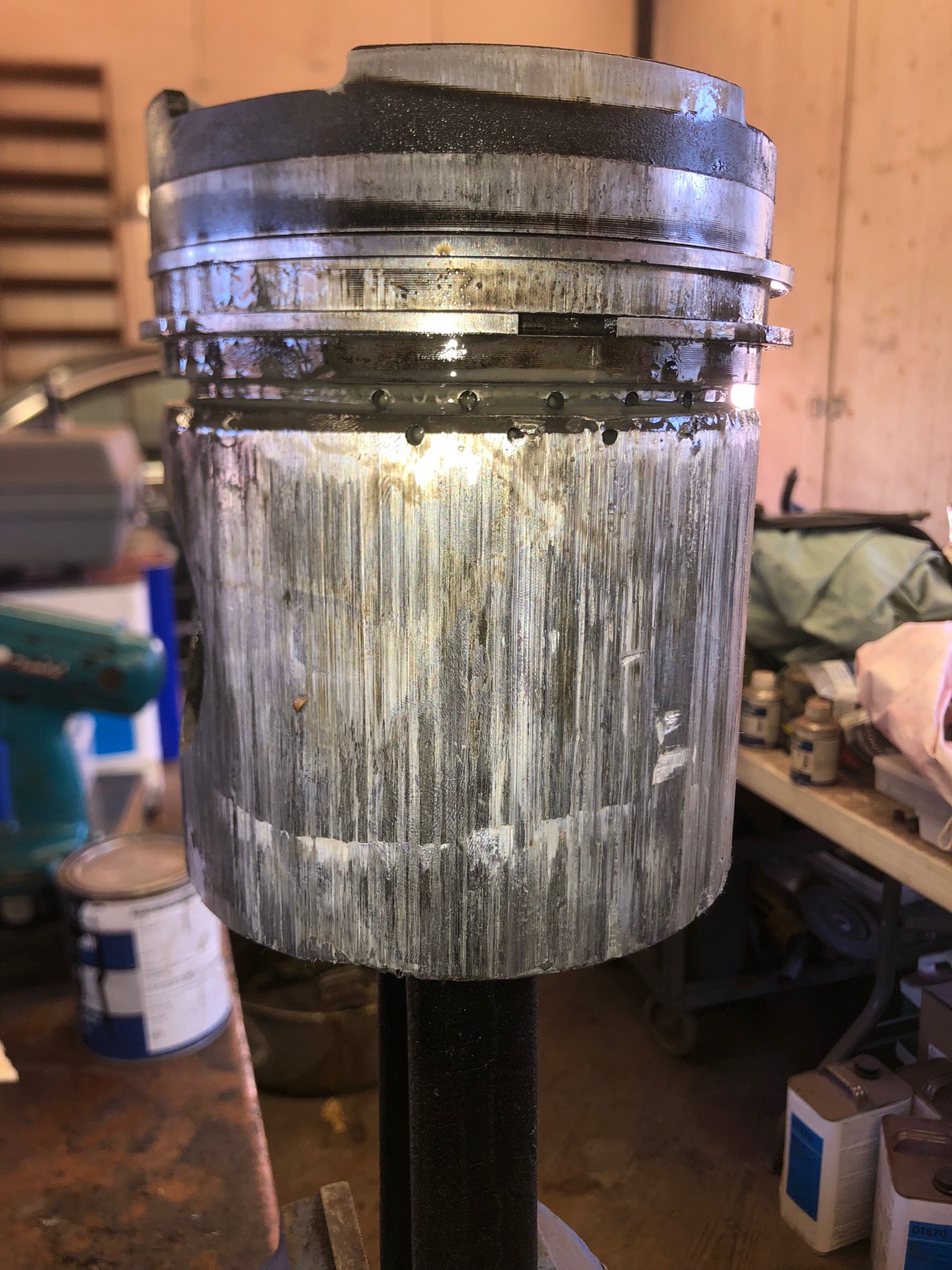

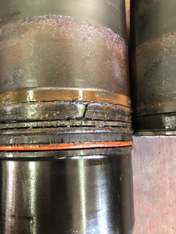

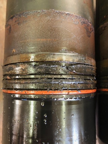

What breaks those liners at the seal grooves is the pistons have scored to the liners.I have seen it hunreds of times.When it is built back make sure and have the rods checked for being strait.The engine has been very hot at some time and run under load to do this.Be carefull with the fuel lines to the injectors because they were hard to find 20 years ago.

It was running great and sounded amazing on the road. Really good oil pressures and temps...until it failed. I think time was my biggest enemy. I was told it was a fairly fresh rebuilt when I bought it, but then it sat 20+ plus years in my shop before I had it running. Even if there was only a little corrosion on the liners it doesn't take much moisture to keep it going, just even a little bit. I pickled it, but I didn't fill the water jacket with anything. Maybe if I had filled and drained the water jacket with oil just in case. Tear down will show it there any corrosion in there.

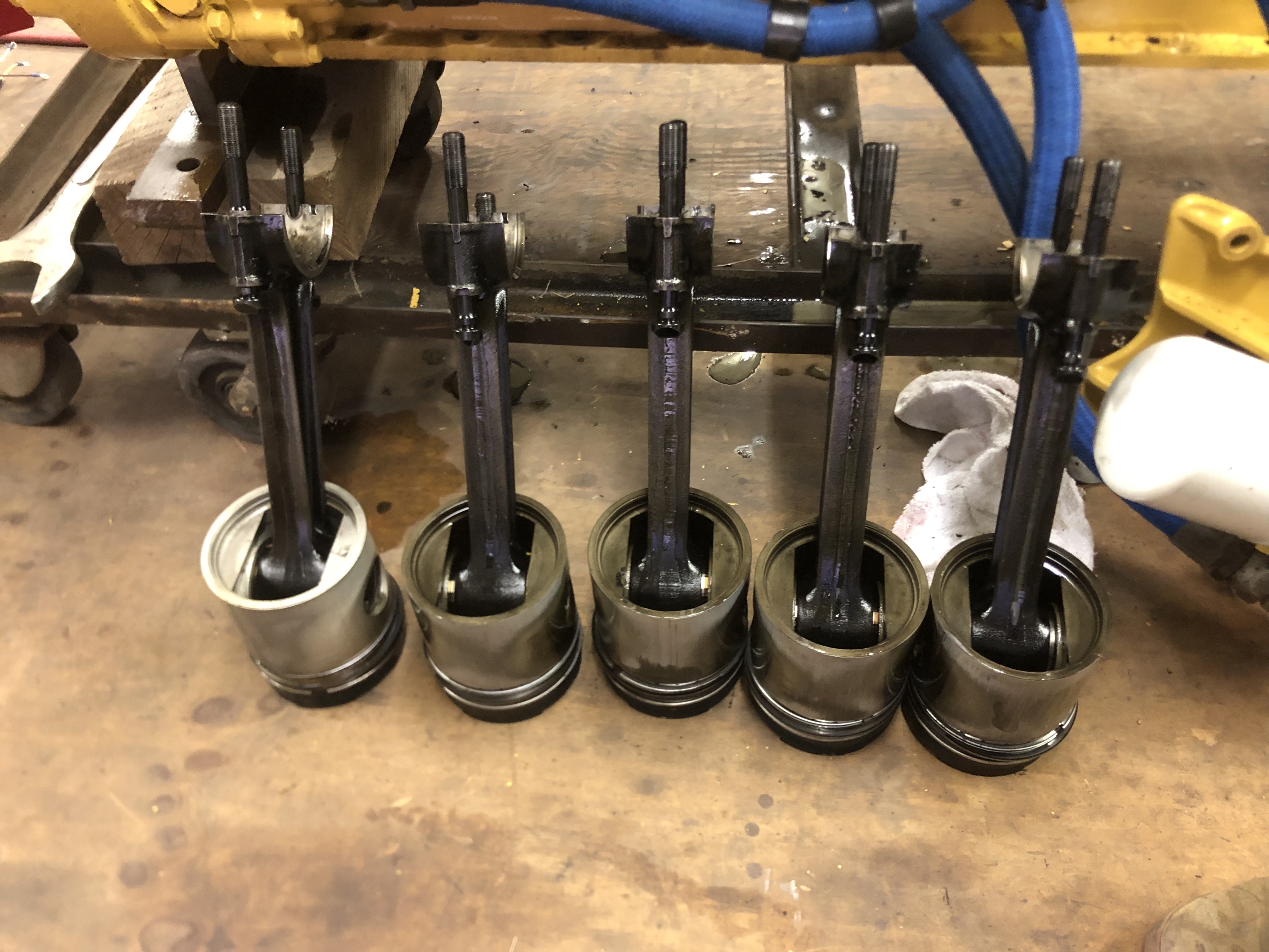

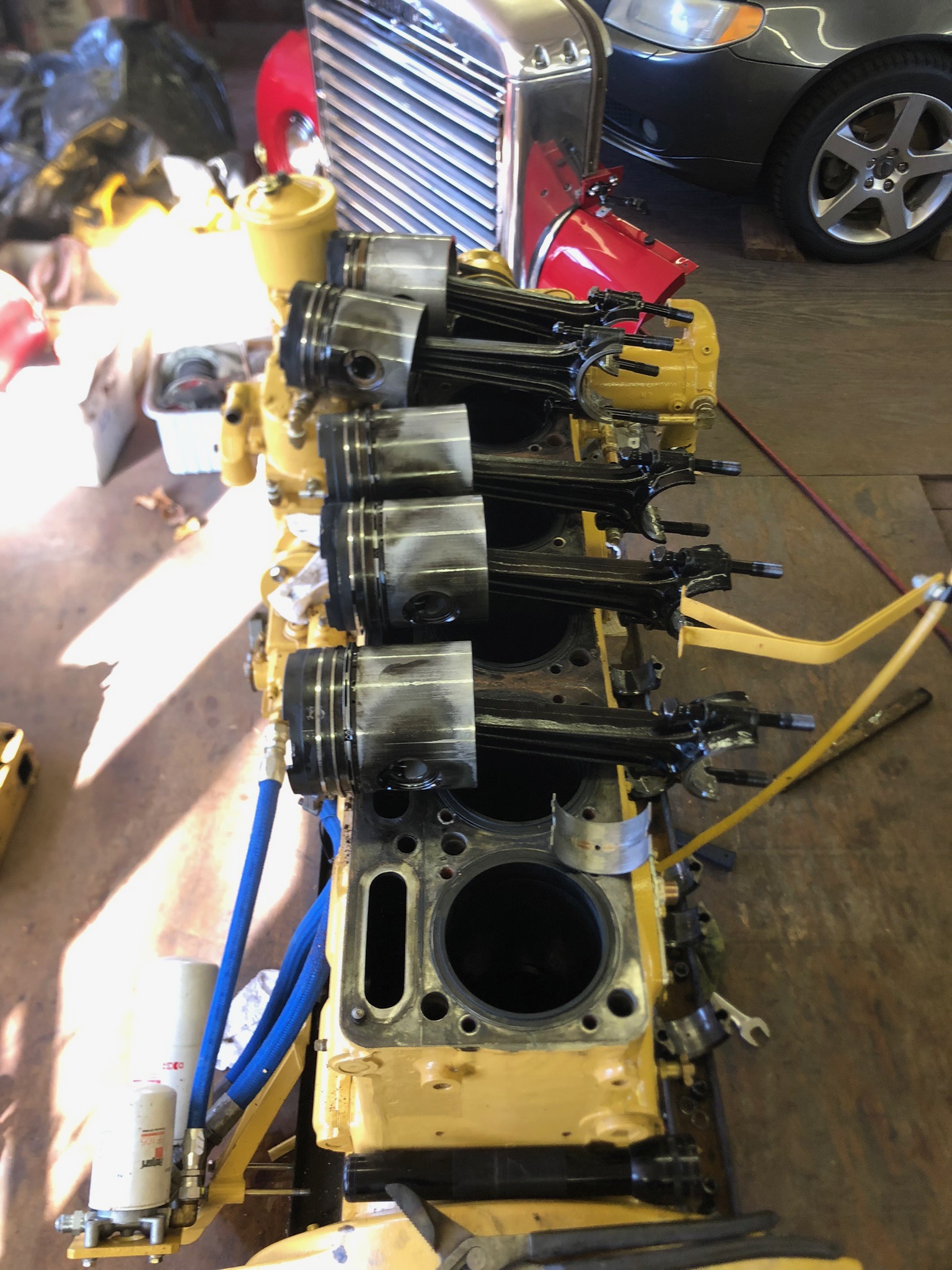

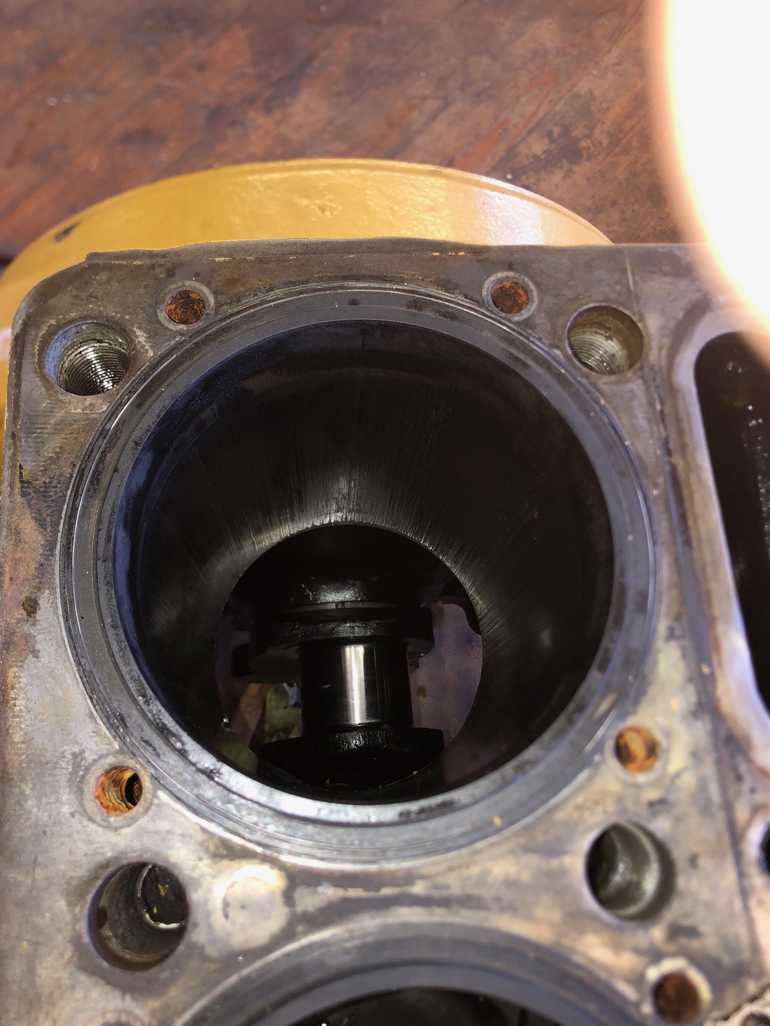

Yeah, I’m in agreement with Glenn, too. I did have wet fuel on top of 3 piston heads, 6 being one of them when the heads came off. I barely ran it when I turned it around in the driveway. Everything was covered in oil as it came apart. I’m hoping to see some other kind of evidence to the cause when the sleeves come out. #1 piston looks brand new with almost no wear seen on it.

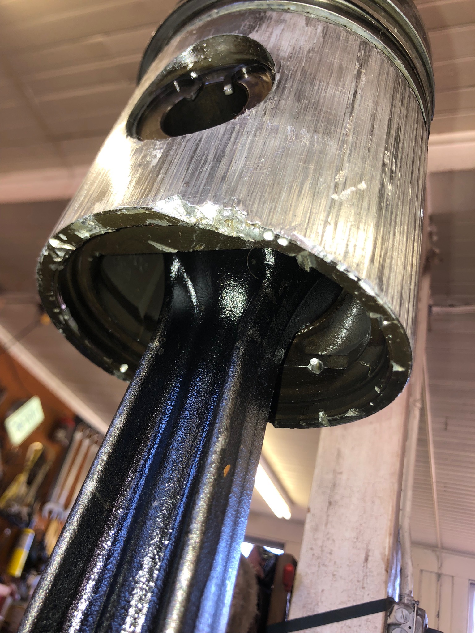

I had a driver call me years ago, 230 Cummins, said it ran hot,, and was knocking,, shut it off and it wouldn’t start back ( locked up) I drove about 30 minutes to him ,, it started up when it cooled , no knock, sounded ok , drove it back to shop and pulled the pan and you could see liner scoring on one cylinder, probably would have did what yours did if it had ran much more, that liner is not that thick in the o ring groves, It’s hard to tell if it was overheated before you got, I think you got some good advice from the other guys , and good call on your part to go through the injectors  . You won’t have to worry about it when you head out on a long road trip.
Thats good it was contained to only one cyl by the amount of parts you had in the bottom of the pan I thought it would be way worse hope you can find everything you need to get it going again

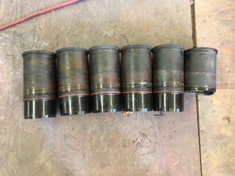

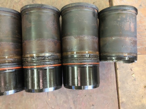

One of theses things is not like the others...... They're out and still no visible damage to the block. We'll see about that as I clean it up and have someone look at it. If I was a betting man, I would say the main cause of the failure was poor workmanship and improper installation of the sleeves. While things were a little crusty on the inside, I found no major pitting on the sleeves. But, #4 & #5 and probably #6(too much is missing to be sure) had lower seals the were damaged, split and broken. What I think happened, was that as I was driving it they began to leak dumping the coolant into the pan. It then began to overheat #6 and score and break the sleeve. The temperature sender is way up in the thermostat housing and not in the block, once it runs dry it's not going to read an overheat internally.

Glenn is right I saw a guy rebuild an international engine and bout a half hour of running seized a piston rip it down fix it nother half hours seized a nother one had to pull them all out and replace all 6 when he installed the seals he rolled them into the groves and didn't take a screwdriver and run it around them to un roll them but those also look in terrible shape
