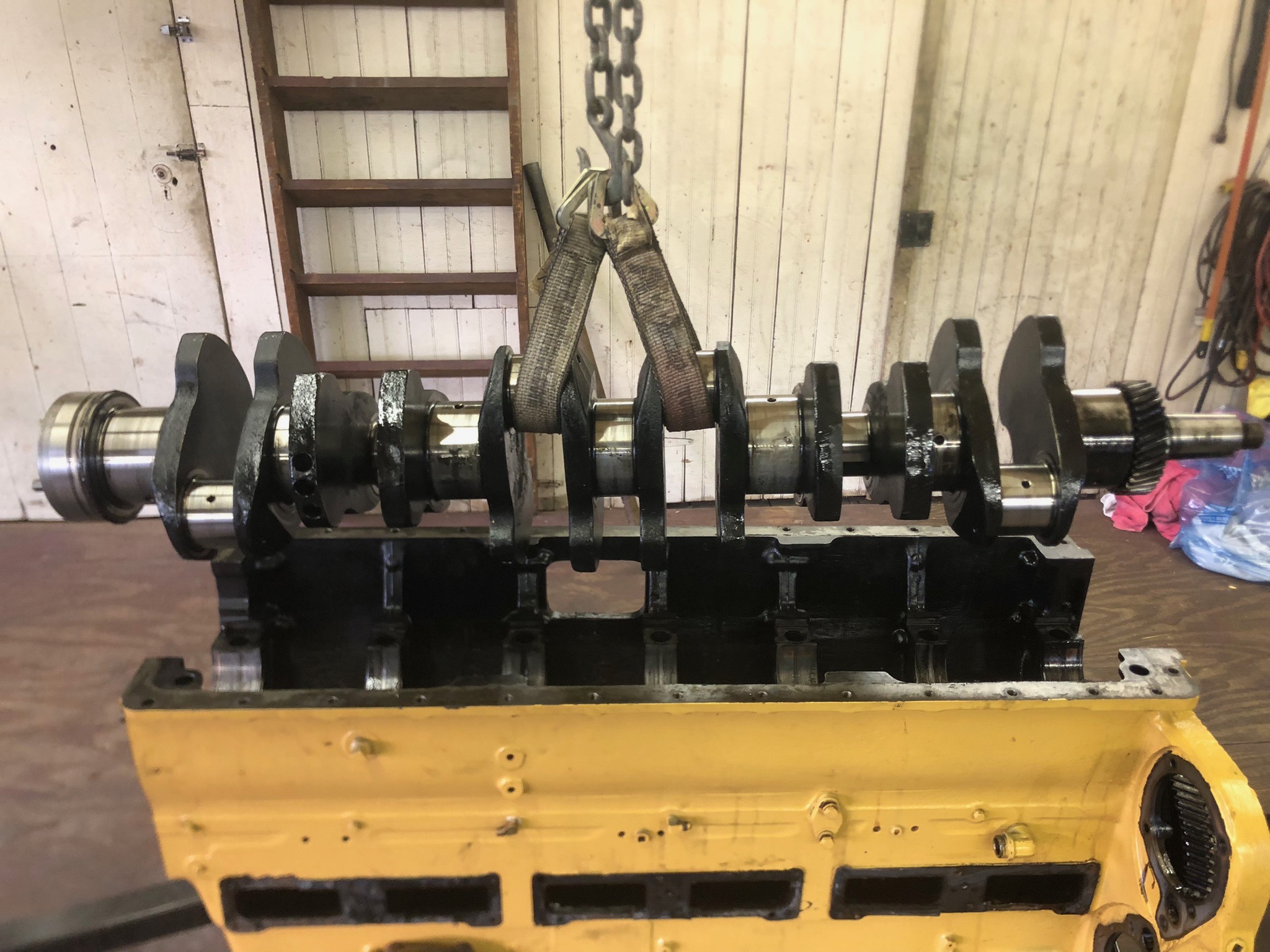

Forgive me...  but.. yes the crank is huge in size, but I didnt see any HUGE issues.  Am I correct?  looks good to me..  I love this thread...   Jojo
Yeah, no major damage or spun bearings. Dodged a big bullet there. The machine shop will go through it and magna-flux everything for cracks after it's hot tanked. Once they figure out if the crank needs to be ground, I can start sourcing what's needed for reassembly.

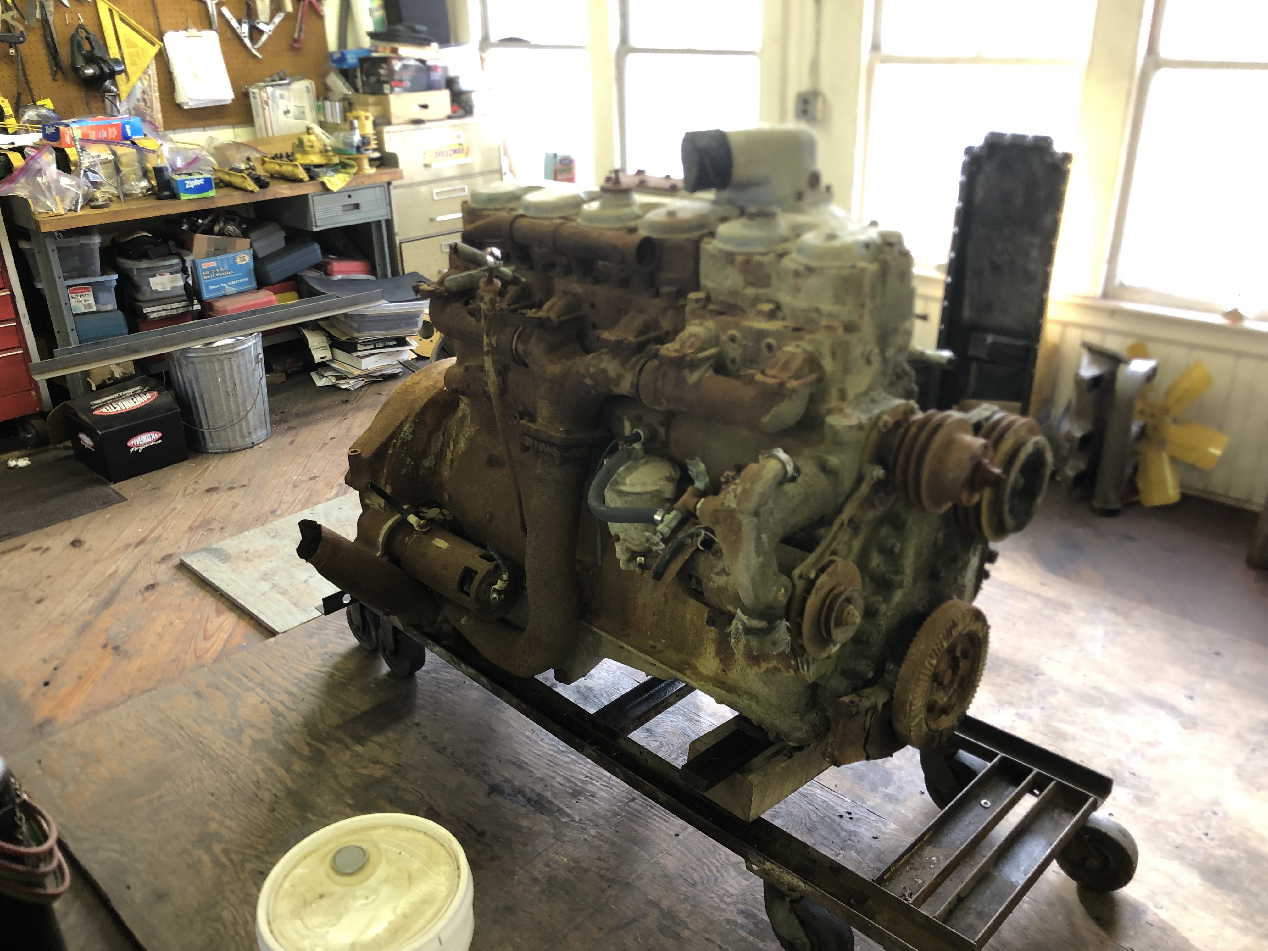

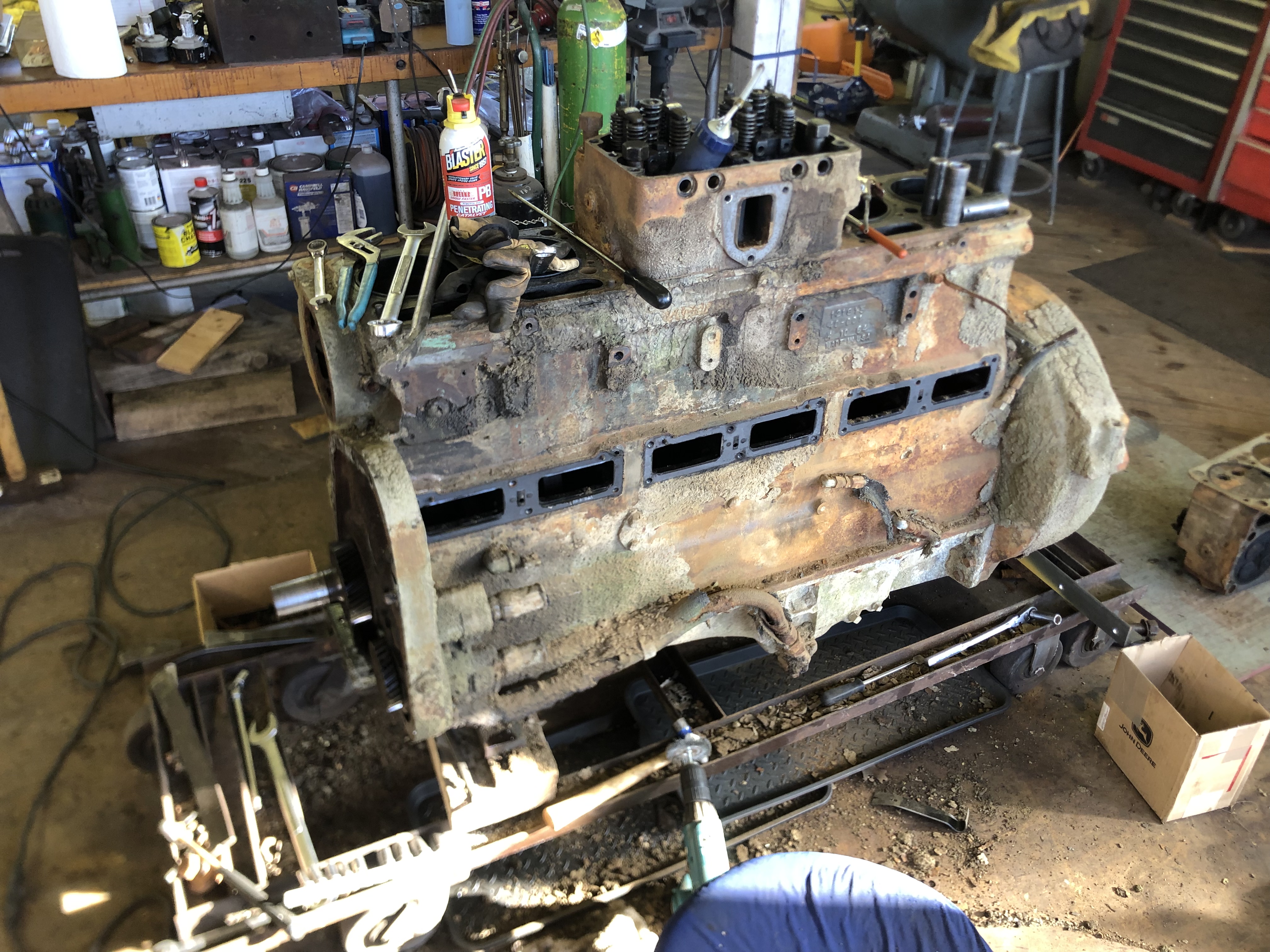

That was quick. Got the engine back from the machine shop. I think it has the right patina to match the truck!! Actually, a “Loaner” clapped out 220 a friend loaned me so I can rob parts off to fix mine. A bunch of internal parts need to be replaced on mine that we found on tear down.

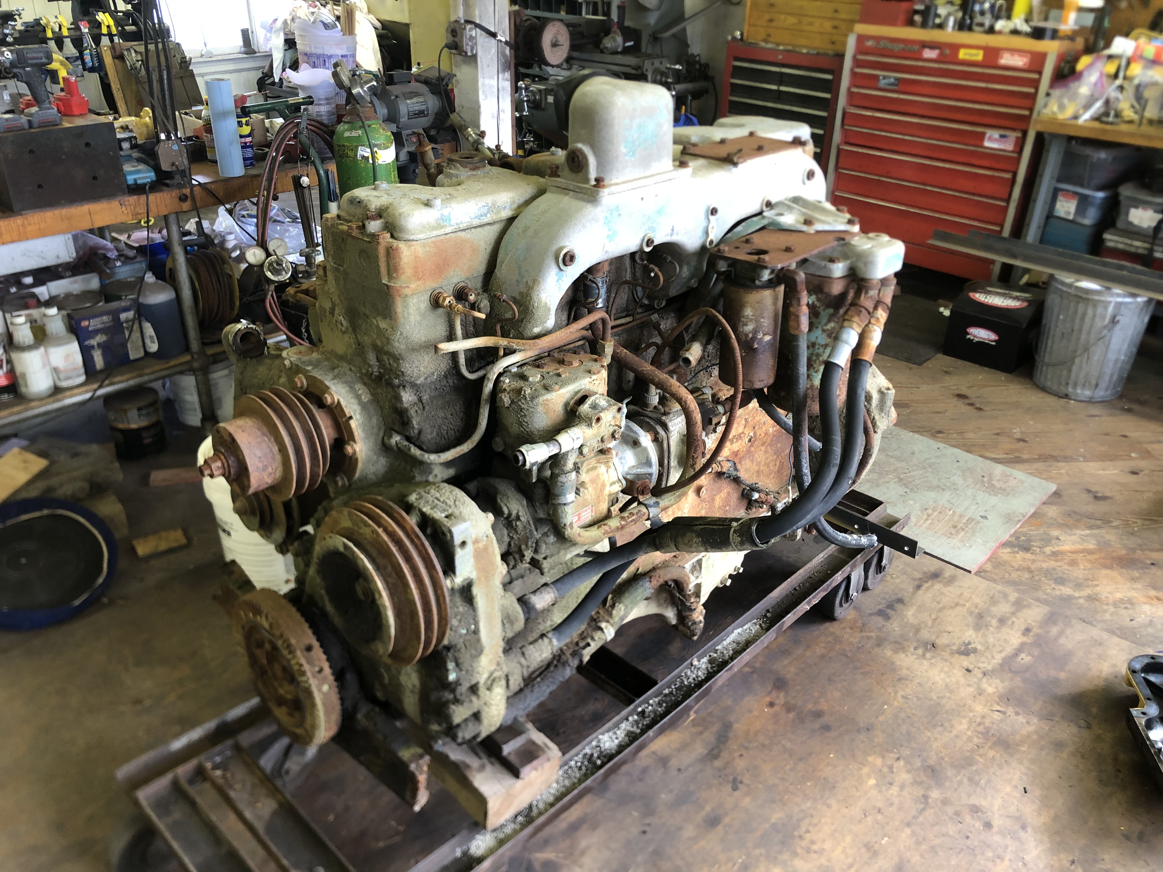

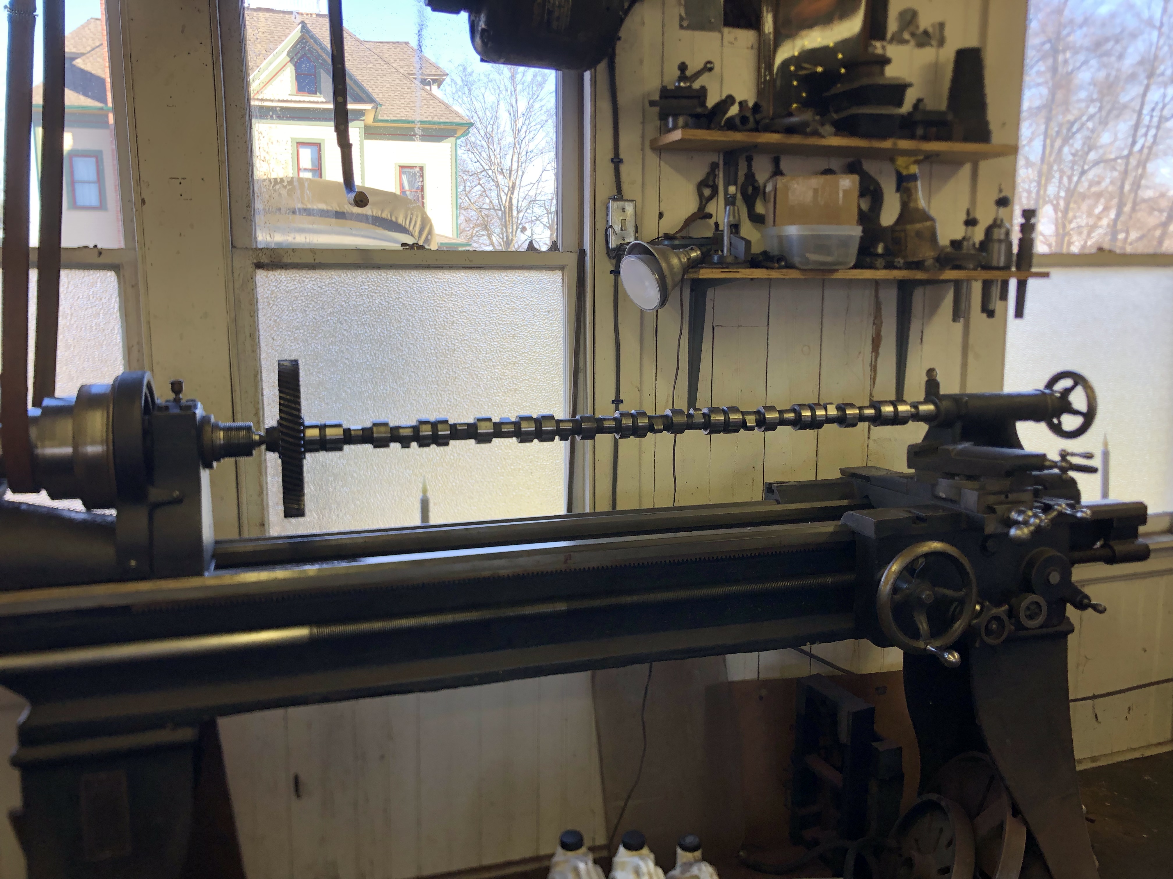

Gutting this 220 out. Removed the important camshaft today. Quite the effort to get to it. Threw it on my lathe to spin it by hand and clean it. Pushrods are all serviceable, saving about $800+ for new ones. Getting to the connecting rods tomorrow. As crusty and gummed up as this block is, it seems in better shape than the one I have. The deck is really clean and it is newer, 1964 vs 1959. So it could become a runner if mine proves bad or uneconomical to rebuild.

Tell us about that lathe!!!  Looks like there is some history there😎

I'm curious what powered that when it was closer to new. I've seen pictures of facilities with overhead shafts powering several things it looked like ?   106 years old....wow
I've wondered that too, thinking of that time period. Could've been steam, gas, water or electric. I was in a mill once up near Cooperstown, NY. It was a wood shop that was powered by a 20' wide water wheel. When they opened the sluice gates, the waterwheel would fill and start to turn. The whole mill was set up with line shafts and flat belts. You'd pull individual levers near each machine to activate them. Once the water wheel came up to speed the whole building came alive. it was really amazing to witness.
It amazes me some of the things they had back then. I've often wondered how they ever made the first ones. ( like how would you true something without a lathe)   can you picture Louis Clark make'n something for an Autocar with that technology.   Thanks for posting.
They ran those off overhead line shafts. Big flat belt from the shaft to the lathe. To reverse it, you’d twist the belt. Have run many of these converted to electric motor.
