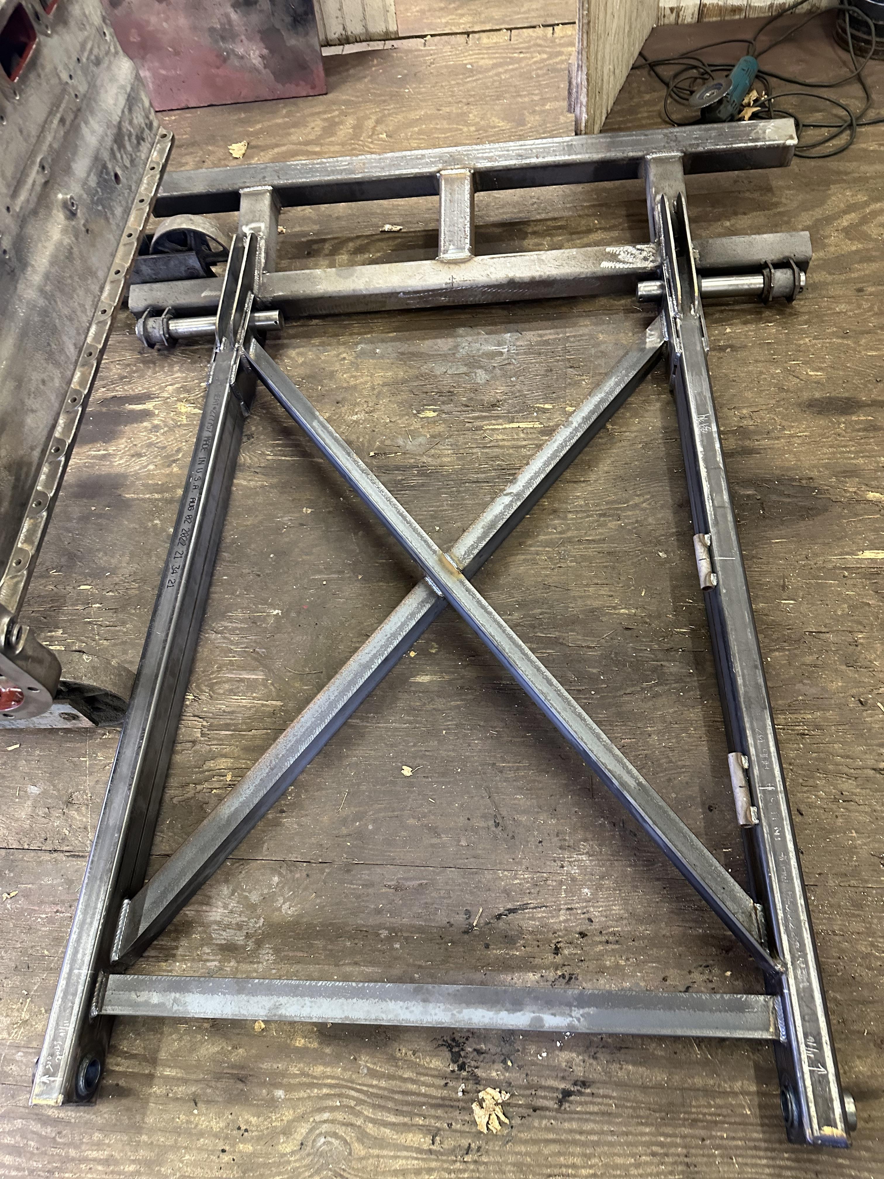

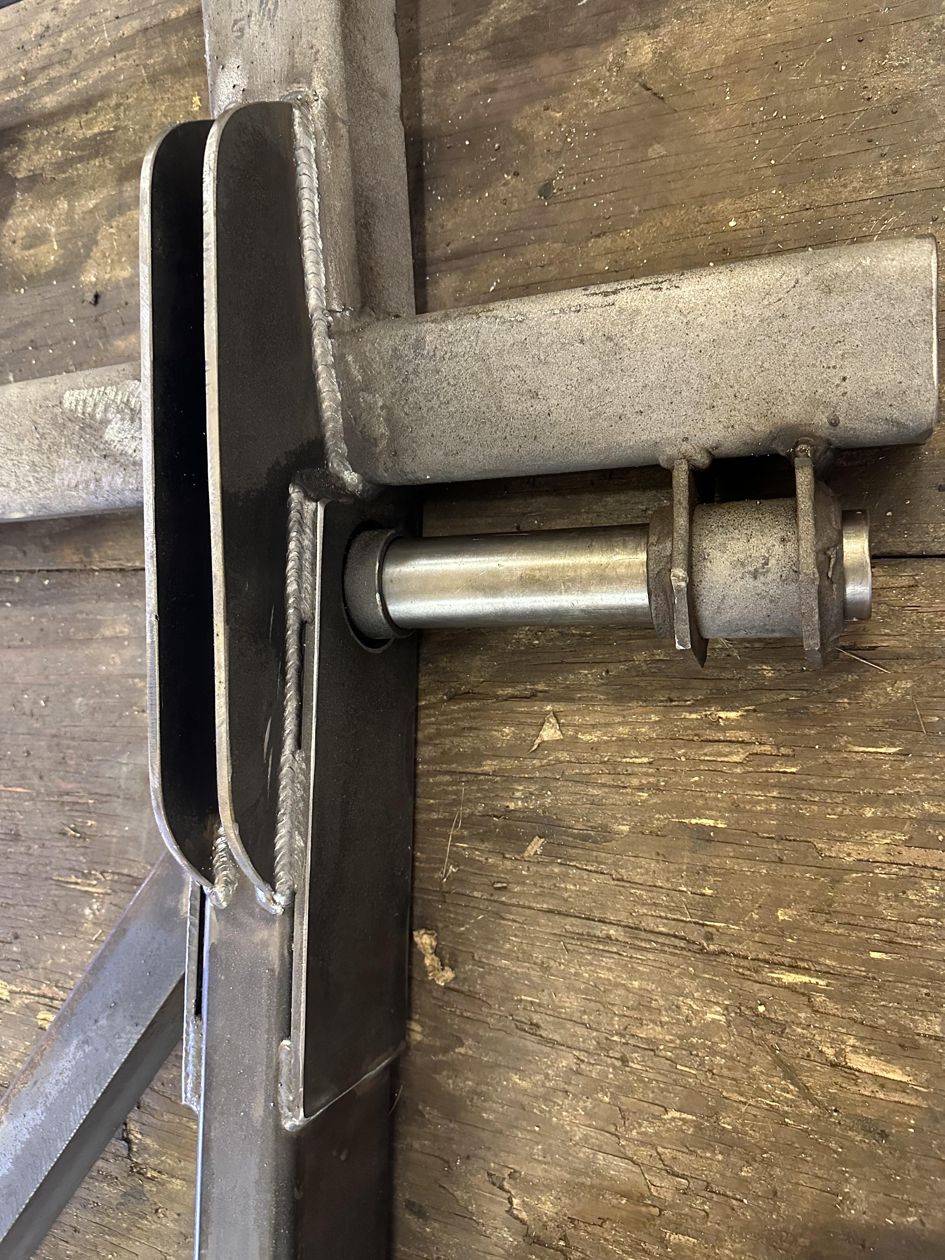

P.S. The weld seams are a cat's meau as one of our members used to say:)

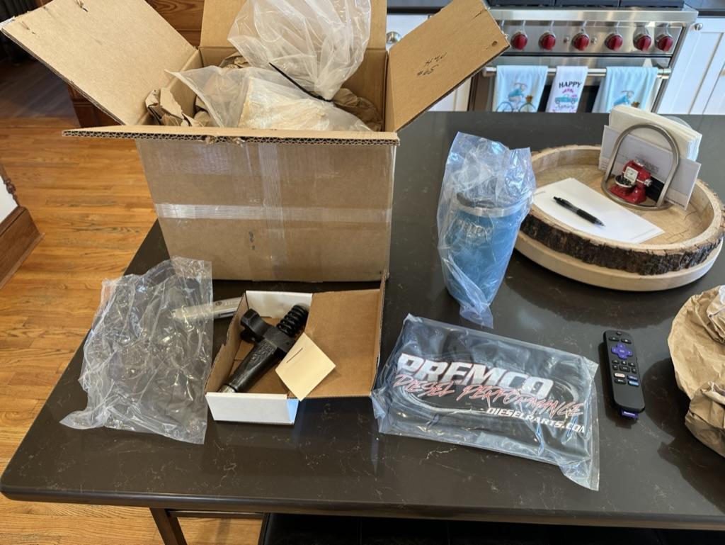

Another issue was sending out the injectors and fuel pump for testing and overhaul. Started off with Metro Fuel Injection, they're located in Essex, CT and Agawam, MA and have several other shops in New England. At first they said they could do them, but after three weeks said they no longer had the capability to do NH220 injectors or pumps. More research and I located Premco Diesel Performance in Lampasas, TX. Found them on Facebook, on the Cummins Old Gold page. Spoke to the owner, Warren, who was very helpful. He said send them as he does the old flange type injectors himself. He called Monday to tell me what he found, all kinds of mismatched parts in the injectors, wrong spray pattern nozzles and the pump needed work and he gave it a few needed updates. They're done, payed for and enroute back to me, now. So, another item checked off the To Do list.
