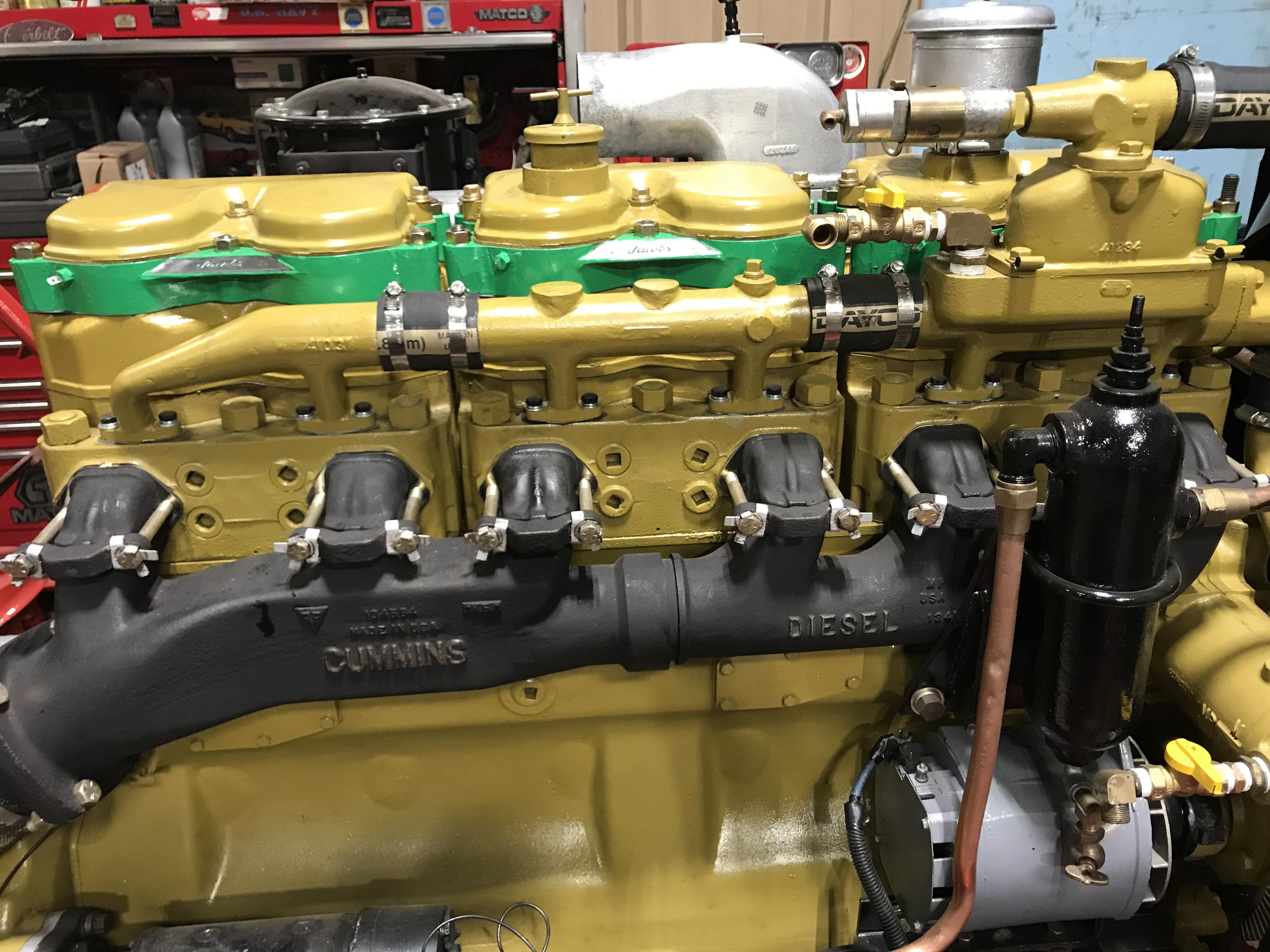

I didn't repaint everything. I wasn't able to get any of the "Heavy Equipment Yellow", which was very close to the factory engine color. So, I ended up using Cat Yellow on the main assembly. Some of the accessories are that more pale yellow. After some use it'll all blend anyway.

Not yet. Still lots to hook up. I did finish the oil system today and fill the crankcase with over 8+ gallons of oil. Later, I cranked the engine on the starter, no fuel, and was able to build 40 PSI on the gauge. Fixed a clutch linkage issue, somehow installed a bell crank backwards giving a very stiff pedal. Much easier now!  Had to dodge rain showers all afternoon and finally called it quits about 4:30 due to that. Stuck the hood on to give the engine some cover.

Yeah, it’s not too far off. This color is Cat Yellow. The fluorescent lighting changes the color a lot. When I shot it the first time I thought I was way off on the color. Once it was out in natural light it looked real close. People always ask, shouldn’t it be beige or gold?. Not in this vintage. I think they’re both close enough. I’m not trying to win some concours, I want to drive it and have fun.
